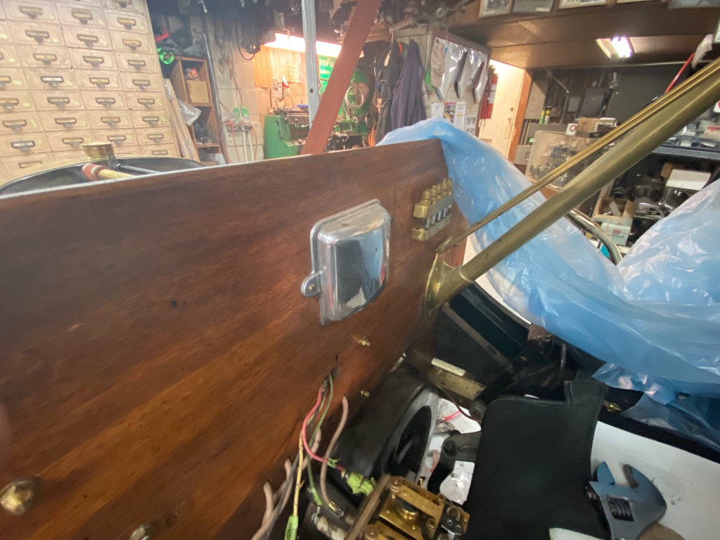

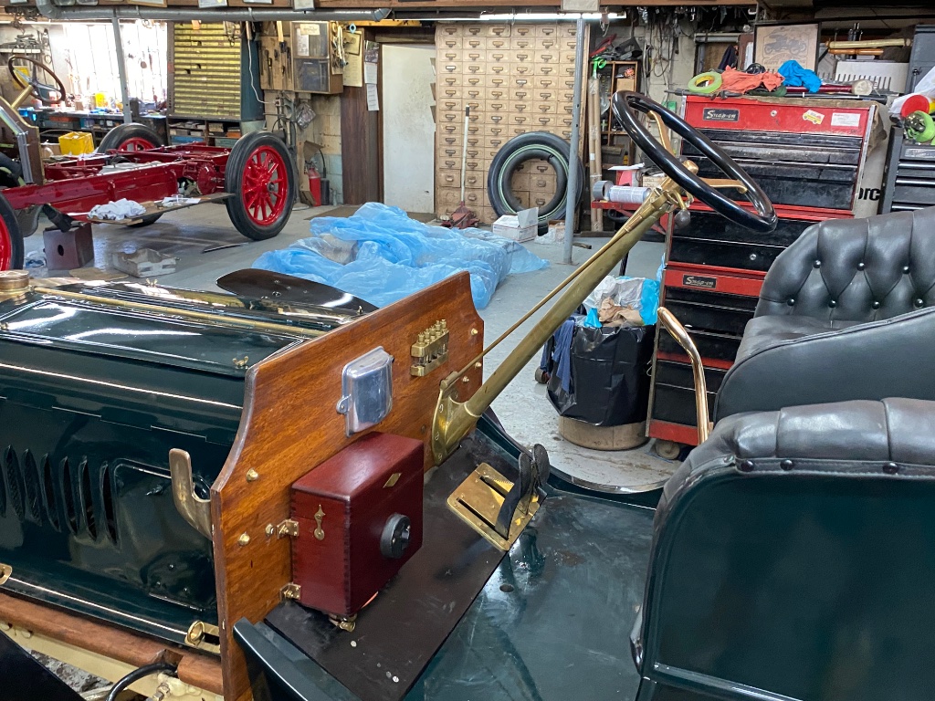

Beautiful car Rob! What is the aluminum looking thing on the dash do?
KimDobbins
- Posts: 1693
- First Name: Kim
- Last Name: Dobbins
Re: New London to New Brighton, here we come (I hope)
That aluminum cover is over the cutout in the dash for the timer. That cover makes it really tight to get a coil box to fit properly on the dash. The top floor board had to be notched to get it all to fit. Hope you and dean can get the front end set up properly. Great to see it on the road!

Below, both sides of the firewall. The timer drive is almost on the firewall, just forward, and the timer protrudes through, and is covered by the aluminum cover, as Kim mentioned. On the prototype car, the timer advance rod was on the back side (driver side) of the firewall:

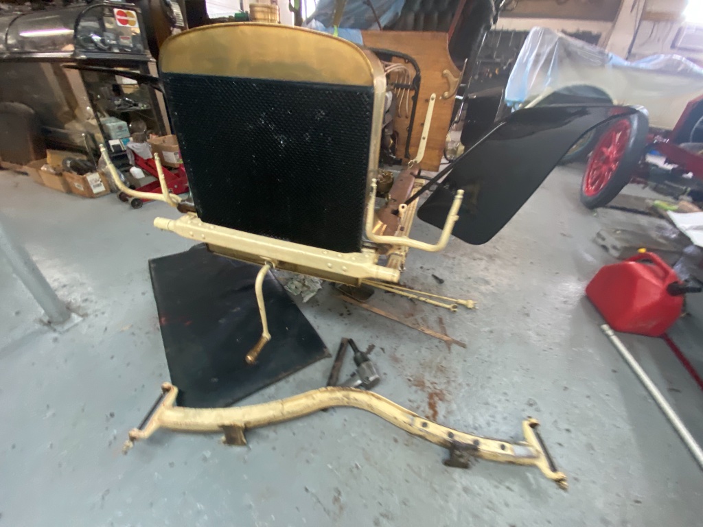

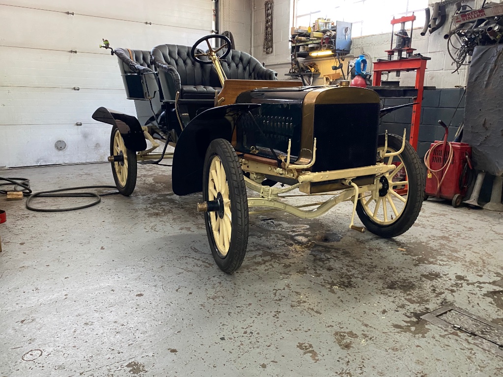

Front end, with the axle ready to go on:

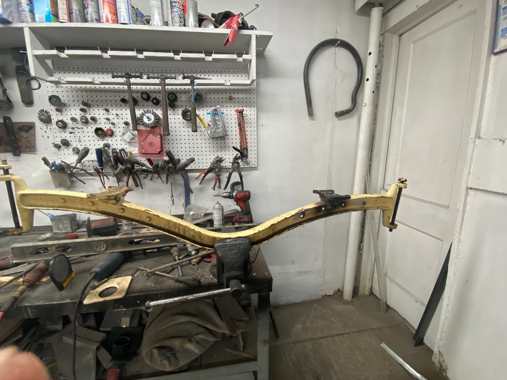

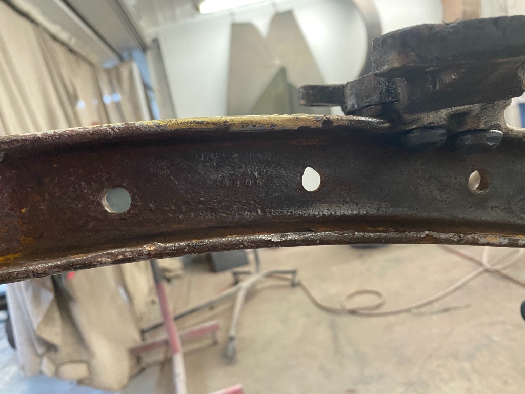

A number on the front axle. Again, the steel is nowhere as strong as a T, evidenced by the nicks and gouges made in the axle over the years. When pulling on the axle in a vise, I think one person would be able to cold bend it, unlike later models. This was the first Ford model with a solid I-beam front axle:
Three of us bent the axle in a vice cold. The steel was obviously not as strong as later K,N,R,S axles, and nothing like a T. Good evidence of the difference Ford's metallurgy work made as Ford models evolved:
