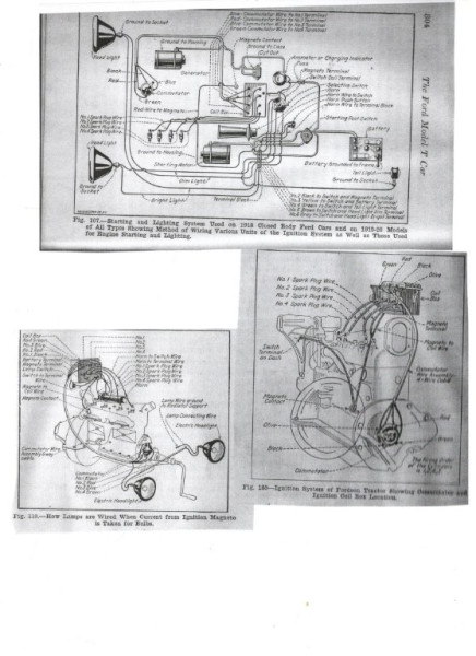

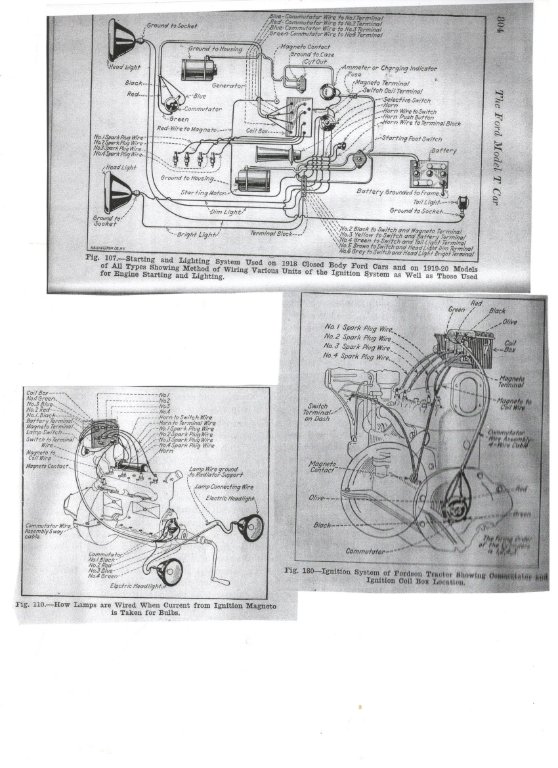

Even with an automobile that has a microchip, including the etimer, if a problem is detected, one starts with the ground. On the Model T, the whole frame is used as a ground.
Attached are pictures worth 3000 words showing the wiring and where the ground (negative terminal is located).

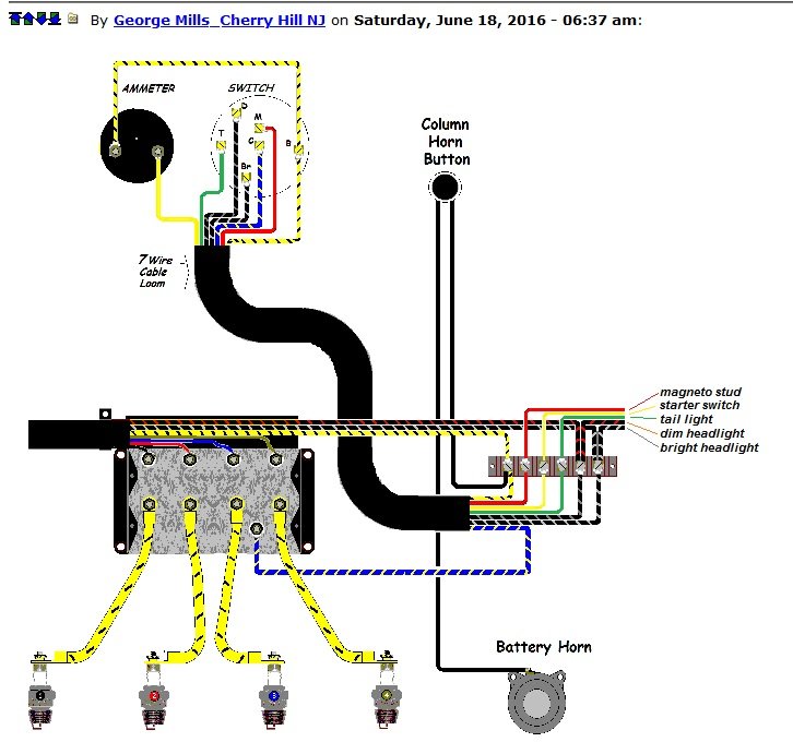

The Model T electrical system has a number of ground points, with several which specifically affect the ignition system.

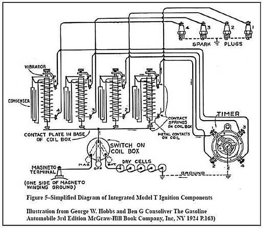

Just to clarify what has already been stated, the metal strip on the bottom of the wooden coil box is an electrical buss. It is connected to the either the magneto or battery by a wire. The coils are grounded by the action of the timer to complete a circuit for the flow of electricity.. . See diagram "contact plate in base of coil box.
