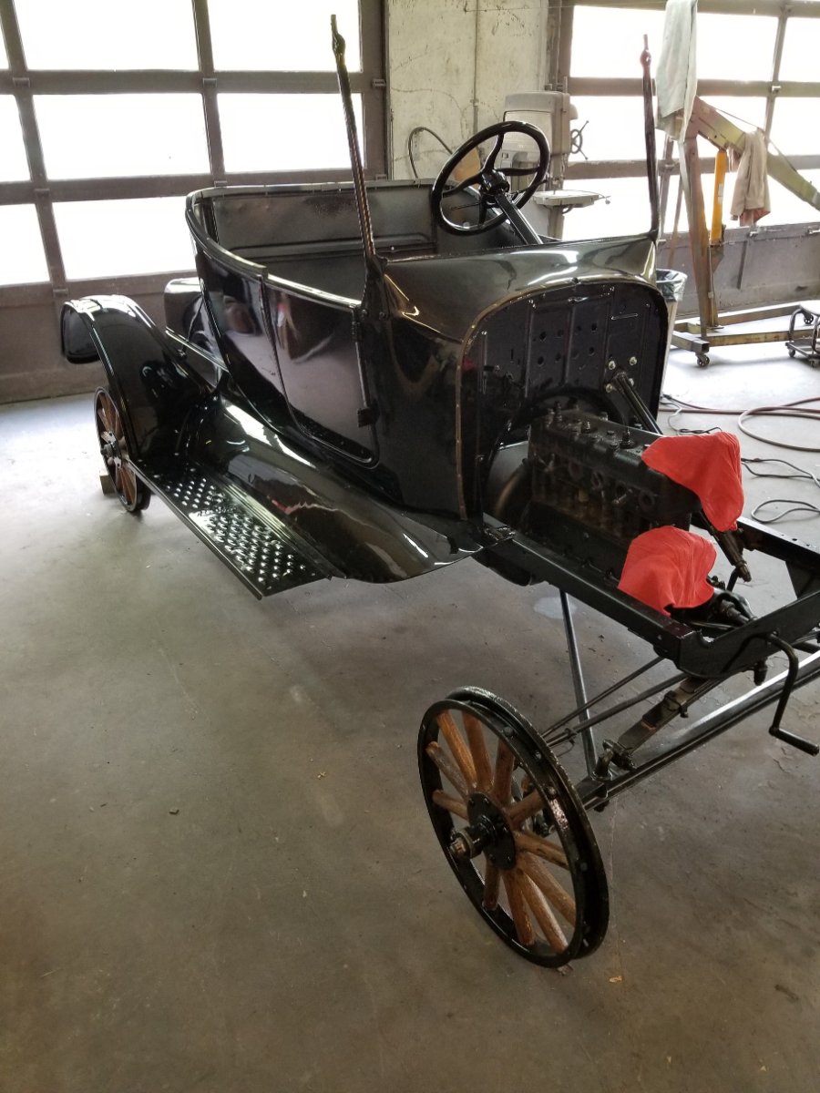

Looks good! I need a set for the kid's car we are building up. I am hoping to find a set at one of the local swap meets this summer.
You are clearly ahead of us, but school and sports keep getting in the way!
