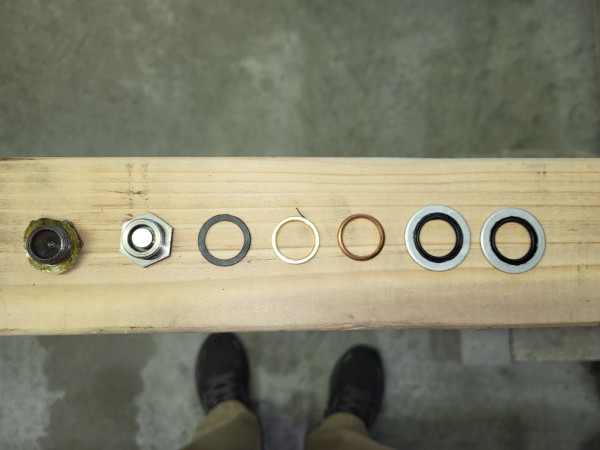

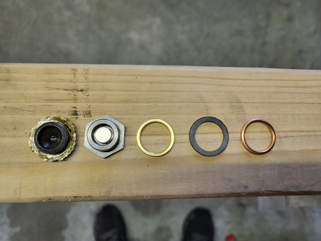

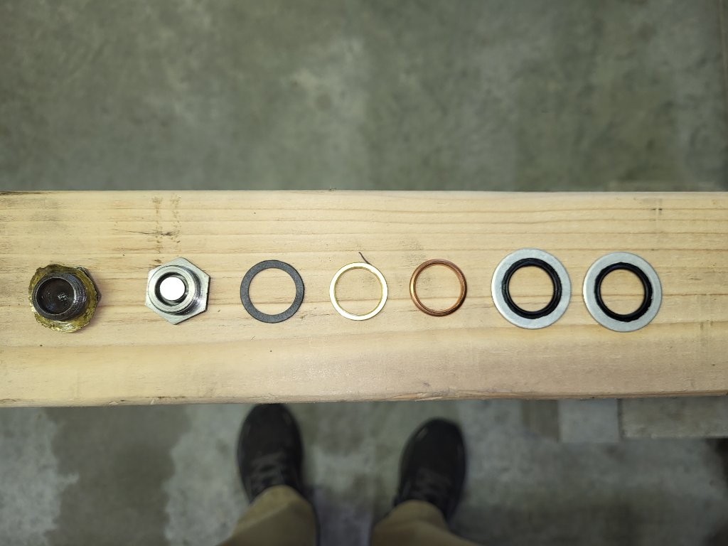

I am replacing my oil drain plug shown in the photo. I have three different types of washers. What is the best type, brass-fiber-crushable copper?

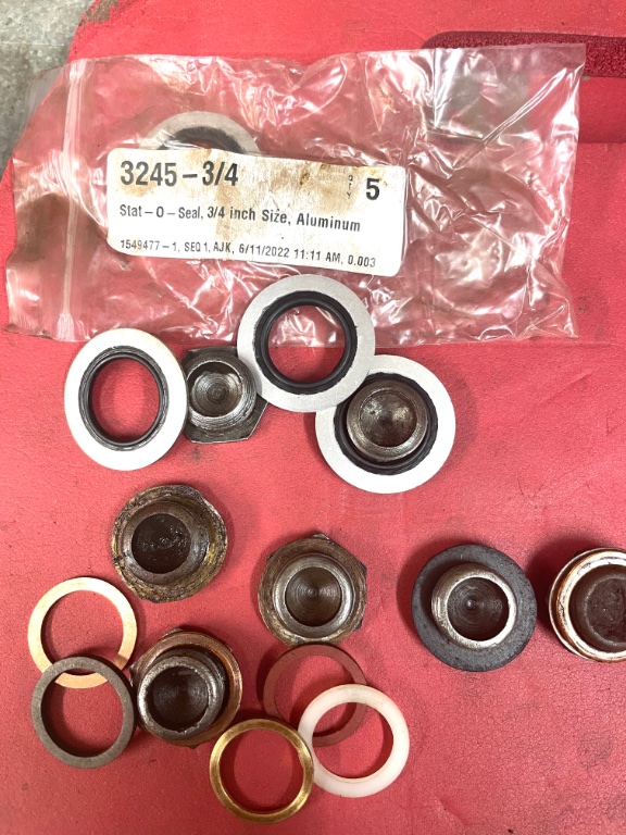

https://www.pegasusautoracing.com/produ ... oduct=3245
install and never have that problem again

The plug gasket surface on old pans may be scratched, galled, or pitted. Most of them have had a lot of use and a lot of abuse and a lot of grit ground into them. A fiber washer might seal better on a worn pan surface, but they can squeeze out if overtightened. I believe a new copper washer with fiber fill to be the best choice. A custom plug with an O-ring groove would probably seal tight on most pans. Well-used plug gaskets, no matter what material they're made of, that are flattened and imbedded with grit can be expected to seep oil.

Post by DanTreace » Sat Jul 30, 2022 8:27 pm
Scott_Conger wrote:
Sat Jul 30, 2022 8:10 pm
Not all weep!
Pegasus #3245-3/4”
So True!
Just used one on my most problem child! Ran today over 20 miles, in the garage now, still shiny around the plug, not a whisper of oil film!
Am a sold customer, it’s an annealed alum washer bonded with neoprene oil resistant center, squished tight and true. Did add a smear of Permatex #2 to the plug threads, but always do that. With any of these other washers and gaskets you will get seeps….none with Pegasus!

Stat-o-seal is very good. I use the copper clad one & replace it every time. If you find that your plug is leaking, take a foot of Teflon tape, spin it between your fingers into a thin string. Take the plug loose until you have a 1/16th gap ( oil will start to leak out.) wrap it in the direction the plug turns cross the ends over & tighten the plug. You now have a Teflon seal. This also works on carb bowl nuts. Its a old refinery trick. I have used it for years. When a plug gasket fails to seal.

I will add that Stat-o-Seals work wonderfully for the lower inspection plate and transmission inspection plates.
Additionally, I have modified the OD of one and installed it on the clutch adjustment screw lock nut with great success...so nice to have a T that doesn't drip.

Scott do you have a pn and source for stat o seal for the inspection door bolts? Mine leak something awful. Thanks so much.
Posts: 6732
Re: Washers for Oil Drain Plug
Post by Scott_Conger » Wed Aug 03, 2022 7:57 am
Mark, go here: https://www.pegasusautoracing.com/produ ... oduct=3245
scroll down the page and the order form will show up. Choose the screw diameter you want to fit and the quantity you want...hope this helps

Got two stat-o-seals. I have more seals than I will ever use, but I was curious about what is available!
