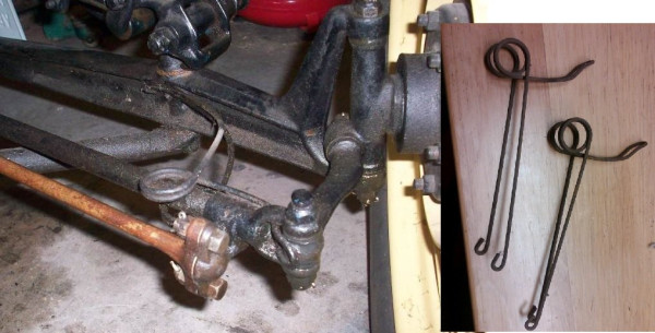

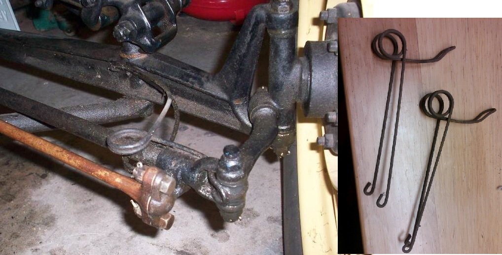

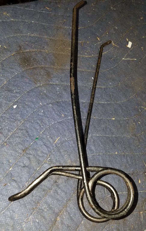

Can anyone give us instructions on how to install the brats anti-rattle Springs?[image][/ they are the large Springs not the little ones

Try here: https://mtfca.com/phpBB3/app.php/gallery/image/2275
There is a link in the comments section to the original post with more details. Your ones are in the picture and seem to be for tie-rods (see top right side for picture of them installed).

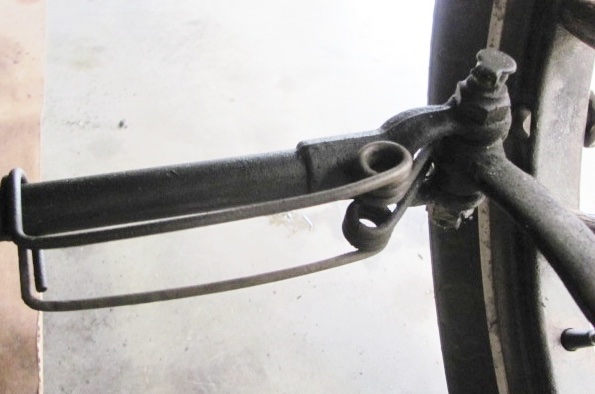

The small double end with curve rests into the yoke of the connecting rod between the spindle arms. The long trailing rod ends ride in the back side of the axle channel. They work to try to take out the Ford's Shimmy Shimmy :lol: Have seen axles where these were used, and the hardened spring steel rod ends groove the axle.

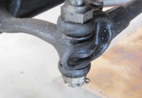

Here is the more common version, with hooks that cross over the connecting rod, these tighten up the spindle arm bolts, to keep wiggle down. They are on my '23 cutoff and have been there since so long ago, the spindle arm is worn to match!

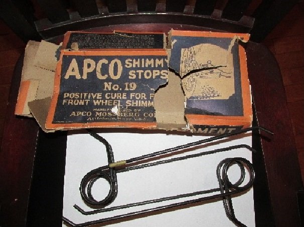

The ones you have look like the APCO Anti-Shim pair. There were a similar kind with curled ends but I think they would attache the same way.
