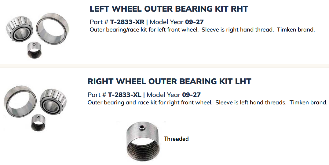

My 19' touring's front wheel bearings, both inner and outer, are pitted and worn out. They are tapered roller bearings. I purchased the T-2833-XR(and XL) kits which use non-threaded Timken bearings. I was wondering if I needed to replace the axle sleeves, even if they look okay? They are shiny and seem to be fine, just the bearings were pitted - even the hub races seem okay.
When would you want to replace the sleeves? Do I need to do it as part of the replacement of the bearings?

And did you notice that kit only provides the outer bearing? You will still need to get an inner bearing and cup. The cup you can probly get, the inner bearing may be hard to find still.

OP it talking about the thread adapters that go inside a non threaded outer wheel bearing.
The adapter allows the use of a $20 bearing over the correct threaded bearing that when available runs $90.
Look @ the part # on Snyders site.
This set up looks like it would be very difficult to adjust correctly. I have no personal experience.
I would not run them or encourage a customer to run them. There are a lot of great serviceable, correct used bearings out there, that can be had cheap.

I assume your are referring to the threaded sleeves shown with the parts you purchased. "Shiny" could be caused by the bearing race spinning on the sleeve. So can we assume that the old outer bearings are the same as the "kit" you are replacing them with? Since its a kit I would use all the new parts. Doesn't look like its that hard unless the old sleeve is rusted on the spindle.
