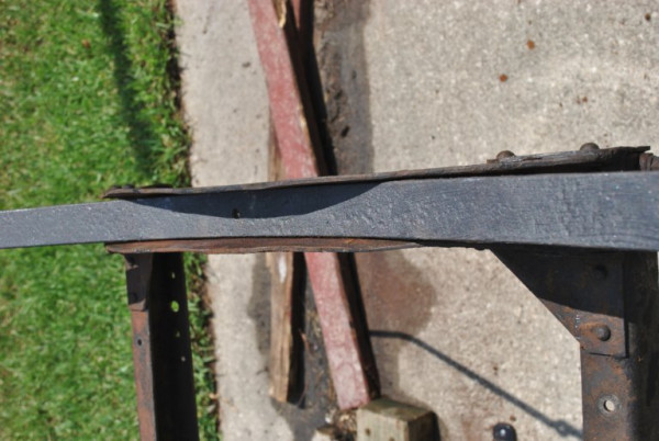

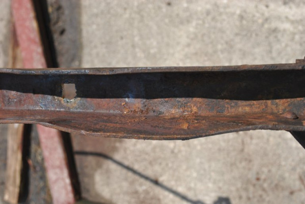

Pressured washed the frame got 99&44/100% of the red clay off

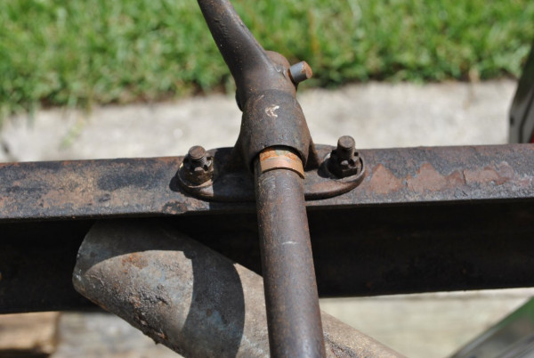

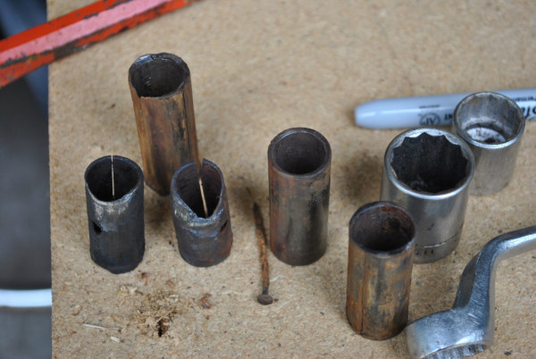

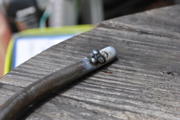

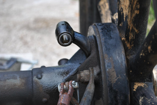

as far as I can tell this is a piece of copper tubing used as a shim for worn brake pivots.
same for other side

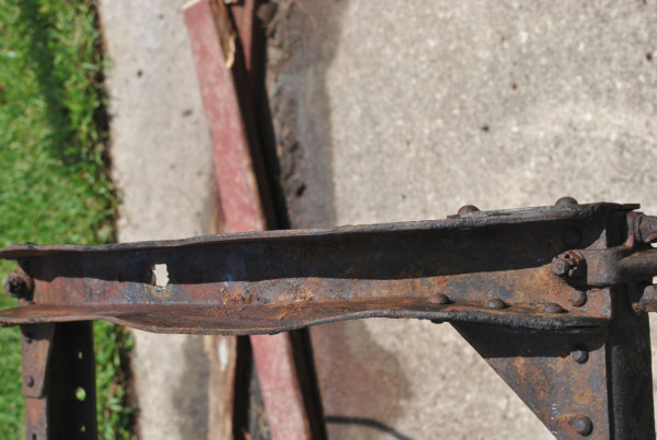

this area seems to be bent
better view
well as straight as I could get it.

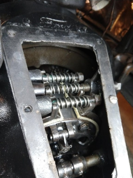

My son needs to get into changing the bands on my tourer before he is ready. I can probably get the hogshead off and reline the bands, but I'll need his muscle to put it back together. This is the car we have fitted with two child restraint seats in the back, as required by law these days.

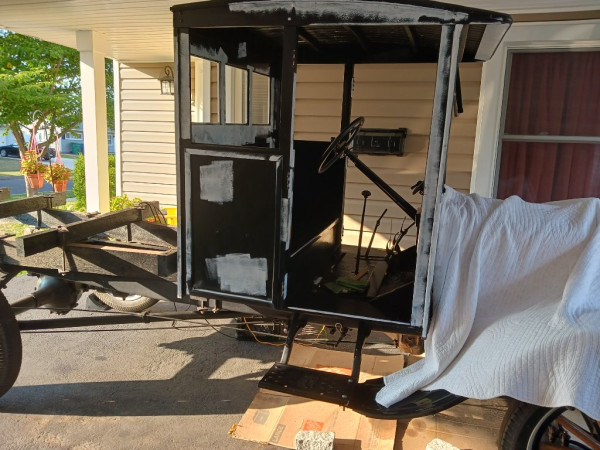

Replacing the original Valves and Pistons in my 1922 Center Door. Someone did a valve job in the past and didn't do a very good job. Aluminum pistons while I'm doing the valve job. Modern type valves with adjustable lifters. Have to get it running good to take it to the Old Car Festival!
Also got my 1923 Touring car back from the painter. Pretty pleased with thejob!
Busy month for me getting all of this put back together.

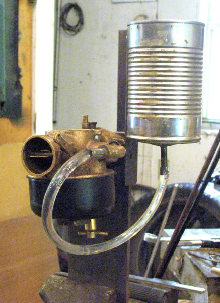

Finally got the Warford that Hank welded up for me years ago put together. ( does nice work doesn't he) It's a PA. case with NY gears & shifter and nothing fit easy.

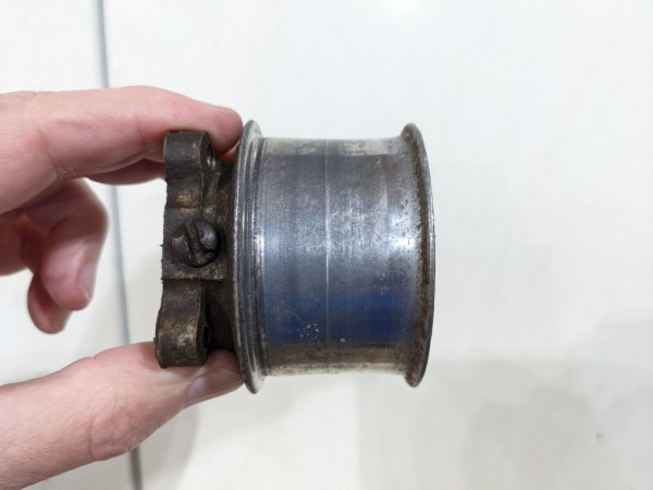

Post by Mark Nunn » Thu Aug 04, 2022 12:45 pm
Not only are my fan hub's bushings shot, it's worn in the center about .090". No wonder my fan belt would not track right.

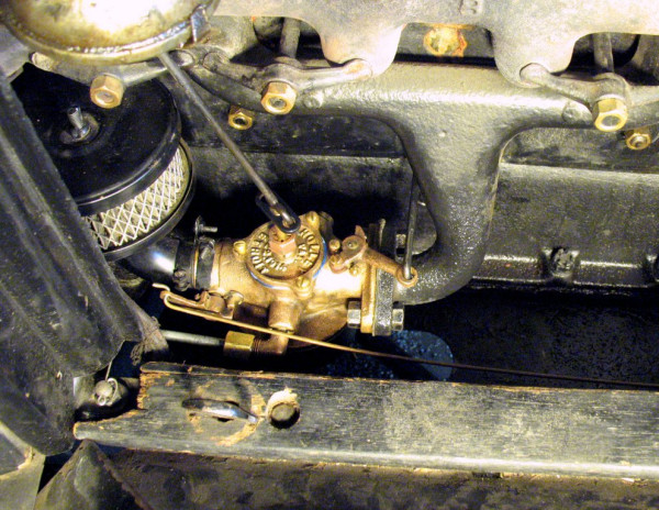

Just got a bulk order of parts in and now am coming up with a choke rod for the U&J so I don't have to have the wife hold the lever by hand every time we go to use it. She sure is supportive of the cause.

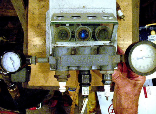

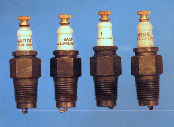

Post by Steve Jelf » Mon Aug 08, 2022 12:37 am

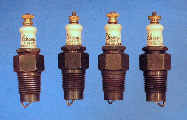

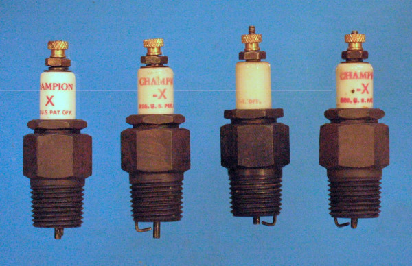

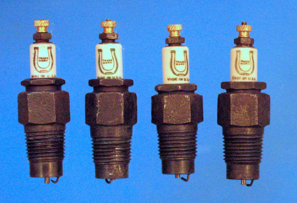

Today I finished up the spark plug restoration project I've been working on lately.
One set will go in the car and the rest will ride along as spares. I haven't decided yet which ones I'll use first. I'll test them all one more time before I put them away.

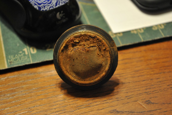

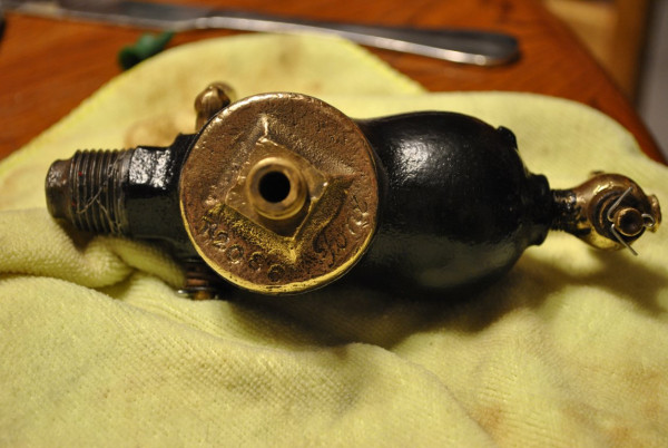

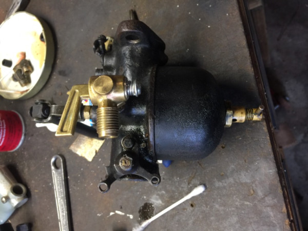

The fuel bulb (Potato) fuel shut off handle wouldn't budge so I let it soak for 48 hours in lacquer thinner and tranny fluid. shut off handle still wouldn't budge so I removed the cotter pin, spring and washers gave it several taps with a very small hammer and it came out along with a lot of gunk. took the fuel screen out this is what it looks like after swishing around in parts cleaner.
Posts: 7395
Re: what have you done with your model T in August
Post by Steve Jelf » Mon Aug 08, 2022 9:17 pm
Looks like rust in that screen. Dry the parts cleaner and try 24 hours of Evaporust. If that doesn't do it, try 24 hours of CLR. If that doesn't do it, buy some brass cloth and solder in a new screen. Solder will go where there is flux, so be careful.

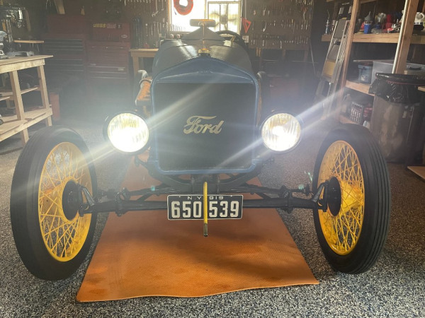

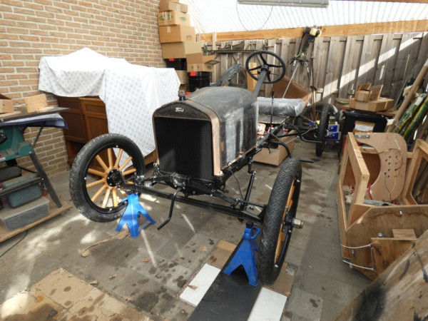

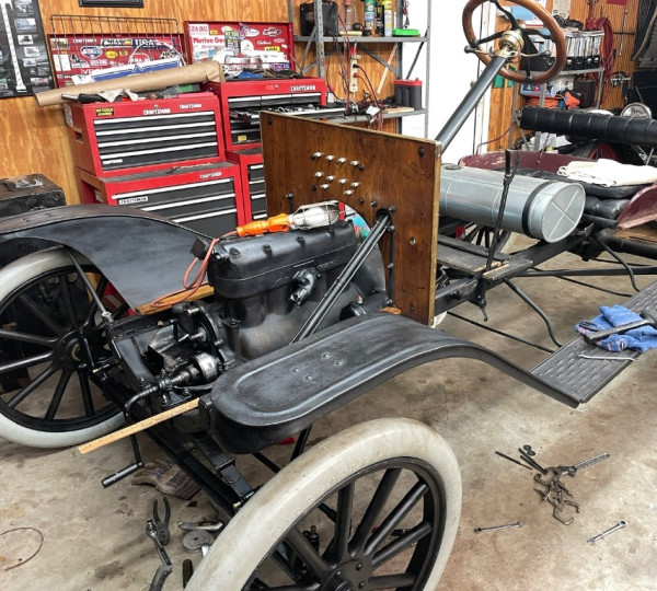

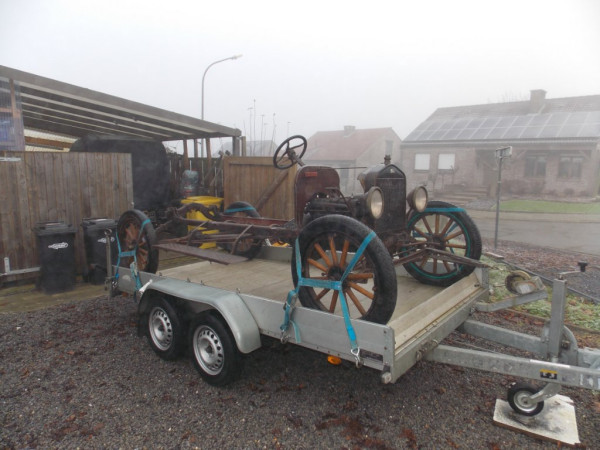

In January 2022 a lowered junk frame followed me home.
206 hours elbow grease and a lot of parts I arrived to start it up for the first time yesterday.
Still a long way to go to build a nice speedster with it.
Andre
Belgium
https://www.facebook.com/10000304163899 ... 6200224286
First start, yesterday 8-8-2022.
This followed me in January 2022.

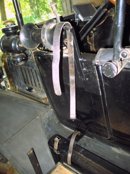

Post by ironhorse » Tue Aug 09, 2022 8:45 am

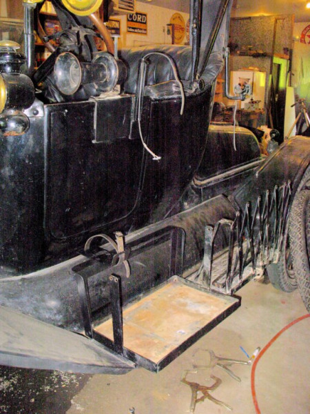

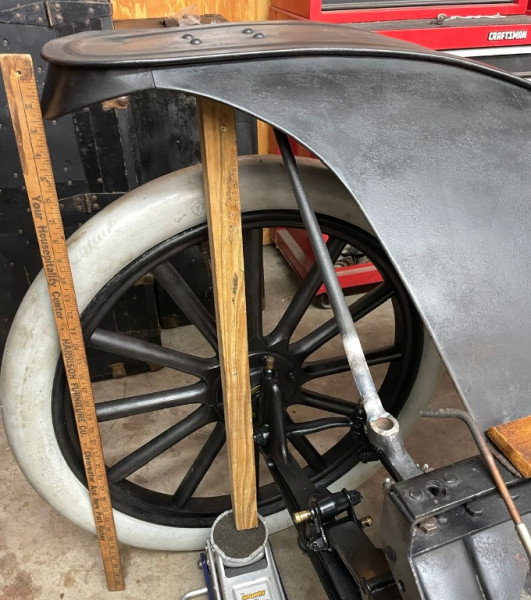

looks like it is coming along nicely Andre,Good Job. I have been taking advantage of my wife being in a Skilled Nursing Facility to get some work done on the 25. This is what I found on the front fender supports
We'll go in for a better look
the drivers side fender support bolt was loose causing all of that wear
passenger side wasn't too bad
a little welding
and wa-la serviceable again
Posts: 8438
Post by TXGOAT2 » Tue Aug 09, 2022 9:18 am
Just about every screw and bolt on a Model T needs tightening from time to time. The body to frame bolts like to loosen on cars that are driven. They do not need to be super tight, but snugging them up once in a while may get rid of some rattles, squeaks, and bumps. The bolts holding the running board brackets to the frame and the running board to bracket bolts can loosen and make a lot of racket.

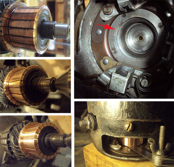

I'm tired of messing with my generator. So I've done something I swore I would never do, I replaced it with an alternator. I don't know what my hang up has been. I have disk brakes, a dip stick and a Scat crank, so why the problem with modernizing the charging system? Are turn signals next?

Steve the CLR worked good on the fuel screen
So it is back together now and it doesn't leak

I have a set of Wards and never was able to get them to operate correctly in my car

I have a set of Wards and never was able to get them to operate correctly in my car.
Did they test OK?
Will_Vanderburg
Posts: 945
First Name: William
Last Name: Vanderburg
Location: Jackson, NJ
Post by Will_Vanderburg » Thu Aug 11, 2022 5:44 pm
Steve Jelf wrote:
Thu Aug 11, 2022 5:37 pm
Did they test OK?
The car ran but ran poorly regardless of what gap I chose. Had the same problem with Motorcraft F-11’s
I didn’t take them to a shop with a plug tester

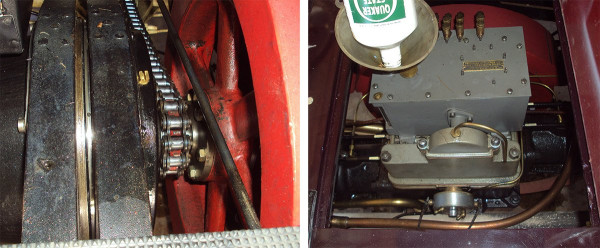

Added oil to the transmission and the oiler.
OK, not a model T. :D The Buick uses heavy oil in the transmission but the bands run without. The brass plug in the center of the left picture is where it goes in.
The oiler sits above the engine and disperses oil to 7 locations. A bit of a contrast to the Ts.
Back to the model T talk.

Rich:
My dad's 1910 IHC Model F roadster also has a Hill Precision Oiler (The Shooting Oiler) but not the same model as the one on your Buick.
It operates via a lever on the right side of the unit that is driven by an eccentric around the same shaft that drives the magneto (second photo).

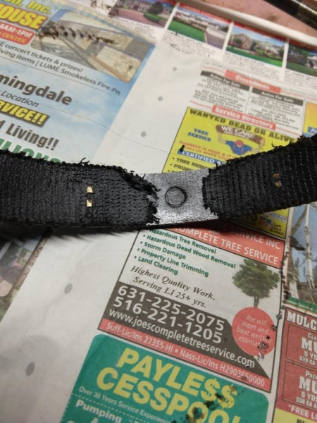

After getting stuck two weeks ago downtown I was unable to move the car in low gear. I'm new to model T's and this is my first car (a barn find). It was working fine until the last time I drove it. I struggled to get home in high gear and realized I HAD to re-do the band linings. Not knowing if the bands were the detachable kind, I, with the help of my buddy Bob, took off the hogshead. Not a difficult job for two, since I had watched the videos online over and over. The low speed lining was as thin as toilet paper in most spots, but missing in others. I'm cleaning up everything and waiting for the new kevlar linings. Can't wait to get back on the road.
John

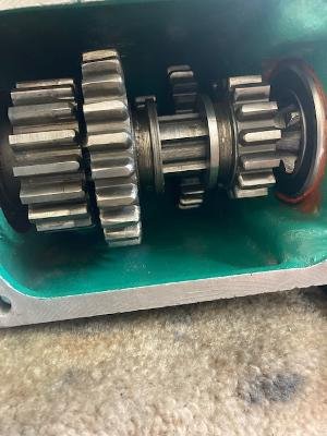

Post by Craig Leach » Sat Aug 13, 2022 12:18 am
Andre,
That's about what I started with 15 years ago ( 30 some speedster runs) I have had my Wife, kids, son-in-laws, grandkids & good friends navigating for me. Been some of the best times of my life. Hope I and the T last long enough to get some of the great-grandkids in it.

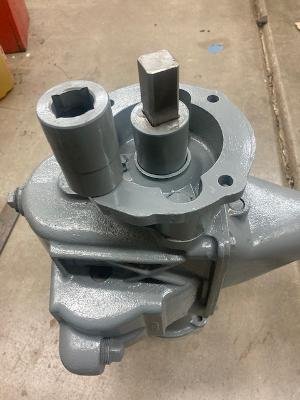

Machined some drive couplers for Muncie Aux. Transmissions.
Muncie drive.jpg (21.91 KiB) Viewed 14325 times

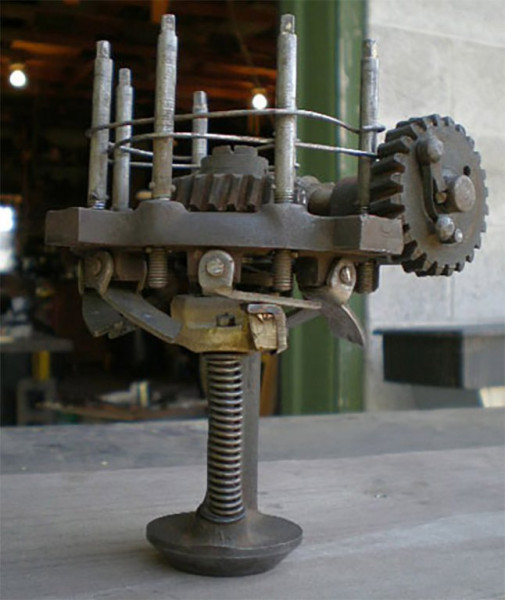

Eric and others, this shows the workings of the Hill Precision Oiler.
http://www.mtfca.com/discus/messages/41 ... 1390683057
I mistakenly called it a Pittsfield. It's one of my favorite mechanisms.

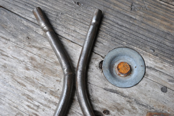

Post by Steve Jelf » Thu Aug 18, 2022 1:21 am
On Monday I used my home made gauge to set the float level in a Holley G, and today I installed the carb on my runabout and tried it out. It surged and ran rough at first, but smoothed out with adjustment. Oddly, the car ran a little better on BAT than on MAG. I don't know what to make of that.

Post by TXGOAT2 » Thu Aug 18, 2022 8:06 am
Ford claimed a T would run best on magneto. Mine certainly does. If yours runs better on battery, it might indicate that you have a poor connection or some other issue in the magneto circuit.
Posts: 7395
Post by Steve Jelf » Thu Aug 18, 2022 8:30 am
Yes, mine always have too, I assume because of its higher voltage to the coils. This anomaly just happened. I'll have to test the mag and check all connections.

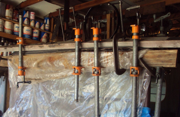

Post by Rich Eagle » Thu Aug 18, 2022 3:35 pm

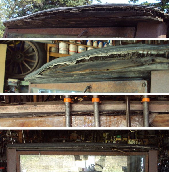

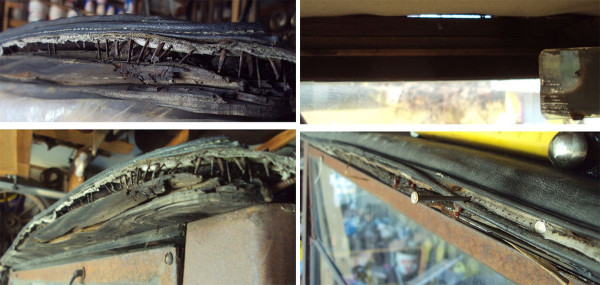

Thanks for mentioning "Shadows and light" and paintings Dallas.

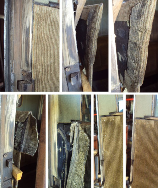

The front of the top has been separating and lifting on the Coupe. When I built it 10 years ago I didn't expect to drive it this much and used 2x4's from the lumber yard to re-wood it. It was to be yard Art that would run. So I wasn't surprised when a few things loosened up. Actually the body is still quite solid and the doors open and close nicely. Seeing blue sky above the windshield suggested I close the gap before Winter.
http://www.mtfca.com/discus/messages/25 ... 1335009157
I still had a little West System Epoxy left so I mixed it up and tried to stuff it in the cracks. Then I clamped the front, top material and all together as best as I could. I hoped the material would stretch without tearing. I let it sit two days and unclamped it.
All went well and I believe it will last until I need to replace the top material. It sits outdoors year round so the material will start getting holes in it in half a dozen years or so unless we get big hail. I have tested this top material outdoors on other cars and that's about how long it lasts. It's not pretty but fits the tattered look of the car. I drove some nails into it to hold it straight but they didn't find much solid inside.
I think it is good to return the profile to the original shape.
If I had found a "Real" Barn Find I might be doing similar repairs to the original wood.
These repairs are satisfying and don't require the care a better car would.

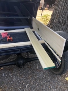

At long last I found the time to build a pickup box for Lizzie. Rich's post inspired me to comment on wood. A friend hauled some native poplar logs to a local sawmill, and was kind enough to let me have enough planks for my project. It got me thinking about the wood species used for body work "in the day". I'd reckon the main consideration would have been cost, availability and working characteristics. All three definitely favored poplar for Ford's mass production, but as far as strength to weight and rot resistance goes, I don't think Douglas Fir two by fours are an inferior choice for re-wooding a body. The only drawback I can think of is a bit more difficulty in machining.
Get a horse !

Post by George N Lake Ozark » Sat Aug 20, 2022 1:58 am
Spent the afternoon reassembling my NH carb with new shutoff and new to me larger “B” float.

Post by bobt » Sat Aug 20, 2022 5:49 am
I bought the same shut off valve and hated it. It worked fine for a short time and then became stiff. Good luck. bobt
Posts: 2547
Last Name: Strange
Location: Hillsboro, MO
Post by CudaMan » Sat Aug 20, 2022 8:00 am
Bobt is correct, that particular shutoff valve does tend to get stiff pretty quickly. It can also leak more than the modern looking ball valves that are available.
I like the look of it though, so once a month I shut the fuel off at the tank, remove and lubricate the carb mounted valve with EZ-turn, and reassemble it. :)
https://skysupplyusa.com/ez-turn-lubric ... vCEALw_wcB
Posts: 7395
Post by Steve Jelf » Sat Aug 20, 2022 9:29 am
I hated that valve too, and I took it off and did this:
https://dauntlessgeezer.com/DG106.html

Spent the day (before it got too hot and steamy) replacing spring and perch bushings here are some of the worst
The 3 on the Left look like someone tried to get them out with a punch, failed then drilled them back out and put the shackles back in
Ahhh! that looks better. Now when I get my new shackles I'll ream them to the correct size that's enough for today.

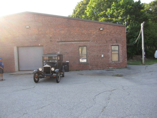

Post by NU2theT » Sun Aug 21, 2022 10:06 am
Picked up my brother-in-law and drove to the Portland Red Cross to donate. This building used to be part of the old Northeast motors that had dealings with Ripley & Fletcher in Paris Maine that has been a Ford dealership on that location since 1909...for all you history buffs :D

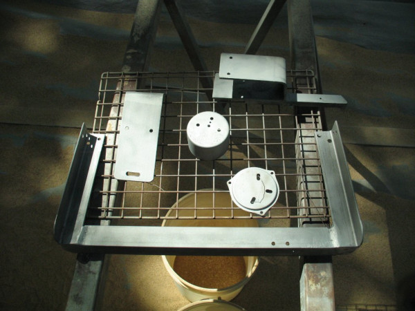

Post by Steve Jelf » Tue Aug 23, 2022 10:56 pm
Blasted parts for a new spare carrier and a speedometer case, and painted all.
They will bake overnight.
I'll post pictures of the carrier when it's done.

Post by TheSaintDiscJockey » Wed Aug 24, 2022 6:56 pm

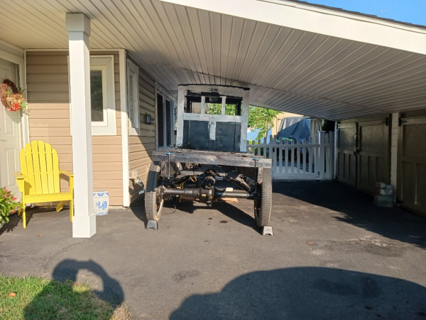

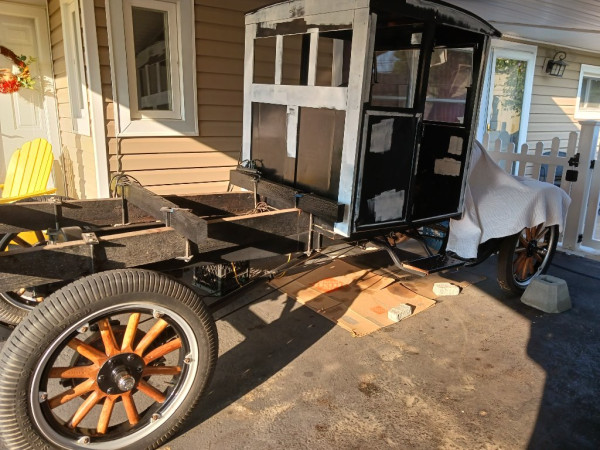

Picked up this '23 TT the beginning of July. Going through it with a fine tooth comb.
A lot of work. A lot of satisfaction.
Keeping Lang's and Snyder's (and our forum members) pretty busy.

Fitted the front fenders to the ‘12 project.
The right was sagged about 2” and couldn’t imagine driving with a fender tip down :?
So out with the hot wrench, jack and wood support. Heated red the fender iron and sag gone. Both fenders level as they should be. :D

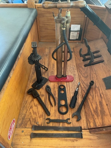

Finally was able to get all of the parts in the same place for my 1915 tool kit project.
Would appreciate if anyone has a ‘15 era duck tool roll to send me the size off it closed before roll up +/-. Thanks
(Pay no attention to the pedals…lol. That’s the ‘19 Hack and not the ‘15 Roadster. 26/27 pedals on pre-26 spacing. Keeps the feet from sliding off)

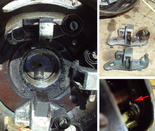

Driving the '14 from breakfast a tapping sound came from under the hood. Investigation showed it was the lower pulley pin had slid down the hole. I punched it out and peened and punched enough distortions in it to keep it tight. Then reinstalled it. I'll do a proper fix later but this could be done without removing the radiator.
The next task was to fix the generator. It was only charging intermittently and only when it got warmed up if at all. My first experience with electrical components was tearing apart a friends erector set motor. Simply reassembling it made it work fine. I learned absolutely nothing but it gave me great confidence. I have repeated this with high tensions magnetos, generators and starters. A good cleaning yields a working unit and I don't gain much knowledge. This generator was much the same. Some fuzzy black lint lined the brush holders and housing. A good cleaning and now it works fine. I don't understand the problem here either. If the lint was shorting something out wouldn't it tend to burn something up? Maybe the experts can explain.
While generators were on my mind I looked at the previous generator which died several years ago. A loose brush spring led to the problem of a broken spring post. Cleaning and replacing the holder, the generator motors nicely. But I see sparking inside between the armature commutator and the 4-holed ring that lets the brush plate rotate. I will disassemble it tomorrow and see why the armature it that close.
Another problem was the door upholstery rubbing the door post and pulling the nails loose. Pulling it away from the door I found glue holding it to the cardboard panel. I soaked some lacquer thinner on the material to loosen it. Then I trimmed about 3/16" of the cardboard away and re-nailed it in place. I see some other areas that need a similar redo. Upholstery is sometimes trial and error and this was error.
All in all it was a good day at the old car barn.

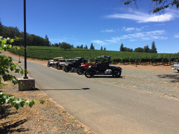

Post by Norman Kling » Thu Aug 25, 2022 10:30 pm
Harrison in front right
I finally got Harrison (our 26 touring) "Harrison Ford" on his first tour since May when we blew the head gasket. I found the cause of the gasket problem. This is the second time it leaked in the same place, however worse than the last time. Many years ago, I had a problem with the threads in the last bolt at the center of the back of the head. I drilled it out and put in a heli-coil. Apparently my drilling was about 1/32" too shallow The first time it happened, I had the head resurfaced which took a little off the entire head.
This time, I checked all the bolts and they are all fine except that one. So in the past, when I torqued the head, it bottomed out and the wrench read 50 ft lbs, however that was against the block and not against the head. To fix this I would have needed to slide the engine forward and risk destroying the heli-coil. So I put a washer under the head of just this one bolt which allows it to go all the way down without bottoming out. I also smeared some high temperature permatex around the front and back "steam vents" Not around the whole gasket, just the two small areas. I also replaced the freeze plugs with new brass ones also using the permatex. I torqued it three times after heating up the engine. I have a Ford head so it should be torqued hot.
Today we went out on a hot day, toured about 60 miles with the club and even going up some grades. No overheating and no problem today.

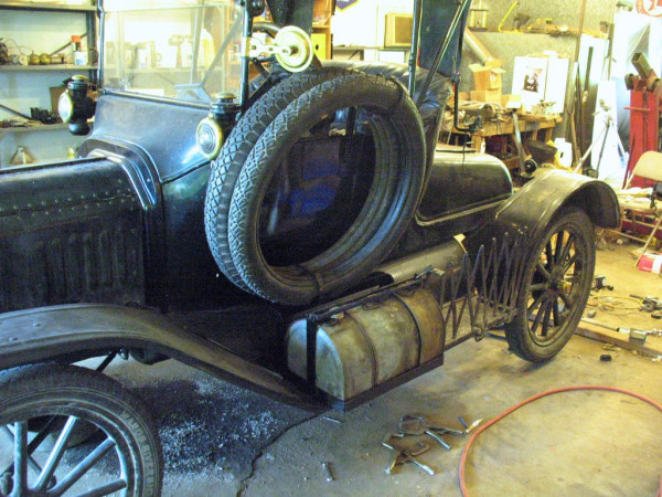

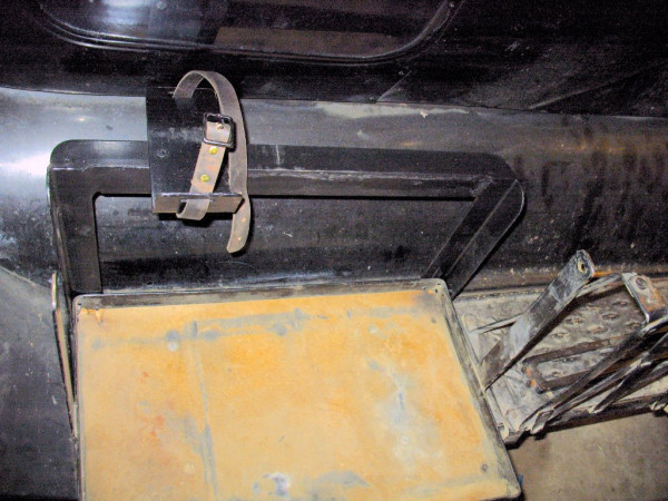

Today I finished up the spare carrier for my 1915. It will hold a front tire and a rear tire. Why not just carry tubes? Because I have had adventures where the tire came off and disappeared. Walking back and forth along the road multiple times was futile. I never found either tire. So I will carry spare tires, not just tubes.
The carrier has a top part and a bottom part.
The bottom part is attached to the inboard side of the running board can carrier.
The top part clamps over the top of the driver's side false door.
Cans in place and tires strapped in.

Looks like you are ready for OCF. Just pack your bags.

Yesterday I mentioned "...sparking inside between the armature commutator and the 4-holed ring that lets the brush plate rotate" on the generator. Upon disassembly I could see a ridge worn on the commutator end. Also a bright spot was worn on the ring (see arrow). Thinking the latter was a high spot I tapped it down some. Then I cleaned up the end of the commutator on the lathe. On reassembling I have .025 clearance now. I also installed new bearings on both ends.
In reworking generators a couple dozen times I don't remember seeing this problem before. The amount of wear shown makes me think the generator was working and the shorting only impaired the function minimally. It did happen close to the third brush.
Again, the working unit hasn't taught me everything I need to know.
I'll settle for two working generators for the time being.

Looking good Rich ! Can't tell from the photos - did you undercut the mica segments a smidge ?

I don't see anything to locate the armature precisely fore and aft to prevent it from contacting the ring, unless it is the front bearing against the drive end frame. If that's the case, and the bearing is an annular ball bearing, excess wear could allow the armature to move back too far.

Rich, You want either this: https://www.mcmaster.com/catalog/128/1445
or this: https://www.mcmaster.com/95601A420/
and maybe this too: https://www.mcmaster.com/90089A420/
to shim out your bearing on the brush end and reduce endplay

Steve, I used to undercut the mica but haven't in years and they work a long time without.
Pat, the old bearings may have been worn enough to cause the problem.
Scott, I don't see play now. If there is any it is very slight. It motors now without extra sparks. just from the bushes.
Thanks all.

These also work well to control generator armature endplay, https://www.mcmaster.com/washers/disc-s ... pe~finger/ jb
