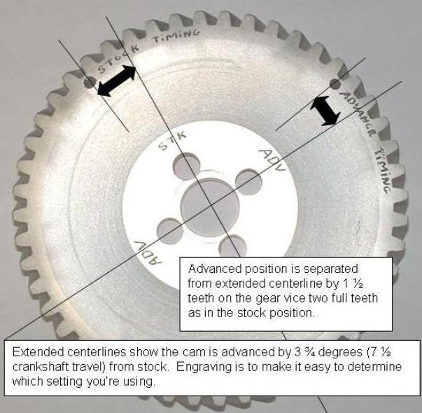

I am looking for suggestions of ways that I can determine if this cam is advanced while it is out of the engine. Even installed, how would I tell if timing is stock or not? This image has been posted many times on the forum. Does this offer clues? I have a spare timing gear that I can install for comparison. But I doubt that I could learn anything about cam timing.

My cam was reground. I believe Stipe grinds new blanks. I'm hoping that I can use the cam gear pins and dial indicators to find lobe lift angles. One of my local club members has an adjustable cam gear that he is not using. I may be able to test with that gear either out of or in the engine.

Mark, with v-blocks and a degree wheel attached, you can fixture a drop indicator or similar to measure total .270 lift (in reality I think setting the measurement to .265 is more realistic to gauge a .280 regrind, but that's just opinion). That now mimics your valve including valve lash of .010". Then back up until JUST beginning lift on intake and set your degree wheel to Stipe spec for lift angle. You can now determine total duration and valve open/close events. If sitting on a surface plate you can also now move to exhaust and measure all angles and duration of exhaust. If it all matches a Stipe, then it's a Stipe. Whoops! Problem is Stipe doesn't regrind that I am aware.
So now, you must ask any/all Chaffin customers or Mark himself as to what the Chaffin regrind is ground to and use the same methodology as above. You will eventually find out what you have.

I have never tried to measure the camshaft timing advance. I think it could be accomplished by using the cam gear timing mark that matches the crankshaft gear. I believe the marks match when #1 cylinder is at TDC, but I could be wrong. This is what I remember from working on small block Chevy engines 60 years ago.

Art, when the crank and cam timing marks are aligned, there are no pistons at TDC
