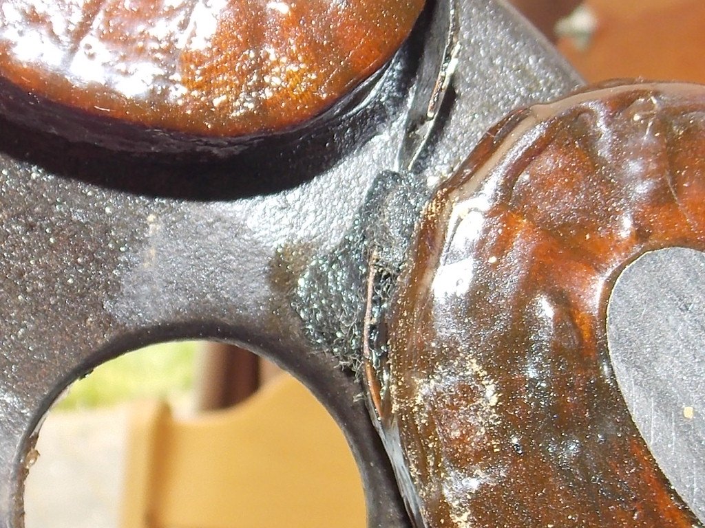

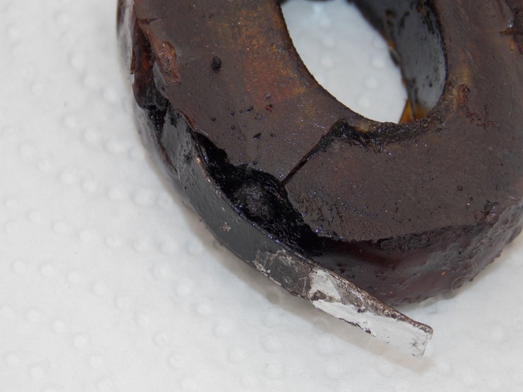

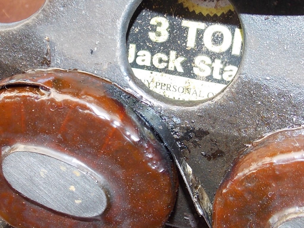

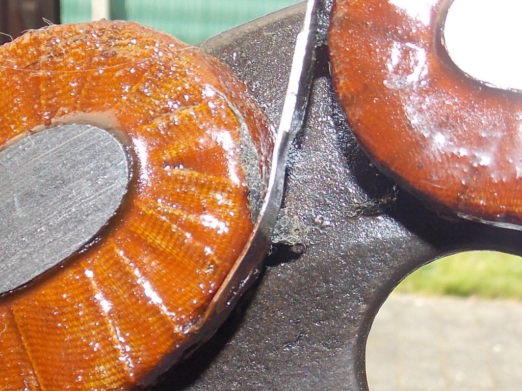

Norman is so right with his advice to check the magnéto and coils but I would like to add this to the comment.
Sometimes the reason of not good or not at all working of the magneto is brake band debry between the magneto coils.
See photos.
Good luck.
Andre Belgium
