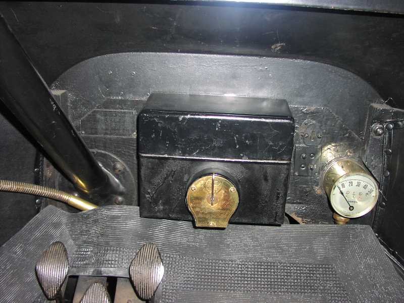

I am installing a new firewall. I have it all ready except for the finish. It is made of birch plywood and it is very blond, almost white. I have seen others in pictures and they appear to be stained a darker color.. Any advice about a stain that was used. We have a 1916 touring. I also have a new patent plate to install. Where should it be mounted?

The patent plate should be partially obscured by the cowl - original examples as well as the factory drawings showing the location of the plate back this up. This has been discussed in the past:

Mount it just to the left of the steering column, and slightly under the cowl. There were no serial numbers in 1916.

Here is the placement of the 1915 patent plate. The top left corner gets covered by the cowl.
