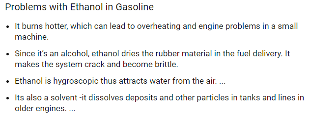

Re: Gasoline Question
Post by Tim Rogers » Tue Sep 13, 2022 2:55 pm
