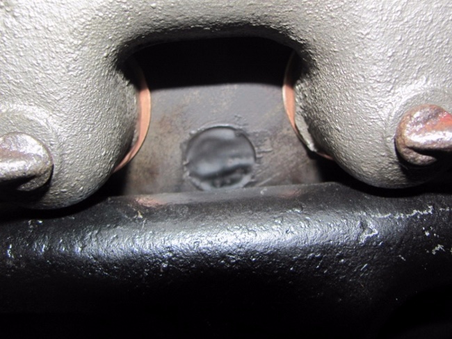

- Posts: 4056
Re: 1926 Model T
Likely the core, frost or 'welsh' plug on the block, which is used to plug the core hole, has now rusted through and is leaking coolant from the block. Time to replace the plugs, or for temp fix, smear some JB Weld or other epoxy over the remains of the plug.
- Attachments
- 663158.jpg (118.72 KiB) Viewed 7806 times
- Posts: 4056
Re: 1926 Model T
J B Weld fix, still holding after 6 years

or right thanks
i make new freeze plugs in there,
i make a little bit loctite on the freeze plugs thats ok?
and the valve play adjustment?can say me how much is the play on outlet and on inlet valve?
