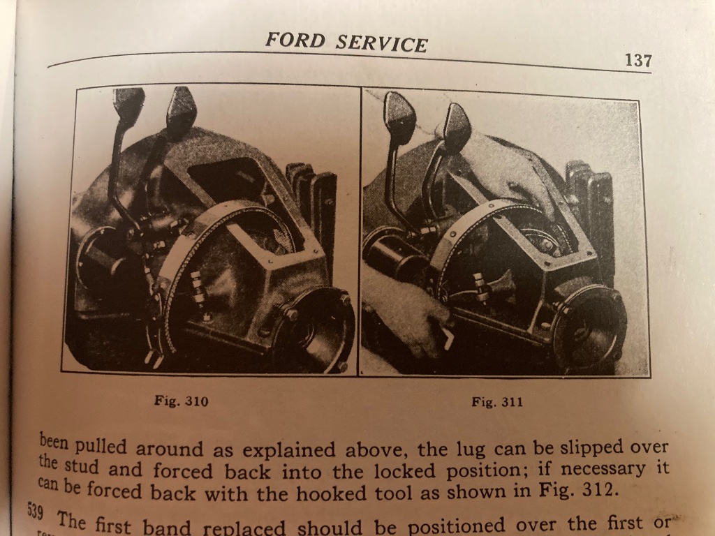

Yes it can be a hassle. The time study in the Ford service manual uses the idea that everything is in its place, and it all goes 1 2 3. In reality it’s most of the time that it doesn’t. The information that’s in it is really good if all is well which a lot of the time it doesn’t go well. If you were doing it on a daily basis at a shop it would get to be easier as time went by. Most of us don’t do it all the time.

Can any one do it like Joe Snow? This was in 1924 with the removable band ears. You can do it in 30 mins or less!
