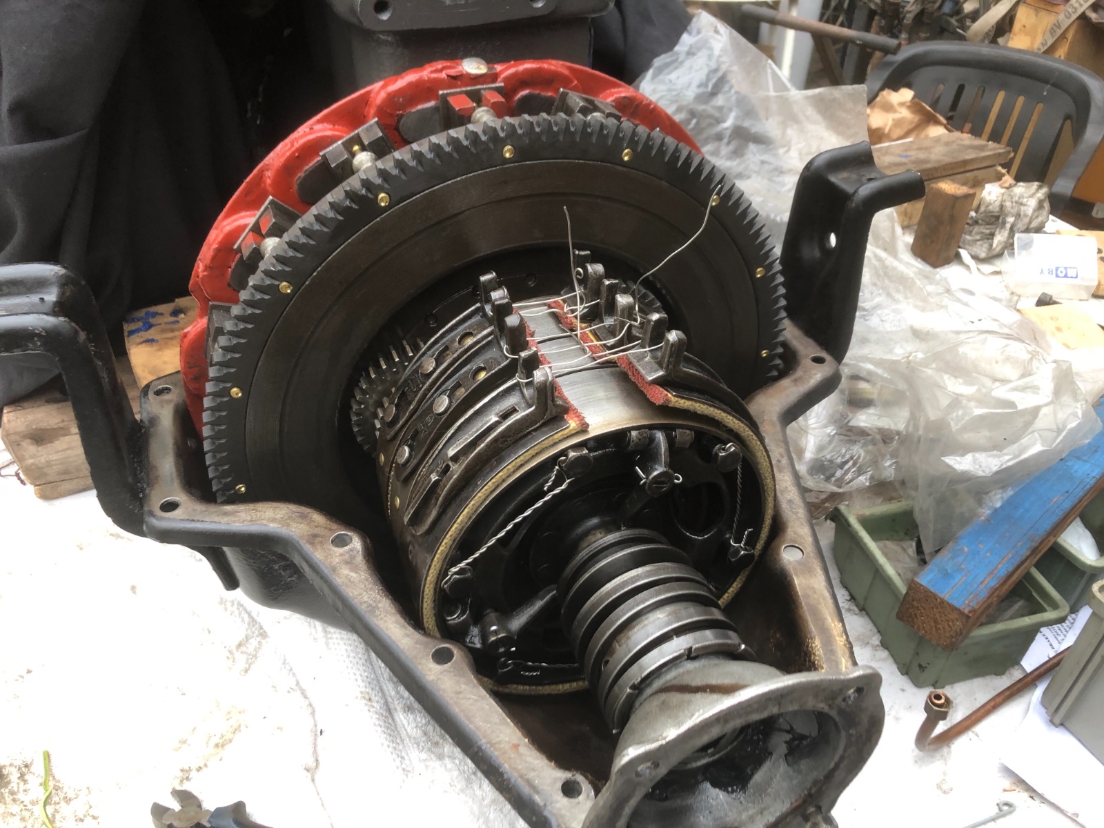

Re: transmission bands
Just renew my bands with keflar
I have also the removable ears on my bands
See here a photo
See here a photo

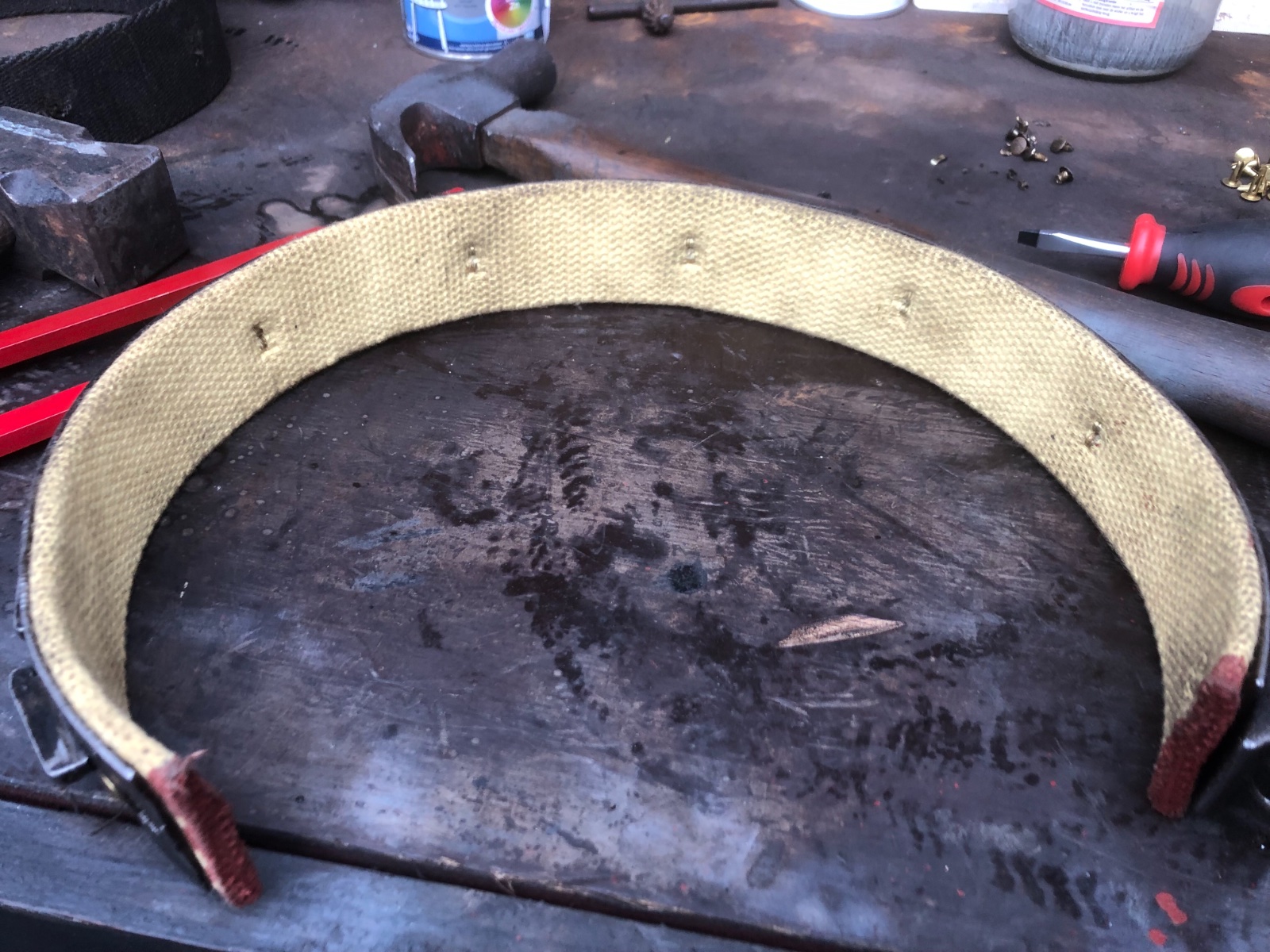

with Kevlar, it is most imperative that your bands be perfectly round and not have any areas that drag on the drums. It is handy to have a spare scrap drum to check against.

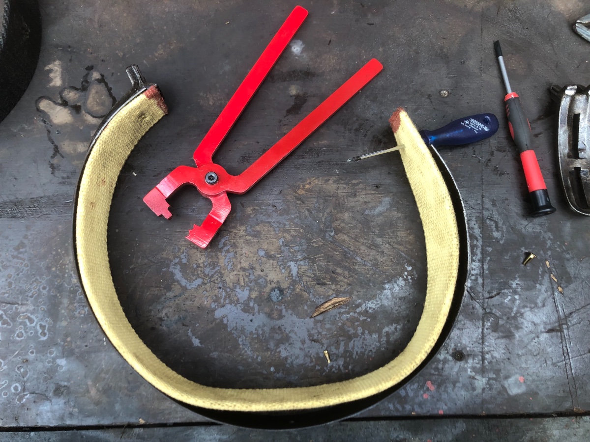

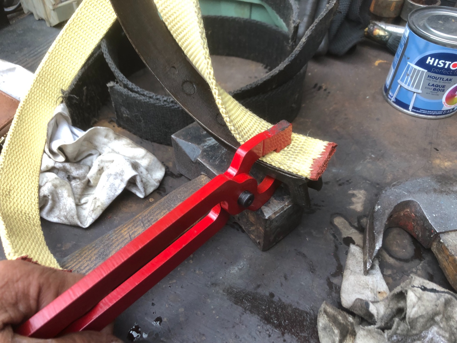

infotfordnl
- Posts: 84
- Joined: Tue Jan 15, 2019 2:11 am
- First Name: Bert
- Last Name: van Amstel
- * REQUIRED* Type and Year of Model Ts owned: Runabout pickup 1927
- Location: Netherlands
Scott
I did first the outside rivets than push the band with hand back so long that it is nicely and without any bubbles and hobbles
Then I put the other rivets starting in the middle and working 2 ways out to the end, I follow the users manual who come with the band.
To bend the rivets correct I bought also the red tool on the picture.
Lets hope I did it well... but the feeling is good on this moment.
Now first solve my timergear problem
the gear was for 2 weeks in border transit to holland..
