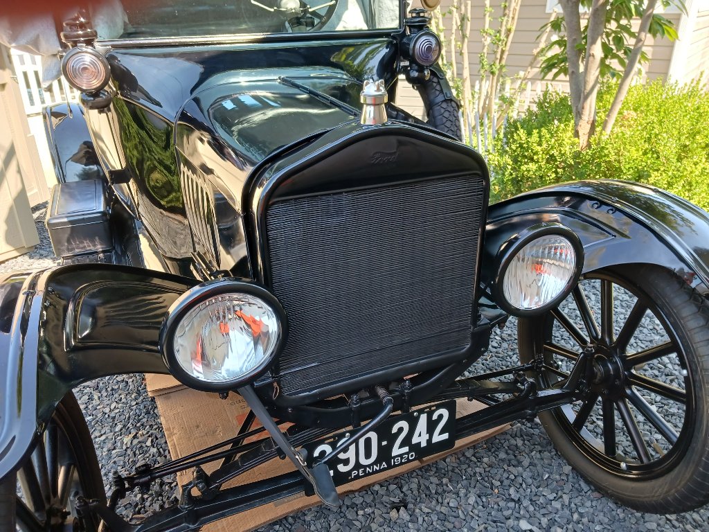

I have spent a lot of time since early June working on the "new" '23 TT. The '20 Roadster was sidelined for the past few months. Cleaned up nicely this morning and started right up on the first crank.
Almost got a free start, too. A good morning... [/size][/b][/b]

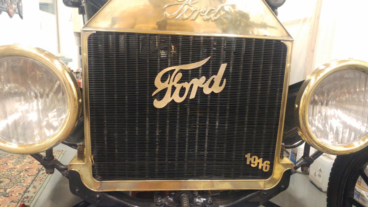

Re: What have you done with your model T in September?

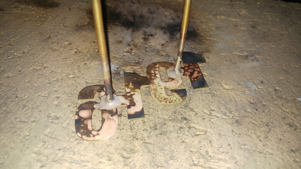

I improved and made radiator decoration.
I made my own "1916" script for the radiator because I don't like the available ones. I milled it out from 1 mm brass sheet, then hard-soldered brass rods ø3mm with M3 thread at the end to it, polished, and electroplated with gold.
I also soldered same brass rods to the back of the "Ford" script I already had, so there are now no ugly wires visible any more. The Ford script is now also electroplated with gold, so I do not have to polish it again and again.
Here after soldering, before polishing the back side.
All decoration scripts are mounted to the front with two black Nylon washers (1 mm each) between script and radiator fins, so they don't reduce air flow and scratch on the radiator. This also looks more elegant, they seem to "fly". On back side there is another Nylon washer, a thin brass washer, and finally a thumb nut.

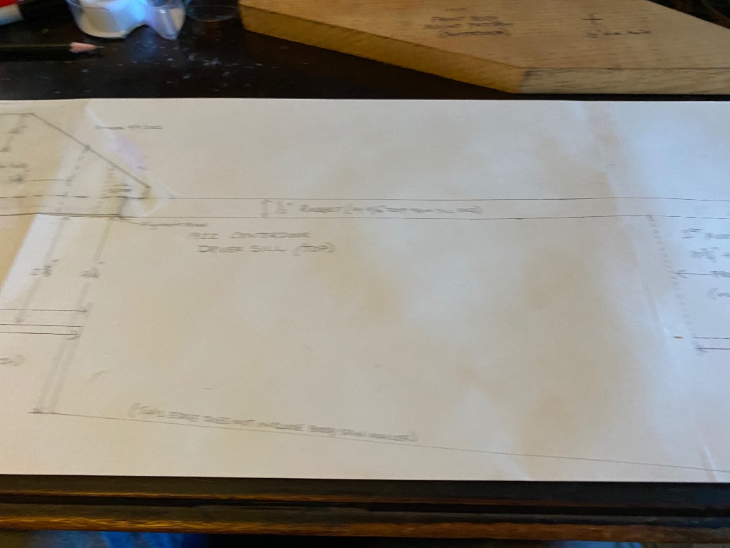

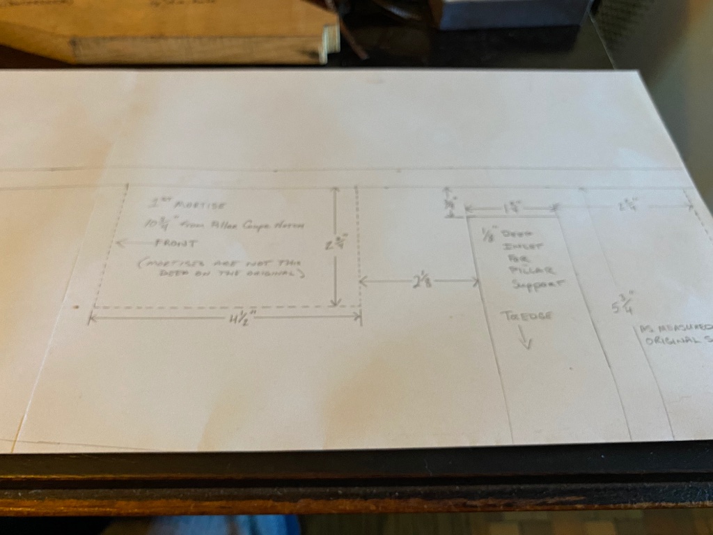

Drawing some plans

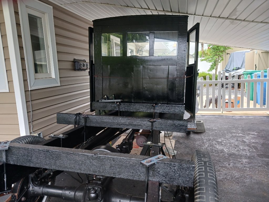

Cab is prepared and painted. Glass installed.
Rear lantern bracket made and installed.
The bed is next. Original irons will be repurposed this week.
The '23 TT is coming along./size][/b]

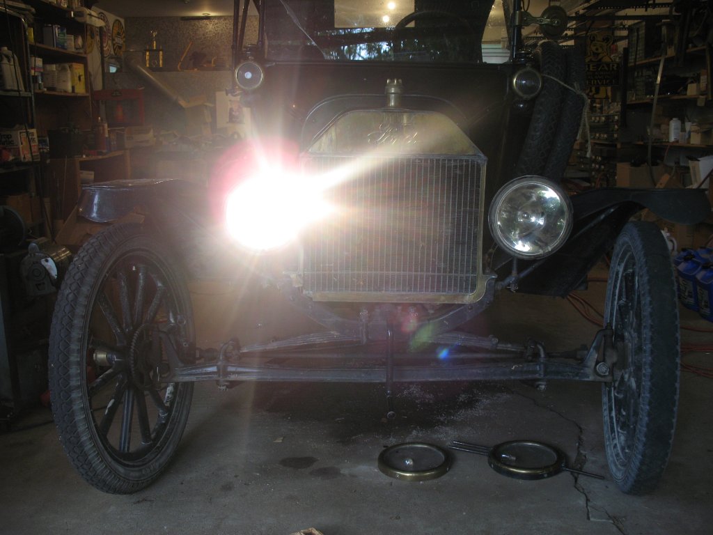

Wired the dash on the '12 Project with a push-pull switch for lights.
Nifty Bakelite type junction terminal is old time part, likely from the 'teens.
Lacing wire to the left headlamps by running them along the frame rail. On the right side used a 5 wire timer loom for that headlamp.

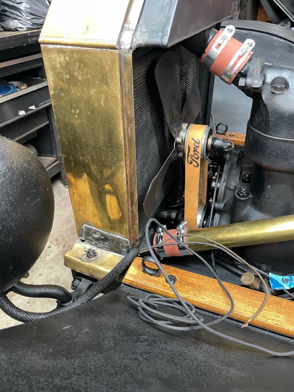

I pulled the engine out of my 26 roadster in July of 2021. Today, I finally finished installing the rebuilt engine, rebuilt steering column, new radiator and new wiring. It fired right up, but I have oil leaking out around the petcocks on the oil pan. I will address that when I change the oil.
- Posts: 5245
When you pull those pet cocks look for evidence that the magnet screw ends are making contact. New longer screws and/or worn threads allowing the petcock ends to go in a bit too far can be an issue. Of course you would expect some noise if there is contact. I have seen a petcock unscrew itself from contacts.Scott C. wrote: ↑Sun Sep 18, 2022 9:51 pmI pulled the engine out of my 26 roadster in July of 2021. Today, I finally finished installing the rebuilt engine, rebuilt steering column, new radiator and new wiring. It fired right up, but I have oil leaking out around the petcocks on the oil pan. I will address that when I change the oil.

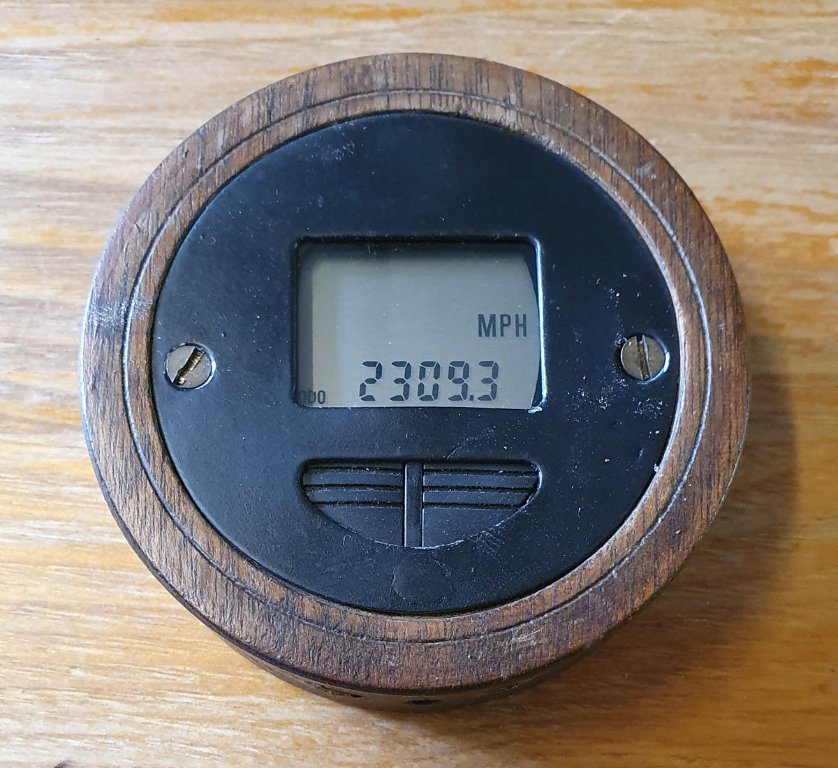

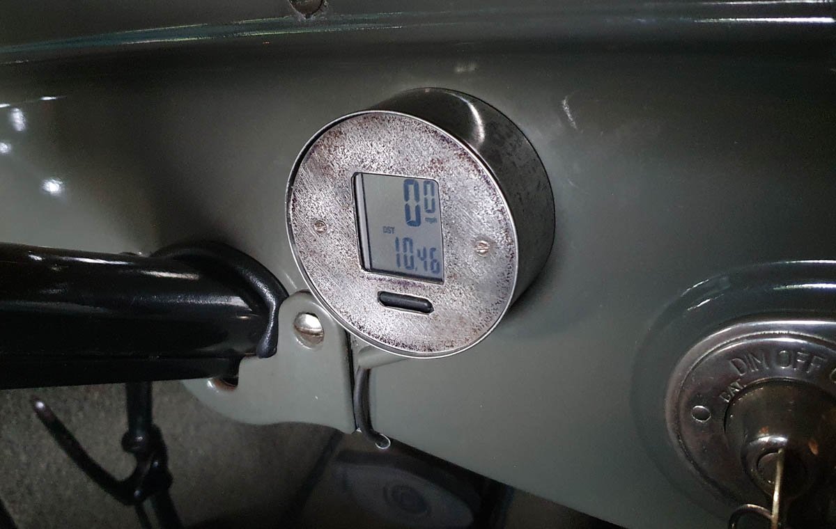

Time for a new speedometer for my '26 Coupe!!
I have been driving with a bike speedo in a wooden case for 20 years (photo), but found the trip miles hard to see.
So this month's project has been to make a better one.
I found a Cateye Velo 7 which has large clear numbers. It can be programmed to the nearest cm of tyre circumference, and it also allows you to input a total mileage figure, so you don't have to go back to zero when the battery is replaced.
The core is wood, the outer casing is part of a tin can, and I cut the front from thin steel. All laquered.
I kept my old mounting - a triangular plate which clamps behind the steering column bracket - so no holes in the dash.
I kept my old sensor - a reed switch in a brass tube on the left front hub with a 2-core screened cable which I connected into the new base.
The 2 screws on the front allow the front and case to be pulled off, and then the instrument can be slid upwards to change the battery.

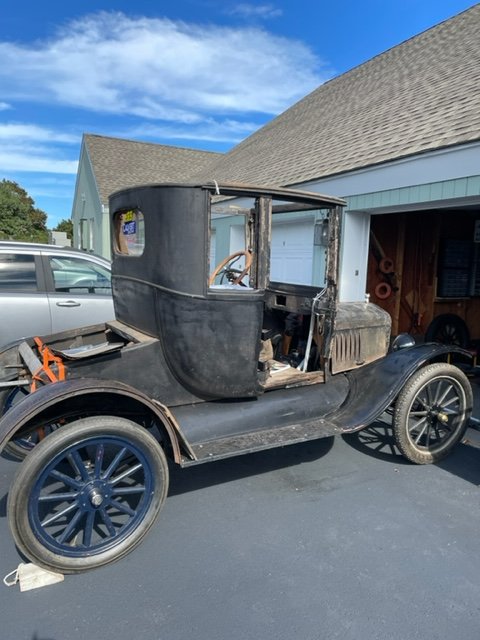

Now that the Coupelet is home, I got it out in the sunshine to do a little garage cleanup, As an update, yes, this is the same Coupelet I got in May of 2017(see meet Clara my birthday present, May 2017 thread). The body is now on a correct 1918 chassis with an August '18 engine. She runs and is drivable. Still a long to go but is slowly getting there. George

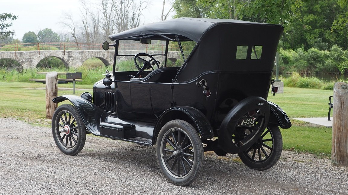

Saturday was a perfect day to go for a ride, so 2 of us from the Dairyland Tin Lizzies went to the Steam and Gas show in Calumetville.
We stopped at a Amish bakery, a goat farm, and an old stone arch bridge along the way.

At auctions and swap meets over the years I've bought a few dozen bulbs that fit magneto headlamp sockets. Not all were intended to be used for magneto lights, but most will serve to varying degrees. One requirement, with the lights connected in series, is that both bulbs be similar in resistance. If they're not, one will be bright and the other dim. In some cases, one will be very bright (and my burn out quickly) while the other provides a ground but doesn't light up. One of the bulbs in my car burned out yesterday, so today I tested bulbs looking for a replacement.
The ideal combination is two of the same bulb.
I decided to make a mag bulb tester that will work from a battery so I won't have to run the car for testing. None of the local parts stores had the proper sockets, of course, so I have to wait for a pair to come from the internet sometime next week.
From reading you might think that mag bulbs are likely to last only a few hours or a few days. But the one I have to replace was in the car for at least two years. I don't usually shut off the headlights. When the car is running they're on. So this pair got over 4000 miles of use before one of them went.
You may see magneto bulbs offered by one of the parts dealers. Pass. They're 24 volt bulbs, too dim for actual use. Display only.

Steve, I'd think 2 bulbs in a series circuit would give the same brightness unless they were different wattage bulbs or made for different voltages. For instance, with a 6 volt bulb and a 12 volt bulb of the same wattage in a 12 volt series circuit, I'd think the 6 volt bulb would be very dim and the 12 volt bulb would be close to normal brightness. Your battery test rig may shed some light.
