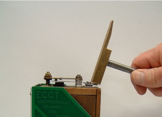

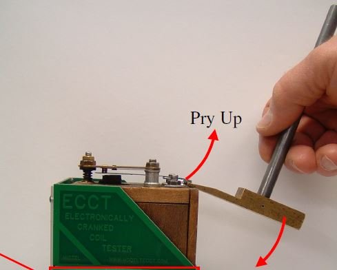

Here are a few examples on how the coil adjusting tool is used. The goal in adjusting Model T coil points is to set all coils for equal and consistent firing Time.Exactly how is it used in the adjustment of the spark coil?
Tap down on the rear vibrator spring to increase the dwell time to fire spark:
Pry up on the rear vibrator spring to decrease the dwell time to fire spark:
Coil firing consistency may require adjustment of the cushion spring tension. Here is an example of increasing cushion spring tension. Note that there is a sweet spot. Too much cushion spring tension is as bad as not enough tension.
Here is a modern version of a 3 in 1 coil adjusting tool I make that combines all 3 functions in one handy tool:
More information on Model T coil testing and tuning can be found in the MTFCA Webinar #2 here: https://youtu.be/RYcGD-8Ol3s?t=364

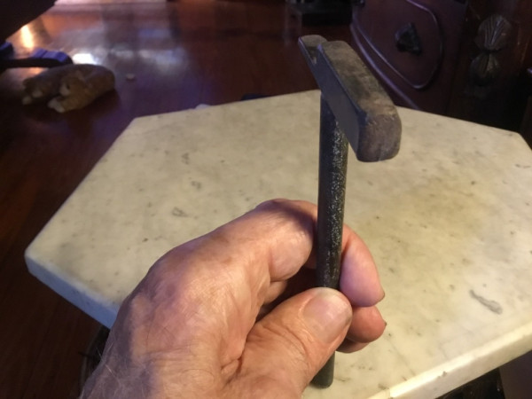

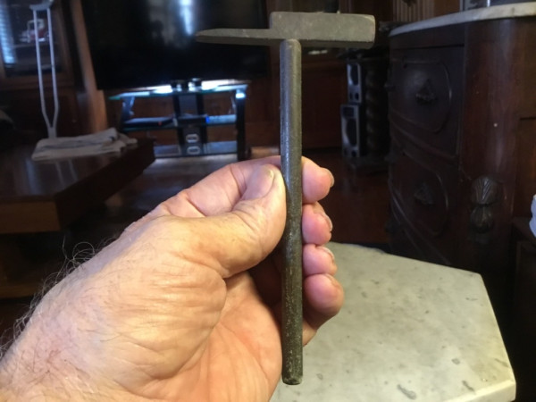

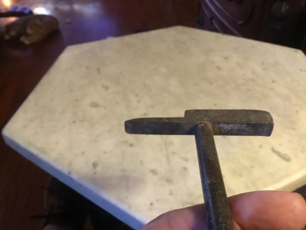

Here are a few more.

So now I'm wondering if the hammer I got from Lang's has the handle installed 180 degrees backwards OR that original hammer handle came off and was reinstalled backwards...

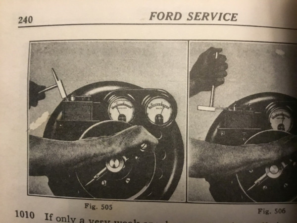

I went through my books and found a couple of pictures of the tool in use on page 240 of the “Model T Ford Service Manual”. Jim Patrick

Well, that settles it, the repo version is built backwards with respect to the original.
Go figure. At least that makes the repo coil hammer easily identifiable as such.

That hammer in the Ford Manual is with an Allen Hand Crank Coil Tester and was likely supplied with each one sold.

The repro one Mike is showing is the type currently being made and sold.
The handle is steel and just kept in the brass hammer by a small roll pin.
The ones Bob made had a brass handle that was threaded and screwed into the brass threaded hammer head.
The head was threaded, but not quite all the way through, just like the original.

. Maybe this previous post will help you to use this tool, although it is a modern improved version.MKossor wrote: ↑Mon Sep 19, 2022 2:52 pmHere are a few examples on how the coil adjusting tool is used. The goal in adjusting Model T coil points is to set all coils for equal and consistent firing Time.Exactly how is it used in the adjustment of the spark coil?

Any Ideas why the modern reproductions have the head upside down? Maybe it could be for copyright reasons, or ease of use? I do not know- I have never used or seen one.
