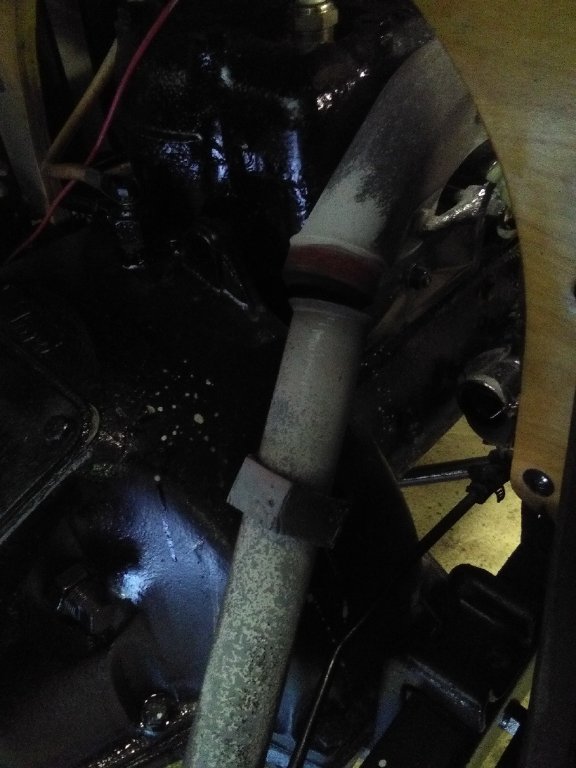

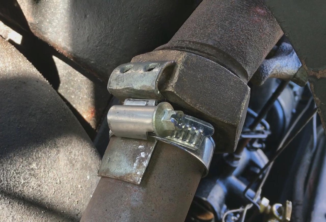

Attached are 4 photos showing two methods we use to keep worn exhaust pack nuts tight. The first is with a clamp with a built in fold down tab, made for the purpose. This is available from the vendors. The second is a do it yourself method using a pipe clamp with a home made bracket. Tighten the exhaust nut as tight as you can, then install the clamp of your choice. Jim Patrick
