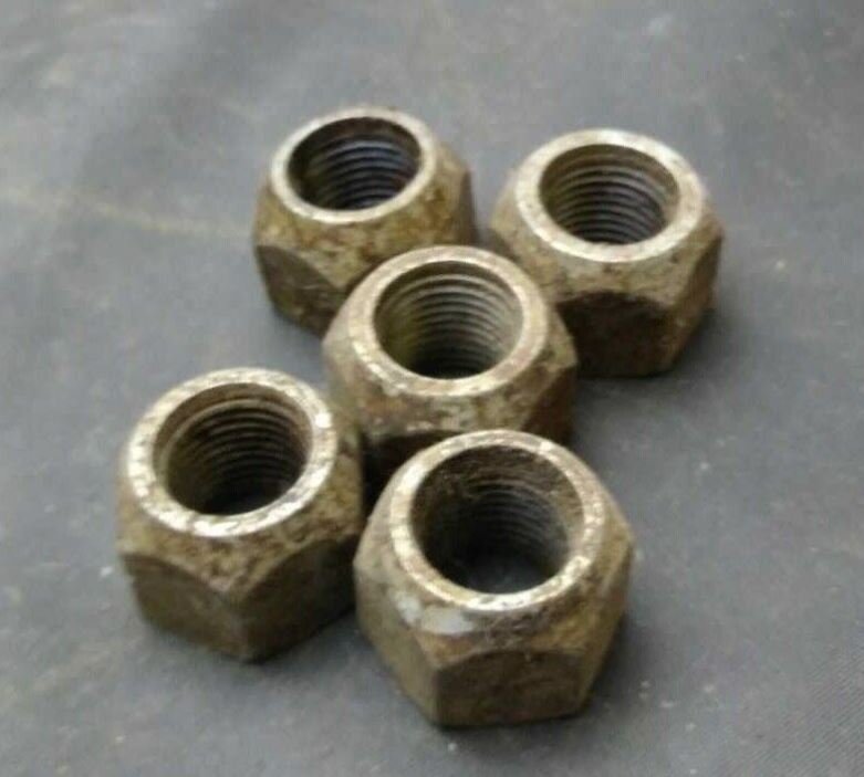

NY John T
- Posts: 443
- Last Name: Killelea
- Location: Northport NY
Re: Wire Wheel Lug Nuts - Question
The lug nuts are from WW 2 jeeps. I have a couple of them and would be interested in buying the 5 from you if you are interested in selling them. $1.00 a piece.
Thanks.
John
Thanks.
John
