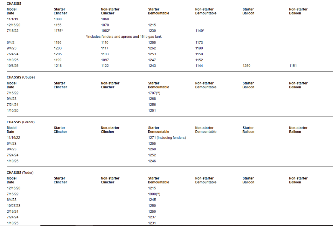

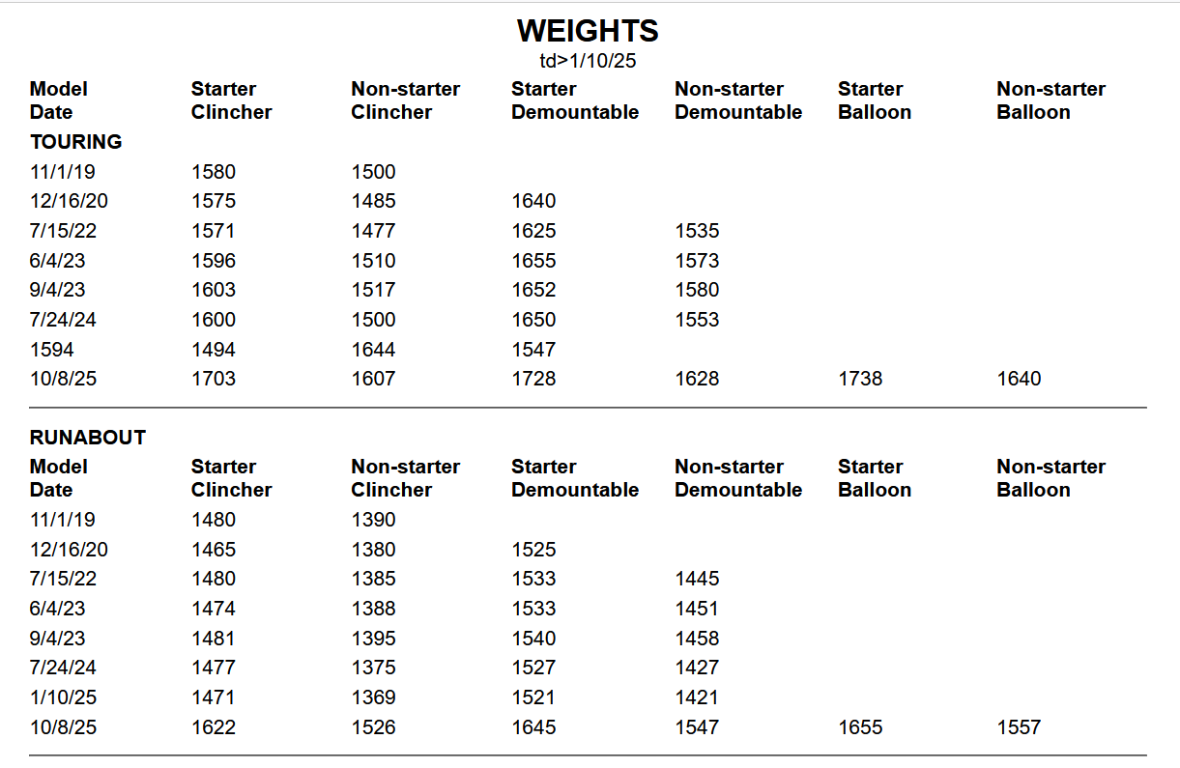

Use this link and scroll down to WEIGHTS also has car, chassis wheels etc
https://www.mtfca.com/encyclo/U-Z.htm

Skimming the tables Rob posted, there seem to be discrepancies.
Interesting !!
Interesting !!
Get a horse !
- Posts: 6577
Re: How much does a brass T chassis weigh?
Rob didn't post any tables I did and they are from the Model T Encyclopedia.Rich P. Bingham wrote: ↑Fri Oct 07, 2022 1:06 pmSkimming the tables Rob posted, there seem to be discrepancies.
Interesting !!
Can you point out the discrepancies so we can get them corrected?

I don't presume to know, this gets complicated pretty fast, but it would seem the numbers don't provide consistency. Just in the first three lines, chassis with starter and clincher rims gains 70# from 1919 to 1920.
Figures for 1922 indicate another 20# gained for fenders and gas tank. Perhaps the 1920 figures also include the sheet metal, but not the tank ??
Moving to the column of no starter, clincher rims, figures for 1919 indicate the starter and generator add only 30#. Perhaps battery is not included ? 1920 figure shows 85# for starter, which appears more reasonable for starter, generator and battery. The 1922 notation indicates a 12# gain over 1920, annotated that sheet metal and a 15# gas tank is included. That doesn't add up !
I didn't look further. It would be a thankless task to parse all this out, especially if the apparent errors come from original documents. In the day, these weights would have mattered a lot in terms of freight charges. It doesn't matter much nowadays I don't think - it's probably enough to estimate a rolling chassis at 11-1200 pounds.

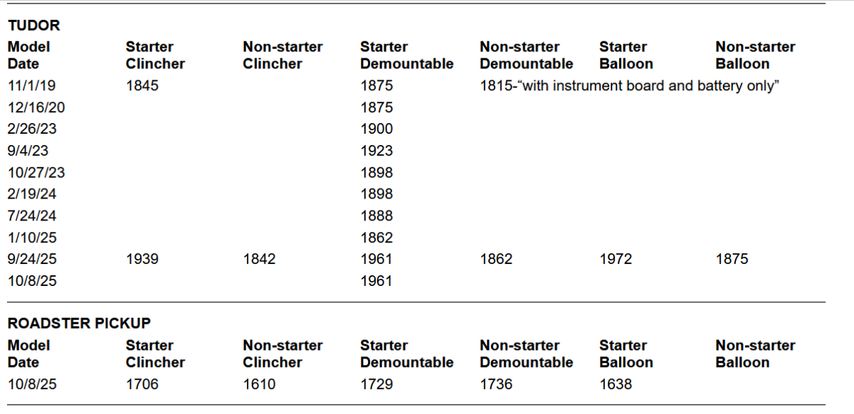

Was not offended in the least - I didn't bother to scrutinize the data since there was lots of number rounding. Best we can say - ball park numbers. I did consolidate shipping weight and there too are some strange differences - also no definition of what Shipping weight encompassRich P. Bingham wrote: ↑Fri Oct 07, 2022 3:55 pmFrank ! My sincerest apologies for the mis-identification.
Ambiguity rules!
