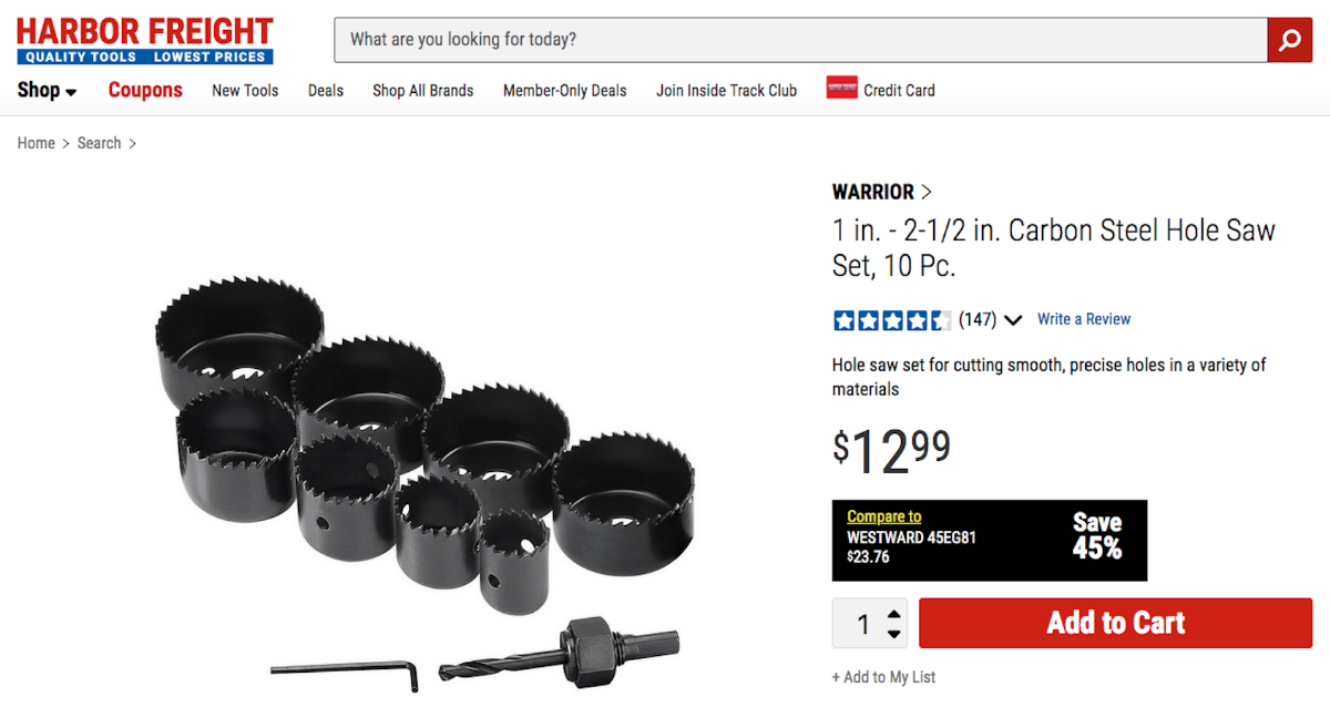

Steve Jeff, what did you use to cut the wood backing plate to the perfect diameter?

by TWrenn » Wed Oct 12, 2022 9:27 am
JohnSaylor wrote: ↑Wed Oct 12, 2022 8:45 am
If it's ok, I'll chime in here...but a good hole saw the proper size is all you need
- Posts: 4638
Post
by John kuehn » Wed Oct 12, 2022 9:31 am
I don’t know exactly what Steve J. used to cut the round plywood piece for the new day timer sand paper backing but if you measure the ID of the timer you can use a hole saw to cut a perfectly round piece out of a 3/4” piece of plywood.
You can get one at a hardware store for around $4-8.00. And you have a perfectly centered hole in it too.
- Posts: 7402
Post
by Steve Jelf » Wed Oct 12, 2022 10:15 am
...what did you use to cut the wood backing plate to the perfect diameter?
As the other guys said, a hole saw.

by JohnSaylor » Wed Oct 12, 2022 9:17 pm
Hole saw … didn’t have the right size myself but I’ll go to the store and grab one
