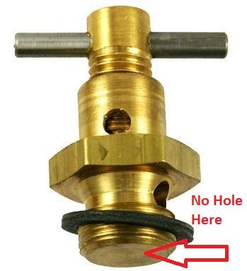

Hello William,
You might have a Holley NH bowl nut instead of the Vaporizer one in your carburetor.
The slots at the bottom of the bowl should only lead to the drain valve and not to the spray nozzle in the Vaporizer.
The nut that holds the bowl on should not have a drilled hole in it that leads to the spray nozzle in vaporizer but does in the NH.
Here is a photo of the vaporizer one without the thru hole I'm talking about.
When the correct nut is installed all gas regulated by the adjusting needle. With the wrong nut installed the gas can bypass it from the bottom and will always run to rich.

I understood that the 6286 orifice is fixed, has no adjustment, and all that can be done is to richen the mixture with the dash adjustment if the engine is knocking or on a heavy pull.
Can the dash adjustment be used to lean the fuel mixture that goes through the 6286 orifice? What is the procedure for this? It may be my false assumption that the mixture is fixed at all times to the FORD engineered level, and the only variation is through the air damper that adjusts itself based on throttle opening to increase or decrease total mixture supplied.
My problem is that both the owner and myself thought we had the dash adjustment turned closed, and therefore we have a problem with excessive richness, depositing all the carbon soot in the carb.
I think I may be missing something here. I checked the orifice size in the 6286 insert, and it is .0625, or 1/16th of an inch in diameter. The part is brand new.
If this is the entire cause of the rich running condition, I can easily make another 6286 insert, with a diameter of .050" or .055" to reduce the rich mixture to a more economical and less soot producing level.
In a vaporizer the fuel mixture volume is not regulated here. Fuel flows in a very rich mixture until the chamber under this jet is used up & the fuel is then precisely regulated thru another jet. This creates a rich mixture for starting. (6283) also .062 orificed, but regulated down by the mixture adjusting needle. (the same way fuel mixture is regulated in a NH thru 6286/6214B)
The fuel to run the motor is dependent on regulated fuel thru this separate jet. As with a NH, closing the needle adjuster down to a complete seat closes off fuel & the motor will die. If the motor doesnt die, you are getting extra unregulated fuel thru a defect in the circuit or your needle is not seating fully.. If the motor will still run with a "normal" setting, it would run rich. Make sure the needle will go in all the way to completely block this jet orifice.
Changing the orifice in 6286 would only mess the system up further.

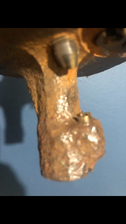

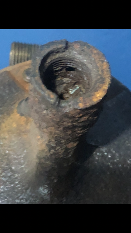

On an NH the fuel flows freely through a hole in the casting directly below the spray nozzle into that cavity and the spray needle regulates how much gas can come out of the top of the nozzle to mix with air. A leaking, nonexistent or a new gasket stacked on an overlooked old gasket can cause gas to leak past and the spray needle won’t be able to meter the gas because it has 2 paths to follow.
The same hole is there on the vaporizer but the fuel flowing into this hole is regulated by the fuel adjustment needle which meters the amount of gasoline flowing into the cavity under the spray nozzle so even if the gasket there is bad, only a certain amount of fuel should be allowed in and screwing the needle all the way in should shut off the fuel coming from inside the bowl and it should die.
It seems like there would have to be a hairline crack in the body or the threads not sealing well where the nut screws in. If the threads were that bad it would more than likely strip before it tightened sufficiently. Those 2 slots in the bottom are for fuel to flow to the drain and started with the center drain NH’s.
