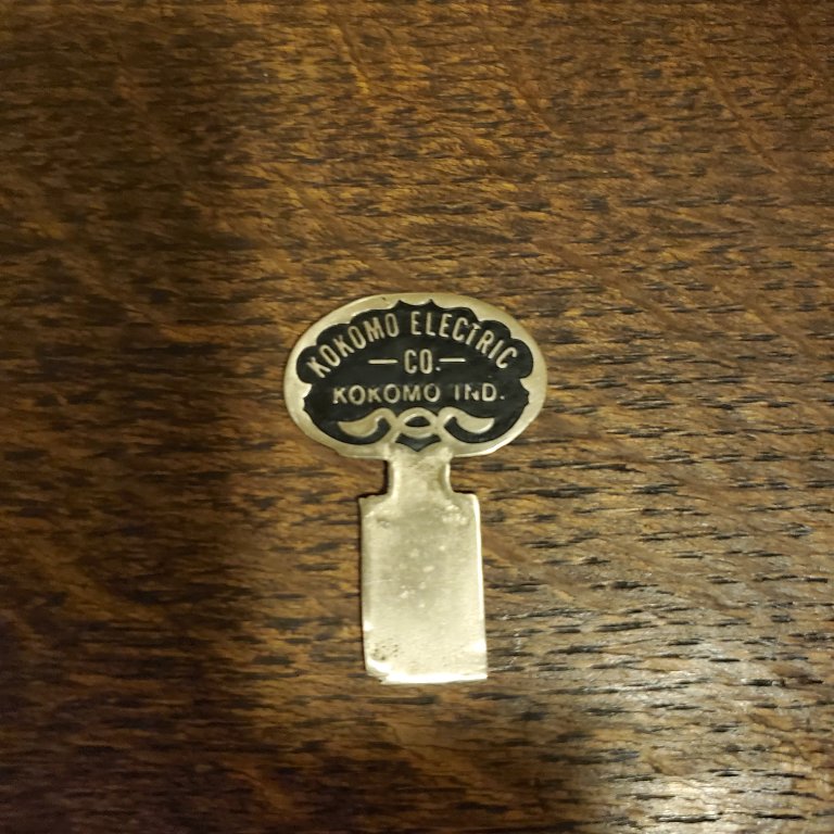

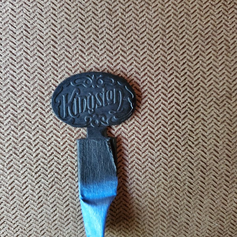

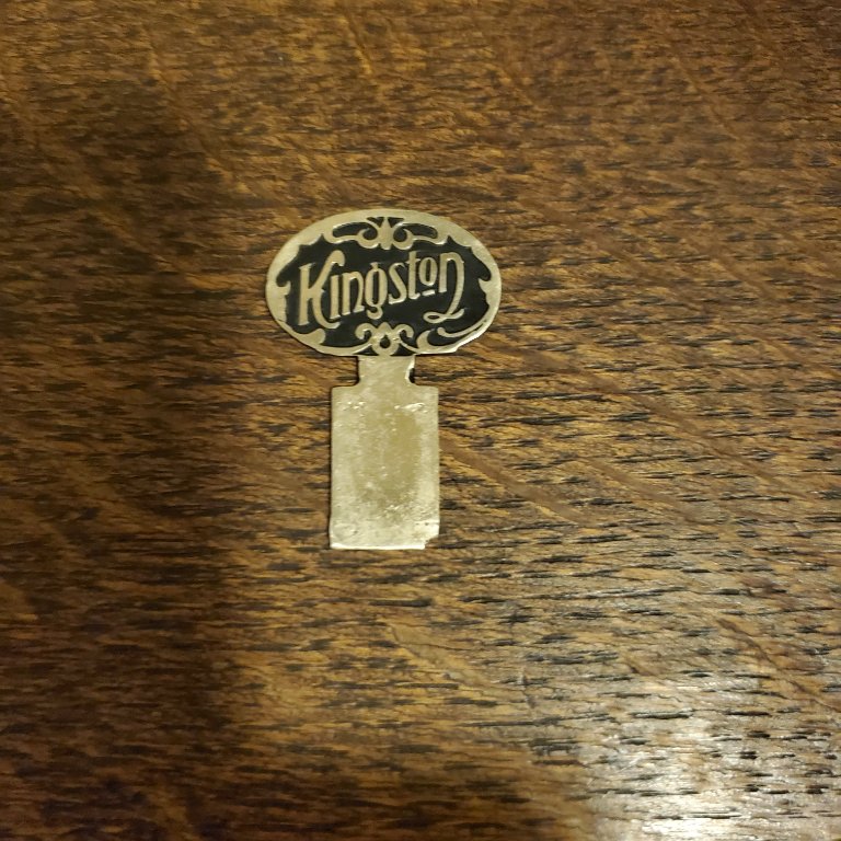

I received a request to upload photos of embossed pieces I painted by using 400 grit sandpaper wrapped around a nail to reveal the high spots.
