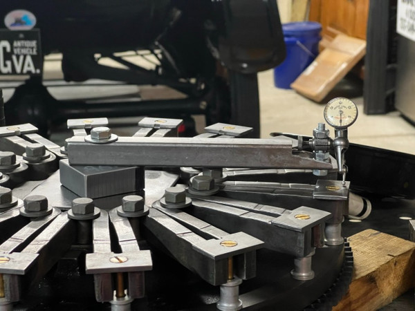

I've been reading the tons of posts on the forum about setting the brass screws for the magnet retainer plates. Folks discuss having the plates all in the same general plane and within a certain tolerance of each other in that plane. I've seen where folks say not to tap down the plates to adjust heights because of killing the magnetism of the magnets.

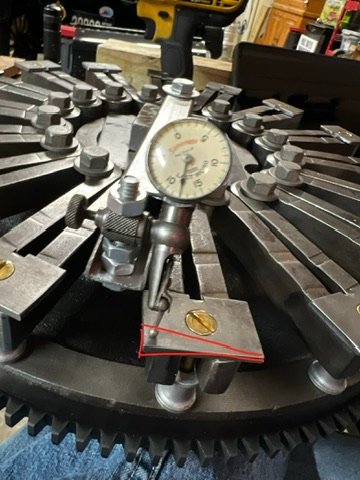

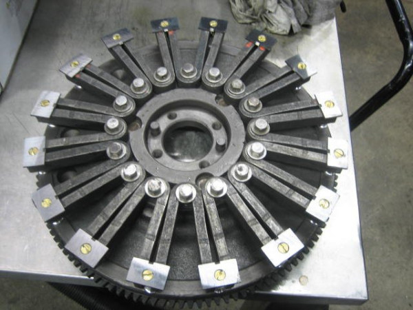

With mine, I have all new retaining plates, screws, and spools. The magnets were recharged.
I made a rig to see whether the plates are at about the same height
But when I ran the dial indicator over the pieces, I was surprised that there was a 'slope' across the plates.
I'm guessing this is due to the magnet thicknesses. This can be quite the difference in height too. I decided to take some time and went around the set of plates and measured the height from the back side of the ring gear to the top of the plates (on both sides) and found that these have a big difference in some places (or what I feel is a big difference)
Is this something I should be worried about and if so, how do I fix it? I tried sanding/grinding off one side of a plate for S&G. Is that a bad thing to do?

Re: Magnet Retainer Plate Level on Flywheel
The new plates aren’t really made right. You are better off using good used ones.

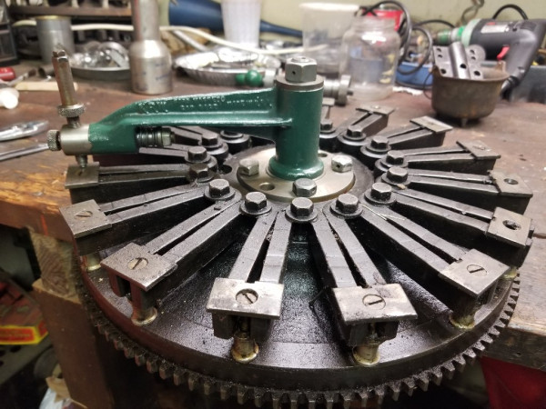

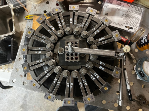

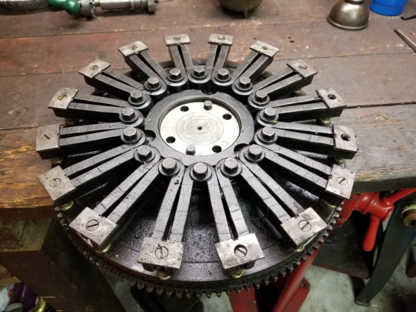

I measure the thickness on the spools, magnets & keepers & try to mate for even height. Real shorts I might add a .010" shim washer.
Heights still need tweeking.
To adjust (lower) the height I use a big C clamp with a thick hardened washer as a spacer to protect the screw on the back side. I have broken a few aluminum thimbles. Goes with the territory I guess.
Yes, its a pain & time consuming job. I dont mind for my own motors. Yea fun.

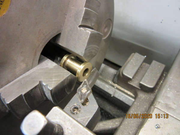

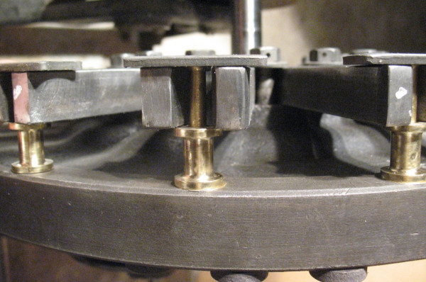

Max ,I turn down the Support Spools if they are to high .
And always use old plates . Toon

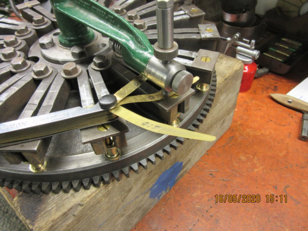

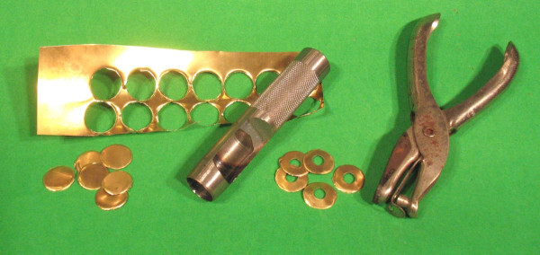

The gap between the plates and the field coil is supposed to be .025" - .040". I guess if everything is within that .015" spread it's good enough. But I prefer to match magnets for thickness and raise the low spots with shims under the spools to get as much of each plate as possible near .025".

Hey Steve, I saw where you posted the shims a couple of weeks ago. It prompted me to buy some brass shim stock so that’s where I got the idea to make them. Many thanks!

...are those brass spools???
Yes. I don't see anything in the encyclopedia about when they changed to aluminum, but they were brass at least until the mid-teens.

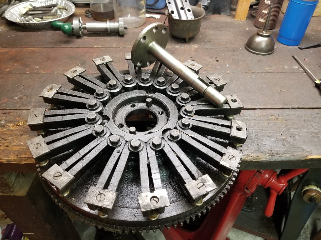

I spent a lot of time matching the magnets, spools and plates. In the end, the plates are within about .002 inches of each other. I set the minimum air gap at .020 in. After 8000 miles the engine starts very easily on mag by hand cranking.
Some people randomly assemble the pieces, then true the surfaces in a lathe.
Art Mirtes
Art Mirtes

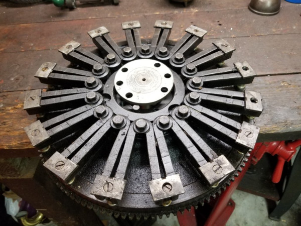

If you want perfection, do all the shimming, tapping, pole swapping and magnet matching to get things as close as you can, then have the flywheel machined as you would when surfacing the clutch face on a conventional flywheel. That will clean up any discrepancies in height as well as any tilt in the keepers. There is no need to go any further than finding a grinding register on all 16 keepers. You do not need to get a full surface grind on every keeper.

Wouldnt that make for metal fuzz everywhere on the magnet surfaces? Tough to clean up off fully charged magnets.Allan wrote: ↑Sat Nov 12, 2022 8:06 pmIf you want perfection, do all the shimming, tapping, pole swapping and magnet matching to get things as close as you can, then have the flywheel machined as you would when surfacing the clutch face on a conventional flywheel. That will clean up any discrepancies in height as well as any tilt in the keepers. There is no need to go any further than finding a grinding register on all 16 keepers. You do not need to get a full surface grind on every keeper.
Its not that difficult to get .005 max variation with a krw type tool.
The thing I use is a rod on a D/S inner sleeve on a trans center shaft. In the wrist pin is an adjustable bolt that floats over the keepers. With a little downward pressure I go around & adjust until contact feels the same on all keepers. I think I get no more than .002 variation when done.
Good enough.

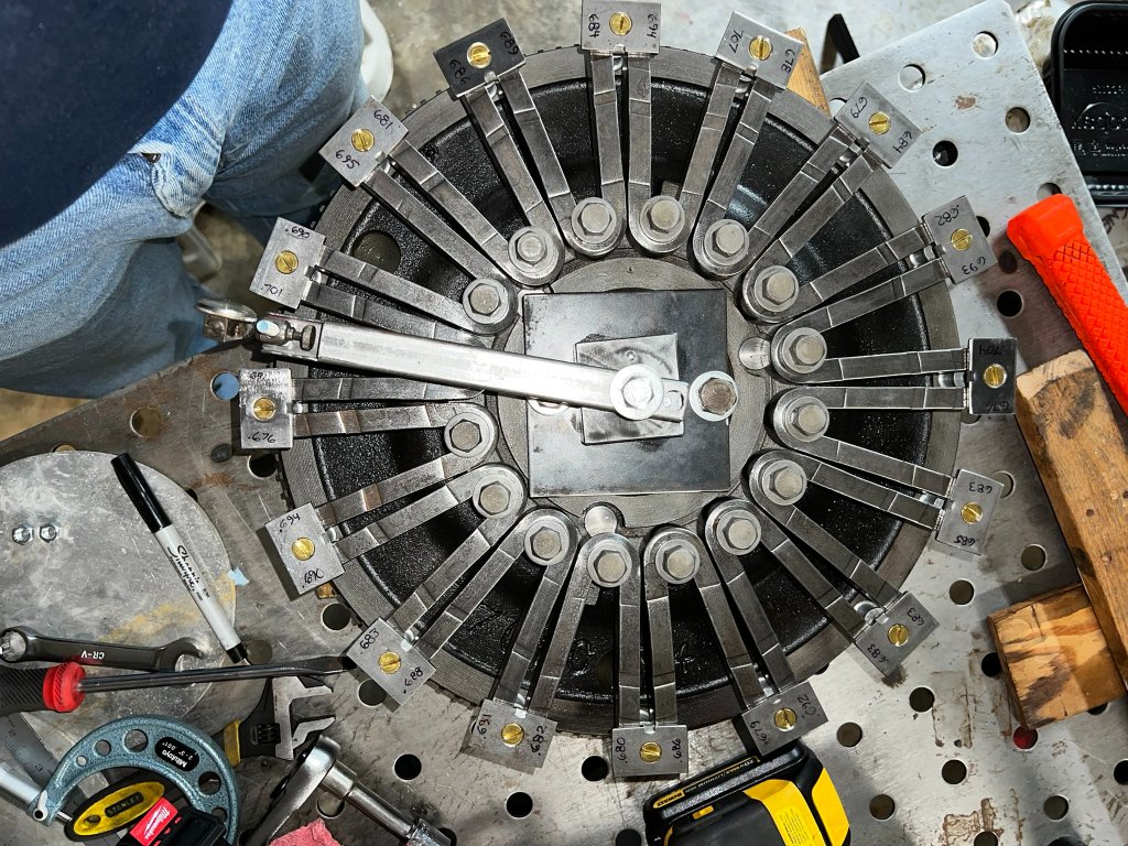

Because of the variety of magnet thicknesses, I would think he would have to map all of the parts to make sure you put them back in the same place.
I believe machining the face of the whole assembly is overkill. Using shims I get a variation among the plates of less than .005". I call that good enough.

[quote="Steve Jelf"
For the people that want the best for their Model T, it's not overkill.
We resurface both flywheel and the mag field so that the T gets all the power to the wheels it can.
Free starts aren't uncommon.

Okay, here’s an update. After not trusting my tool, I went through the process of measuring the total height from the back of the ring gear to the top of the retainer plate.
I’m pretty happy with where they are height wise, but managed to buy a KR Wilson tool on eBay. So I want to do the check with that.
Small problem though. When I try to put the KR Wilson tool in the opening of the fly wheel, it drops down on the pins in the fly wheel, but gets stuck about halfway down. I’m not sure whether I should expect an interference fit or whether you would normally take those pins out and then bolt it down.
Any thoughts?
Any thoughts?
- Posts: 5490
You need to space out the base of the KRW tool - I cut the shaft off a T transmission shaft & use the flange as a spacer - works perfect.
- Posts: 6722
Max
Steve is correct. Now you need to ask "why is that?". And then start doing some research on the forum for how to ACTUALLY use the KRW tool...it does more than just check keeper level(s), and to just tell you WHAT it does without a full explanation of HOW it does it would be a disservice to you. It's a pretty ingenious gizmo.

Many thanks guys!
I’ve been reading the forums about the use for not just the magnet side, but the field coil side. I didn’t realize it was able to help calculate the space between the field coil and the magnets [that but figured it had another purpose since it could rotate].
I have at least one water transmission shaft that I can play with.

KRW mag gage?? Seems to me I saw a Service Bulletin on that thing somewhere. Where did I put that thing?
Sean Butler
- Posts: 180
- Joined: Sun Jan 06, 2019 12:22 pm
- First Name: Sean
- Last Name: Butler
- * REQUIRED* Type and Year of Model Ts owned: 1911 Touring
- Location: Huntington Beach, CA
I think I've got your back, Dan. While the Service Bulletin never instructs to use a tranny shaft as a spacer it does allude to it as seen in the highlighted text on the second page. Also, be sure to verify the trueness of the bottom of the flange on the KRW gauge. I have a repop gauge and the flange was off just a hair and needed a cleanup cut to get it true. Click on the photos and they should show larger.
Sean Butler
- Posts: 5421
- Last Name: Hatch
- Location: Alabama
Read paragraph 2 of Service Bulletin.
“ Make sure transmission shaft is clean and free of nicks.”
They are expecting you to be doing this on complete transmission.
Also floating around somewhere are the instructions for setting the mag gage. Where did I put those?
Good thing my shop is just one room!!!

Good catch, Dan. The following link has Ron Patterson's info on calibrating the gauge:

- Posts: 5161
You dont have to have a complete transmission, but you do have to have a center shaft installed.Dan Hatch wrote: ↑Mon Jan 23, 2023 3:18 pmRead paragraph 2 of Service Bulletin.
Good thing my shop is just one room!!!![]()
Speedy,
The trans shaft flange goes between the crankshaft flange and the flywheel. It is needed. I only put one engine transmission together and that is what I remember.
Art Mirtes
Art Mirtes

- Posts: 5161
Thats basically what I said. The trans shaft has to be in place, but the rest of the transmission need not be.

Quick demo with the closest (and dirtiest) "props" at hand.
Sean Butler
- Posts: 7156
I parted the flange off a worn shaft so that I do not have to work around that obstruction. It makes it easier to work on the flywheel on a bench.

That's what I posted a few days ago !
