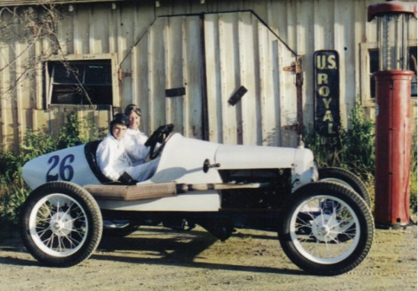

35 Ford trans originally in backward behind a counterbalanced drilled t crank, roof head, etc . . .
Picture circa -roof, degraded to rajo -crank, degraded to stock T but I believe the trans hadnt been degraded to the ruckstel yet"Those who fail to plan, plan to fail"

Oh, that just looks too cool!babychadwick wrote: ↑Mon Nov 14, 2022 8:52 am35 Ford trans originally in backward behind a counterbalanced drilled t crank, roof head, etc . . .
And I also happen to have a complete 1935 rolling chassis!
