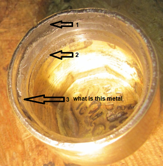

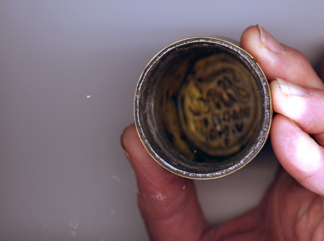

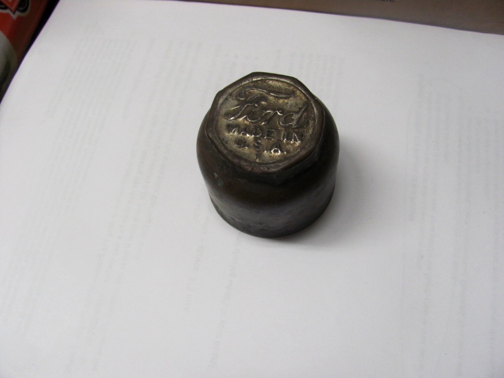

I have a Model T Ford hubcap. It is cast brass, not stamped. it is heavy. The Face is embossed :Ford (sript), MADE IN U.S.A., with the letter I for the manufacture. there no threads. It is larger in width. but the inside is thicker a ways down and that width is the same as a regular T cap. It is used with old hard grease. I will take some photos. Does anyone know the use of this hub cap?

Good morning ..... can pictures be posted on this hubcap , a couple views so we can join in

There are no threads, yet it is used and has hard old grease. I wonder how that was achieved?
On my Henrietta, the two front hubcaps are aluminium castings, with no Ford script. Interestingly, they are not the same.

Larger in width may indicate a TT hub cap.
Could be a more modern reproduction in the raw, cast and internal threads never cut.

With no threads, I would sure like to know how it stayed on a wheel to get hard grease in it? Maybe an unfinished repro used for a grease cup on the work bench? I have an ugly old T hubcap I use for that. Maybe something someone used on non-T wheel for maybe a trailer behind their T? (I am grasping at straws here!)
Back in the 1950s and '60s, a lot of people were doing brass and aluminum casting in their home shops. Almost anything is possible? I have seen quite a few cast brass hubcaps made for model Ts and other era cars back then. They were usually a bit heavier than the spun or stamped hubcaps they were made to replace. But for non-Fords with no original or repro caps available, it was what was done!

It is well used. The face is nickle plated. The rest in brass. The body has small dents and is dark. No threads. The grease is old and hard.

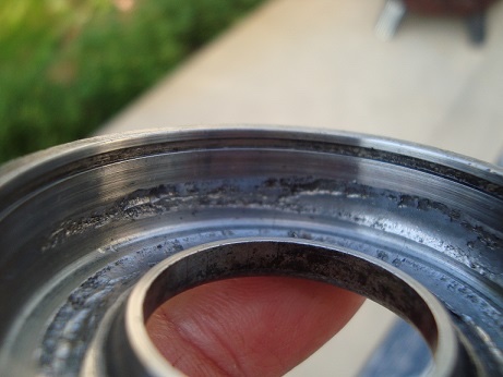

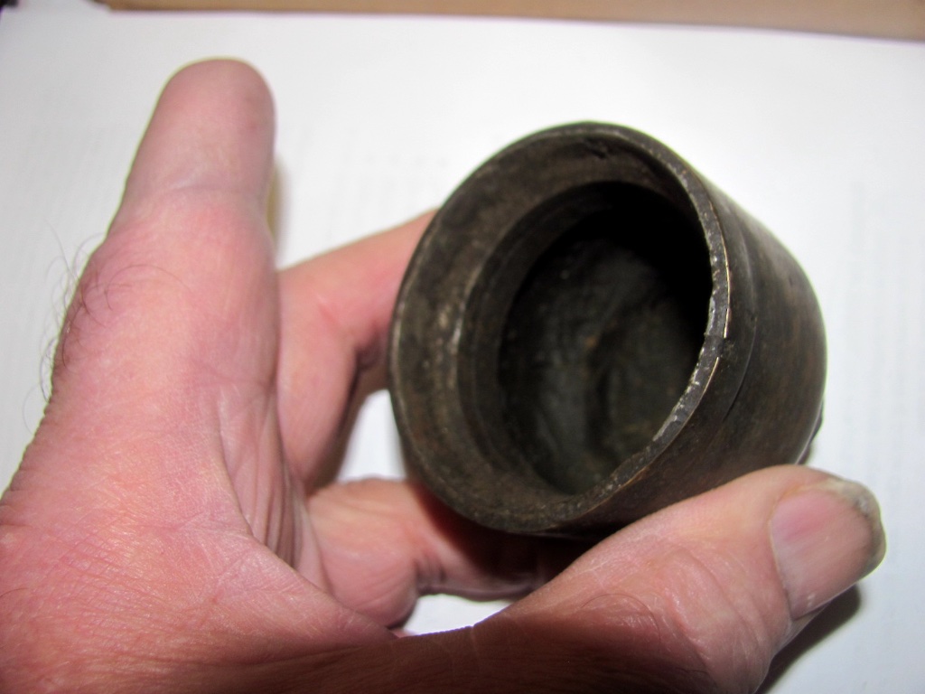

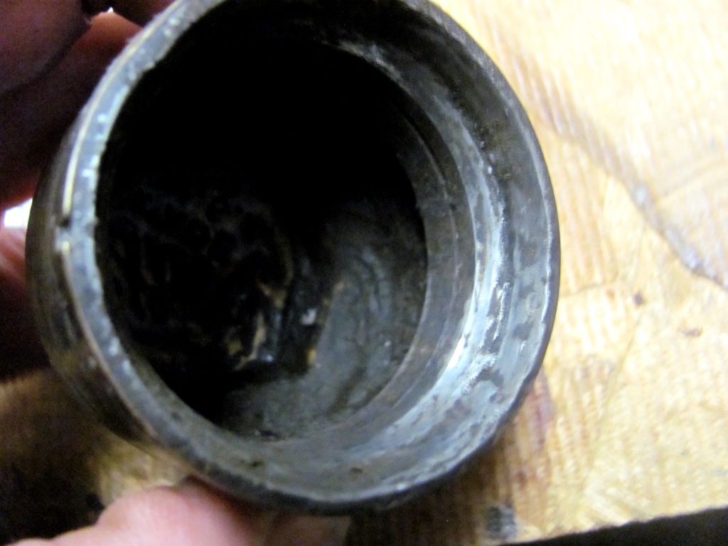

There is a shallow ring grove in the surface where the treads should be. Perhaps something snapped into that grove to hold the cap on. This cap is not home made. It is a production piece.

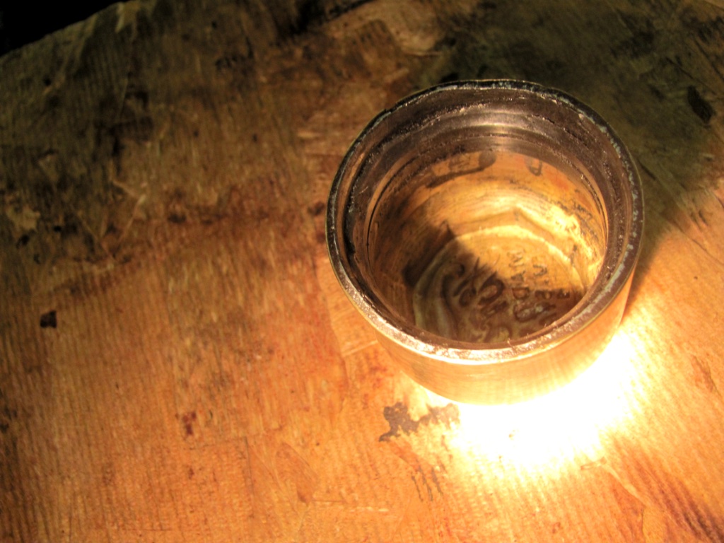

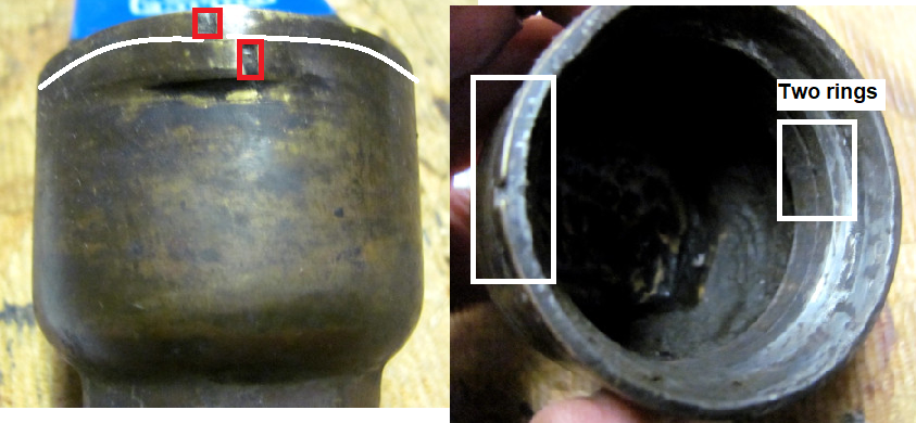

There is something strange about that hubcap. Is something broken off inside of it? It is definitely a late style hubcap, so it's not valuable.
- Posts: 6553
Re: cast brass Ford T hubcap
Really looks exactly as you described. Needs to be degreased to see fine details. Also notice outer grove

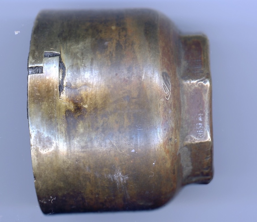

There is an outer ridge about one forth of an inch wide with the slots close together. this ridge is on one side only.

Have you attempted to unscrew the bottom piece ????????? Appears to be some sort of adapter.

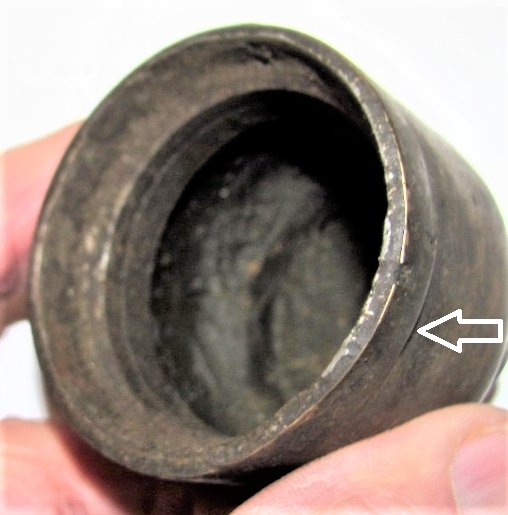

I do not remember where I foirstv found this cap. have had it for perhaps 60 years. It found it recently in a box of small parts that I have had for a long time and probably t his is the first time I ever examined any thing in the container.

That is definitely stamped, not cast.

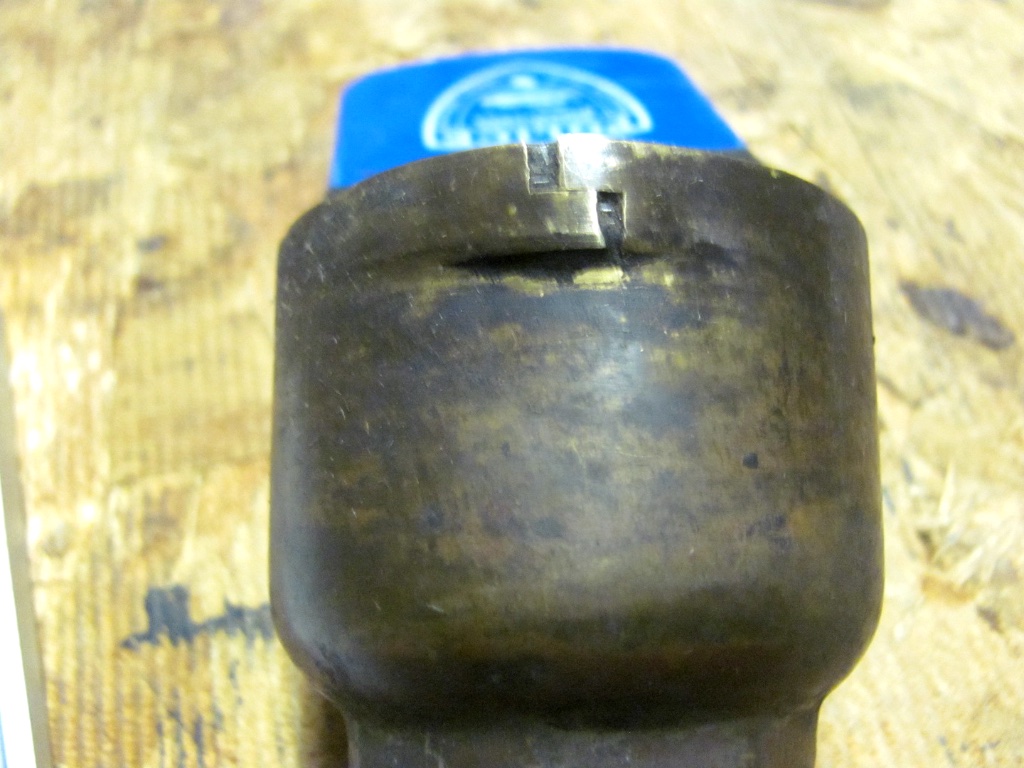

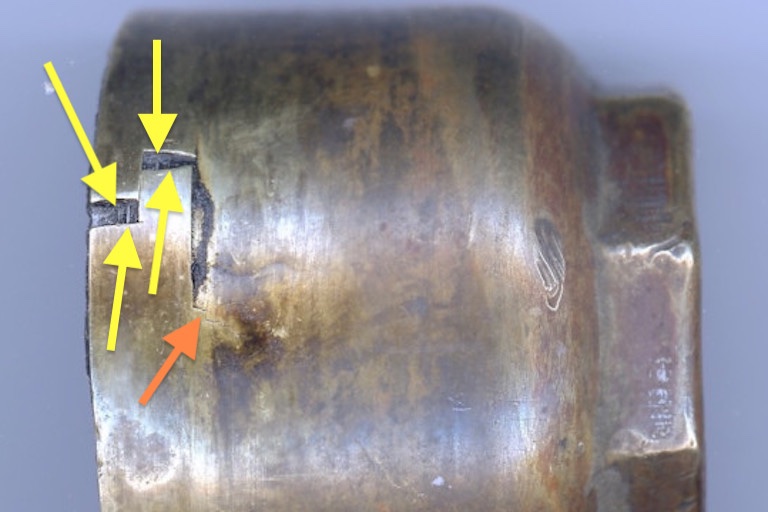

The ridge on the lip with two notches and a catch spot is unique. The inside piece is steel and is perfectly alined. The rest is heavy brass of about 1/16 of an inch thick. It is was it is and not made uo of a regular stamped Model T Ford hub cap. the outside diameter is larger than a standerd T cap. the inside piece is perfectly made. everthing lines up perfectly. The inside is not a broken off piece but an integral part of the cap. the inside piece is smooth except for the grove. never was a part of anything else, always an on purpose part of this cast brass cap.
the catch spot and notches on the out side indicate it was snapped on. Has anyone seen or have a T cap with the letter "I" just below the U.S.A. on the cap? The enlargement of the photo shows the ridge and the two notched.
A new development. While the piece is heavy and I thought it could not be stamped, it must be, at least the face, a stamped piece, for the reverse of the script and lettering show on the inside. The catch and notch could not be stamped and must have been added during the process. What we must find out is why it was made and what was the use. I will clean it, but will not polish it.

the inside piece is solderd on, perfectly. ---hard solder. the notch area was stamped out and the two notches cut in. it ia a manufactured item.

I don't believe those are notches, but instead, just gaps from the cap having been burst open.

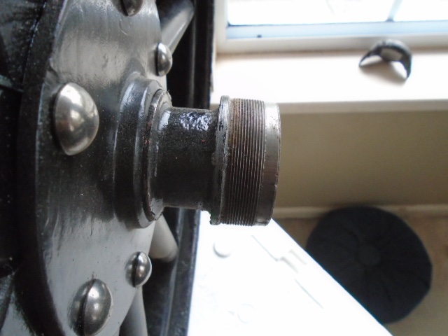

I wonder if that's not from a hub and bearing that experienced total failure, leaving part of the hub in the cap.

No and no. Those are machined slots,take a good look. This is a machined cap.

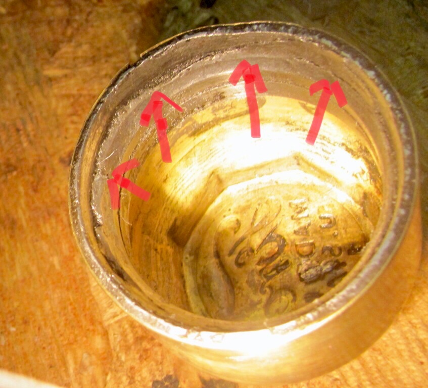

Measure the thickness of the cap beyond the ring. I think you will find its normal hub cap thick.
That last pix I see a thin brass edge next to the iron/silver ring.
- Posts: 6553
Trying to "analyze" the pieces.
There appears to be two inner rings, an outer sleeve inside a stock hub cap. However, the bass hub cap appears to have a ring around its end with some unaligned notches. I'll concede that it's soldered. If all that is true, wouldn't one expect a much simpler way to manufacture it? I am not saying it isn't just questioning it. The next question is what metal is used for the rings & sleeve and how are they soldered? Also what is the deep grove in the cap for?

With due respect, Darel, it's a pretty blurry and dark picture...Few of you are taking a good look
now, have you put a magnet on it as requested? If you have, there has been no report on that result
As for it being "manufactured", pretty much everything that is not a rock has been manufactured...this thing, to what end, who knows?
I still think its a broken hub and your hard solder is simple ductile iron...It may have even been "made" that way for some obscure purpose by someone who's idea never got off the ground (but I doubt it)
There is nothing about this that calls to me that it is a long-lost FORD item off of a Model P.

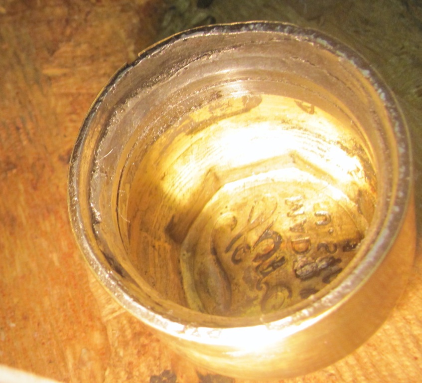

I reported that the inner ring is steel and is soldered or weld on.
- Posts: 8484
Looks like a hacksaw cut on the outside to me, just inboard of the threads. It also looks like hub snout threads, looking through the zig zag crack. The zig zag crack is odd, but sheet brass often cracks in nice straight lines. The circumfrential part of the crack may follow a thread root. I may be wrong, but from here, it looks like a Ford hubcap with the detached outer end of a hub still screwed into it. The machined look may be from bearing fragments or a rear axle spinning in the hub, or as the front wheel turned. The hub snout was probably cut off by metal debris cutting it from the inside. If I'm correct, the ring-shaped hub fragment can probably screwed out of the cap after cleaning it all up and proceeding with care

Yeah, i think you are right. I think the bearing came apart and wore it through the inside, and it broke off while removing or on the road. I suspect the cut mark was an attempt to loosen hubcap before it broke off while trying to remove.

There no cracks or cuts …the slots are factory notches just above the outside ridge for the clip to engage.

I'm pretty sure it's a regular T hubcap that went through a front wheel bearing/hub failure. Looking carefully at the front hub cross-section picture above indicates that it was a front wheel bearing failure, probably due to lack of grease.

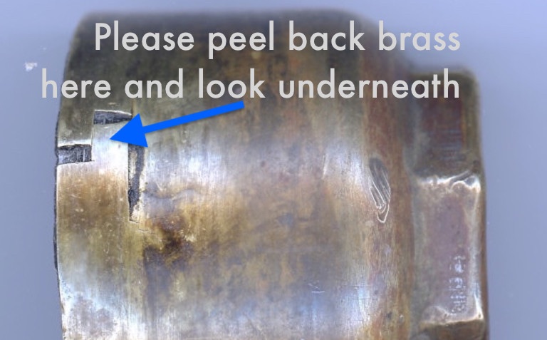

Clean it up, soak it in penetrant, then take the "insert" out, and you will see exactly what it is. (Whatever it is) If it's what you think it is, I'd guess that Dr. Pogue is behind it.

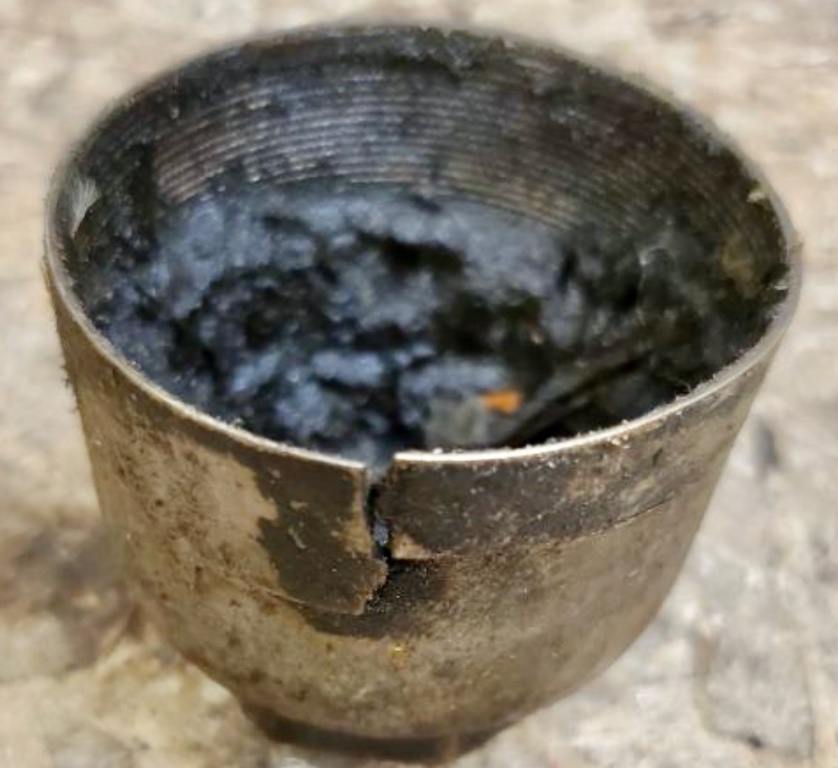

- Posts: 4057

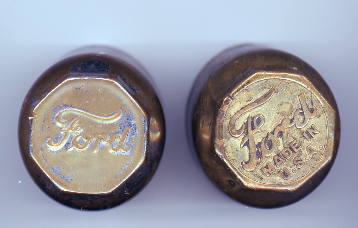

Would agree your cap is a normal T hub cap with something threaded in and now broken off.
Can see the attempted try with a hack saw to separated the cap from the stuck inserted part, appropriate guess is a busted off front hub, as the early hubs are thin at the threaded cap end.
Your cap was a front cap, as it's still full of grease, the rear hub caps never got crammed full of grease like the front hub caps.
As for the sharp 'stepped' section, with the right angled steps, that is common fracture shape of the thin brass cap at the thread line, the separations are normally step like, see this example below:

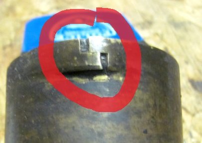

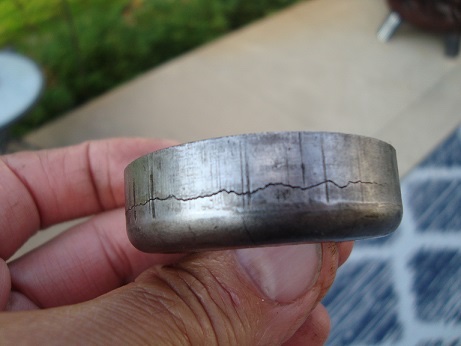

some more photos
you can now see the notches and the clip ridge. The inside view shows the weld/or solder area and shows there is nothing broken, no loose parts. No cracks, the only change on the shell are the two notches and the ridge. You will also notice that there are no threads. The threads are covered by the weld/solder which holds in the insert. The insert can not be removed without removing the weld/solder. I cleaned out the old grease There are no broken parts or sharp edges.
What I have been seeking is, what was the use of this cap? The inner ring is perfectly round with a slight grove. It was it was made to slip over a round piece. No one has been any help and no one has come up with a possible use. All the responders has done is to make great errors as to what it is and suggest is is some else than what is pictured.
so,please help and quick the joking.
Darel
Darel

Darell,
This is what I can see from your picture:
1) it is stamped, not cast.
2) it is not soldered, there are mating threads on the inner ring and on the brass cap.
3) the cuts on the side are not machined, they are breaks in the brass.
Conclusion: You have a plain, run-of-the mill, OEM, Ford, brass hub cap on a broken hub. Nothing more, nothing special. Take a hacksaw and make 2 radial cuts opposite each other thru the inner ring, punch it out and you will see it is a broken hubcap on a broken hub.
Jeff beat me to it whilst I was annotating the photo below.
The four yellow arrows point to what are most probably threads on the inner ring, much as one would expect to find on a front hub. Assuming the inner piece is indeed threaded, why would one need to also weld or solder it into place?
The orange arrow points at a further tear in the brass. This tear has a 'stepped' pattern, similar to but smaller than the stepped break closer to the edge.

you have failed again. no tears, no threads. if it a run of the mill, please picture one just like mine.
I wonder why you and the others fail so miserably.

THEre ARE NO USUABLE THREADS. THE THREADS ARE COVERED BY THE WELDING. PLEASE, STOP THE FOOLING AROUND.
Darel, for everyone's benefit, please dig a little deeper into this mysterious hubcap.
I suggest peeling back the cut-or-broken brass at this point (blue arrow) and looking underneath...
My guess is that you will find the other side of the brass is threaded, just like any other hubcap, and the outside of the steel ring is threaded to match.
I thank you for the more detailed photos in your last post, but — and this may be just the photo — I don't see any welding or soldering. What jumps out at me is torn and rough edges on the inner ring, perhaps consistent with a broken hub giving way.

I know the other side is threaded. I have stated that numerous times. I have stated that it is a regular threaded hub cap that has added ring welded on, the weld covering the threads. I can not peal back the natched area, that is the part the catch hooks on to. So I will tell all once again, this is a regular thread hub cap that has a well machined ring welded on. Take a look at the photos, they indicate what I am saying. It is a well adapted regular Model T cap that as been altered to serve a new pur pose. How many time to have to state that for you all to start looking for how it was used ?

The “weld” I believe is caused by the friction and heat of a bearing assembly self destructing -thus melting the material, so yes, it is melted and appears welded, but not in a conventional way. If it is actually soft lead solder, I would be willing to look at it closer. It needs to come apart to tell the true story. I bet that ring is the remnants of a bearing race.
Last edited by ThreePedalTapDancer on Tue Nov 15, 2022 5:17 am, edited 1 time in total.
- Posts: 8484
What looks to be solder is probably metal dust mixed with old grease.

NO IT IS SOLDER. I HAVE CHECKED THAT MANY TINMES. I just do not understand why you come up with these ideas when they are miles from the facts.

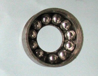

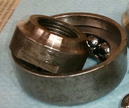

After a bit of star gazing and a couple of cold ones, I am now convinced that this is nothing more than a melted and shattered bearing race inside threaded portion of a broken wheel hub. You can see the worn track made by the ball bearings. You can also see the circular groove on the complete bearing race matches the other for reference. The groove is for a snap ring. That holds the ball bearings in. It’s not two rings, it’s just a snap ring groove/slot in a bearing race that cracked, melted and came apart.
- Attachments
- A46B2E15-AEFE-40EC-B8C0-CE700C6B1AC3.jpeg (67.29 KiB) Viewed 15212 times
- 05769E6F-A666-4743-A493-B86230D55E05.jpeg (59.9 KiB) Viewed 15212 times
- F3B36BCD-DE0C-4E88-B7A6-33E35B019F83.jpeg (46.34 KiB) Viewed 15292 times
Last edited by ThreePedalTapDancer on Tue Nov 15, 2022 5:20 am, edited 1 time in total.

They was it soldered in? Also the ring is not a bearingrace .onn

The ferrous metal ring inside the threaded portion of the cap is probably not the remains of the bearing race. It is almost certainly the remnant of the threaded portion of the hub snout. Removing it would clarify that. I don't believe you'd get a bearing race to melt in that situation. As for solder, I don't think there is any, unless someone ran some solder in a hubcap that had a bad thread. Doing that would allow re-using the cap it by simply screwing it back onto the hub and allowing the hub threads to cut threads in the soft solder. I see nothing that indicates that this thing is anything but a hubcap that was once part of a run-to-death front hub assembley. The purpose for which it was modified is impossible to determine, because it was not modified for any purpose. Ain't no there, there, as the weird lady said.

So why not try melting the solder out then remove the piece that is screwed in. I am not seeing anything of historical importance that needs saving. Pretty darn sure no one here is going to know the back story or the why's/what's going on with it, so only can make guesses based on the provided photos.

I dont see solder in the crack/joint between the hub cap & the broken off hub. I would put it on a 3 jaw chuck & unscrew the cap.

I don't think it would unscrew. The remains of the hub snout are way too far out-of-round.speedytinc wrote: ↑Tue Nov 15, 2022 10:38 amI dont see solder in the crack/joint between the hub cap & the broken off hub. I would put it on a 3 jaw chuck & unscrew the cap.
Darel,
With all due respect, please consider for a moment that you may be incorrect in your assumptions. There are a lot of folks here who have seen a lot of stuff and they all seem to agree, as do I, what the situation is. I know in my case, there appears to be no additional words that I can offer, that you would even consider. Rather than frustrate you further, I'll just become a spectator and hope that you'll find the words you're wanting to hear.

In order to resolve the issue several things must be confirmed.
The inside of the hub appears to have some layers, so can we get some information about them
1. what is the thickness of layer 1 that appears to be a sleeve or a piece of the hub.
2. if this was from a broken hub what part could this be since it would be on the outermost edge of the hub. This is the most puzzling piece
3. need to confirm what metal this is. pictures don't help others decide. If its solder then melting it would prove it.
There is no point of further discussion without some hard facts

At best someone wanted to fit a t cap on an unthreaded hub. Most likely just broken stuff that didn’t get thrown away. The enlarged photos indicate that the “machining” was likely performed with a dull rock.
Andy
