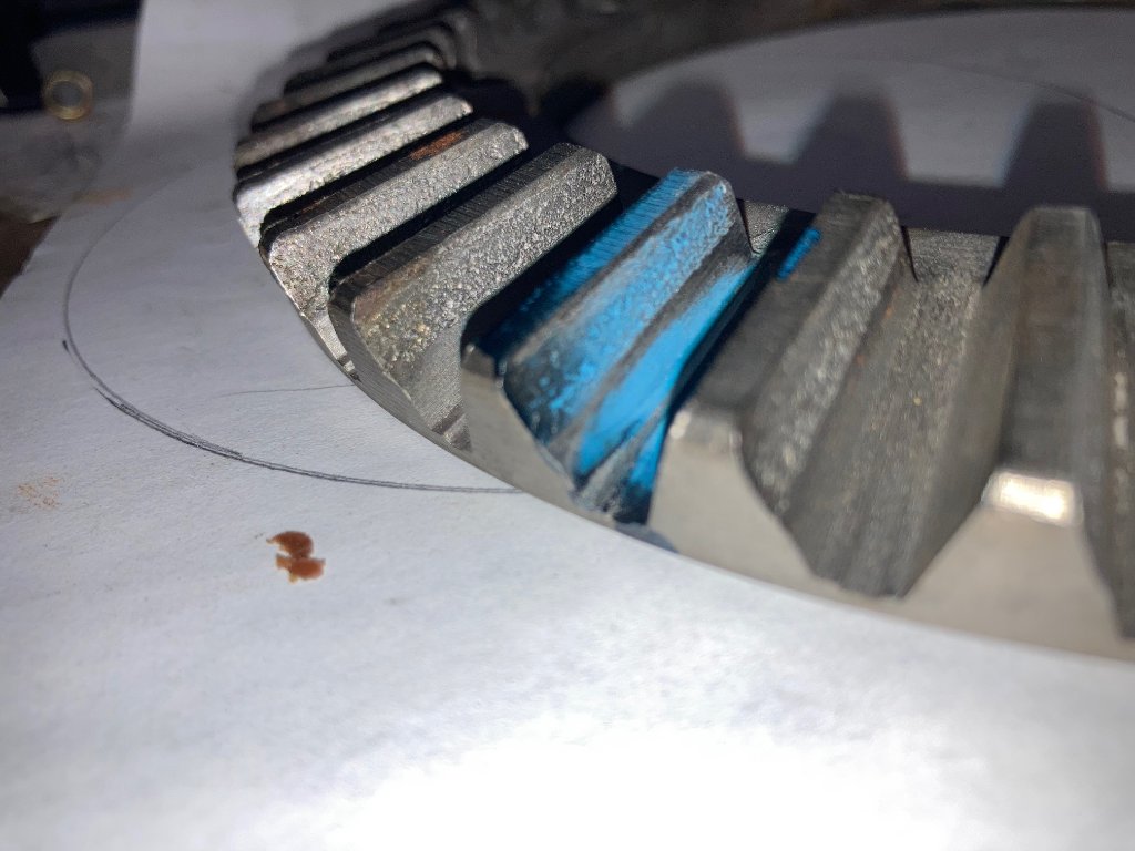

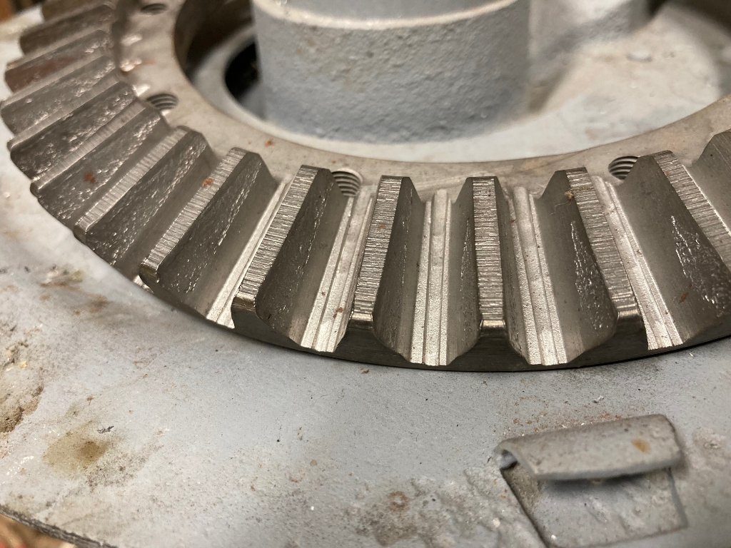

Is this ring gear okay to use?
- Posts: 5174
Re: Is this ring gear okay to use?
I would not.
The drive side of the teeth surface is breaking down. Metal is coming off. Heat treat is gone.
If some one offered this gear to me for $5, I would pass.
I have seen a lot worse working well and most times very quiet. Do you have the matching Pinion? For the amount of miles your most likely to travel and if you infact have the Pinion I would reuse it. I agree that’s it is breaking down but those defects actually hold oil! Sometimes a worn genuine Ford part is superior to reproductions and what you have may give you years of service. Just my opinion

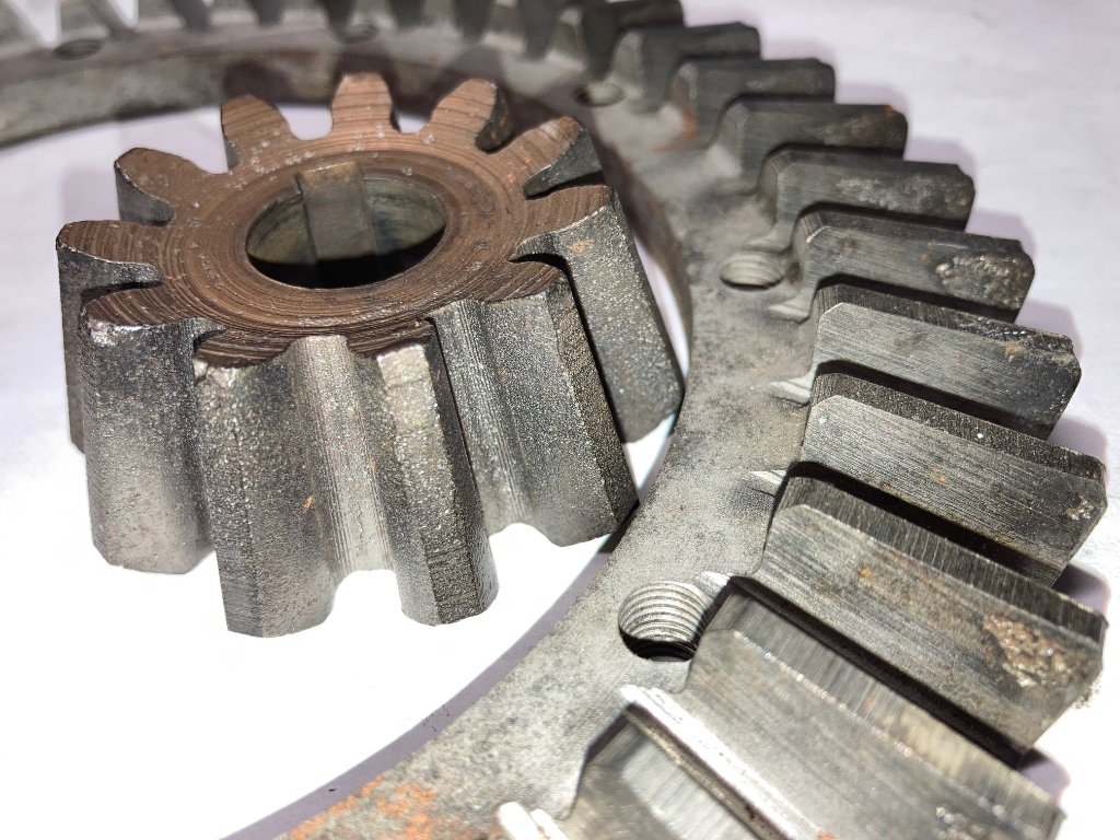

I doubt the pinion I have was used with this ring gear
When I look at ring and pinion gears from rear ends that have never been disassembled I typically see much worse.
They take a lot of abuse and still run fine. In fact the worn ones run quieter than the newly rebuilt ones.
You might experience some rear end growl because you are using mismatched parts, but there is no doubt in my mind they will function fine.
As a pointer, set them up for at least 15 thou lash. Chaffin once told me Ford set them at 25. Whether that's true or not, they run quieter at a greater lash than is usually recommended.
It looks bad to me, but evidently a number of people have had good results with gears in similar condition. It looks like the major wear is near the outer diameter. Since you probably don't have the original pinion gear, or the settings it was running at, you might get better results if you set it up to have the tooth contact area more nearly centered. I'd keep speeds and loads down for a hundred miles or so to give parts a change to wear in. A heavy gear oil might be advisable. You could also consult with Mr Chaffin for advice. I don't know what noise level is normal for a T axle in good condition. I don't think they were ever as quiet as a spiral bevel.
bmklawt
Topic author - Posts: 235
- Joined: Sun Jan 13, 2019 8:13 pm
- First Name: Bruce
- Last Name: Klawiter
- Location: Holland MI
This is my first Model T and have only driven for about an hour total, when I bought this gear I told Chaffin's its only an occasional driver definitely not interested in touring, Chaffin said this gear would work fine and I have no reason to doubt that, he comes highly recommended on the forums, just that being such a newbie I thought I'd check, I just never want to touch the rear axle again.
I blued up a tooth and stoned it, this is what it looks like.
I think I'll post a wanted add for a better gear, just for piece of mind and I don't know any better of whats good and whats not.

- Posts: 4694
There are different gear ratios. You need to find a matched set between the pinion gear and the ring gear. Best is either new gears or a set which has been together before so the wear pattern meshes. If you have just one point of mesh, it will put a strain on the gear leading to breaking off teeth. Get the booklet on "Rear Axle" from Chaffins or from the club. This will give you complete instructions for the amature mechanic on how to check everything and set the proper clearances.
