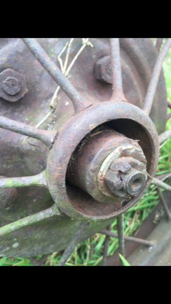

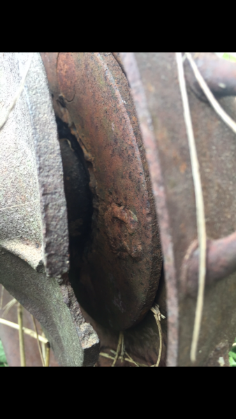

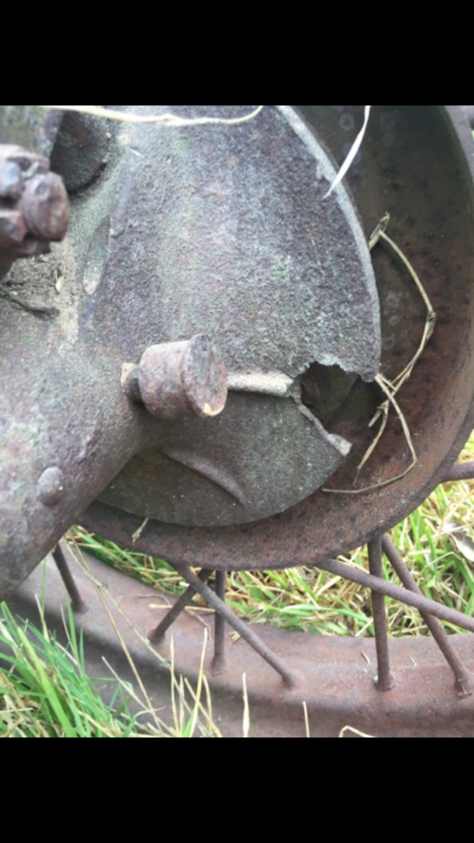

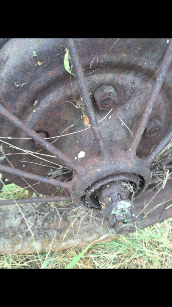

Here are some pictures of a chassis I bought several years ago somebody put A wheels on. They used A hubs in the front as well. It had a motor on it so I guess they drove it with that set up. They wouldn’t have made it much farther because the rear axle nut is cracked.
