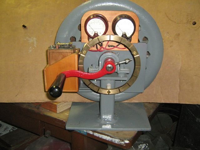

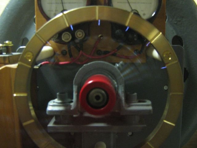

Travis, This is one that I made from plans found online, at this time I cannot remember who's plans they were sorry. If I find the plans I printed out I will let you know. Jim

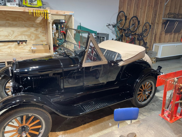

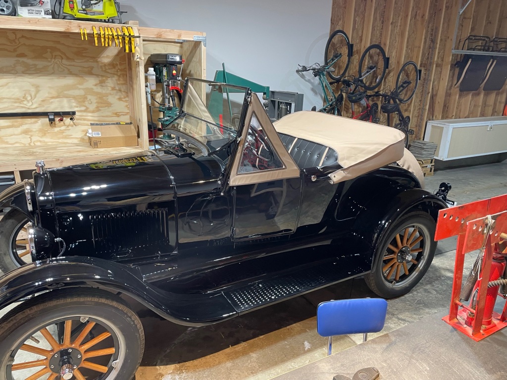

Ron and Scott,
Thanks for getting back to me. Sad to hear Bob left us. One of the things I have learned in the 20 plus years restoring my 1926 Runabout is that when you see something like that you need to buy it ASAP. I used to have the flawed mindset that stuff like that would always be available. I will start looking for an original that’s restored and working. I planed on putting it on display behind a replica sales counter in the back museums building with all my restored gas pumps etc., along side all of my original tools.
On a side note: my 20 year restoration of my first model t is finished thanks to Mike Bender doing the long block for me while I rebuilt my house from a total loss fire. I’m looking forward to my next model t restoration now.

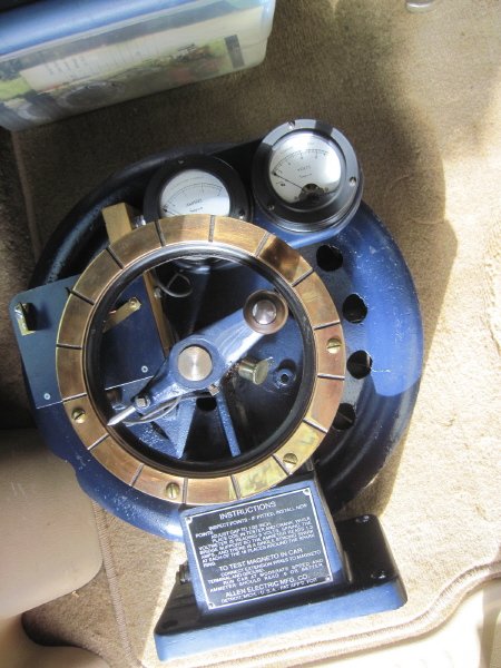

Jim, did you also make the spark ring.
I have a friend that needs one.
Bob Scherzer made all the cast parts and sold them as a kit.
I bought a set from him at Hershey before Langs started selling them.
He later sold me a refurbished coil ring with paint to match the rest of it.
He also made an upgrade Simpson Volts and Amps Gauges, with all the screws needed to mount the meters, to replace a large original Amps meter type.
Those meters are difficult to find now.
That was about 30 years ago, and mine still works like new.

Jim, Yes the ring is turned from an old piece of bearing material I scavenged out of the scrap when I was still working. After turning I set it up on a dividing head to cut in the divisions and the screw holes. The crank is made from an old wrench that I cut down, the handle is just out of my stash of (Someday I'LL find a use for this), I have since shortened the crank because it tended to throw the whole thing off balance. The gauges were some that I collected over the years and just happened to match. Jim
