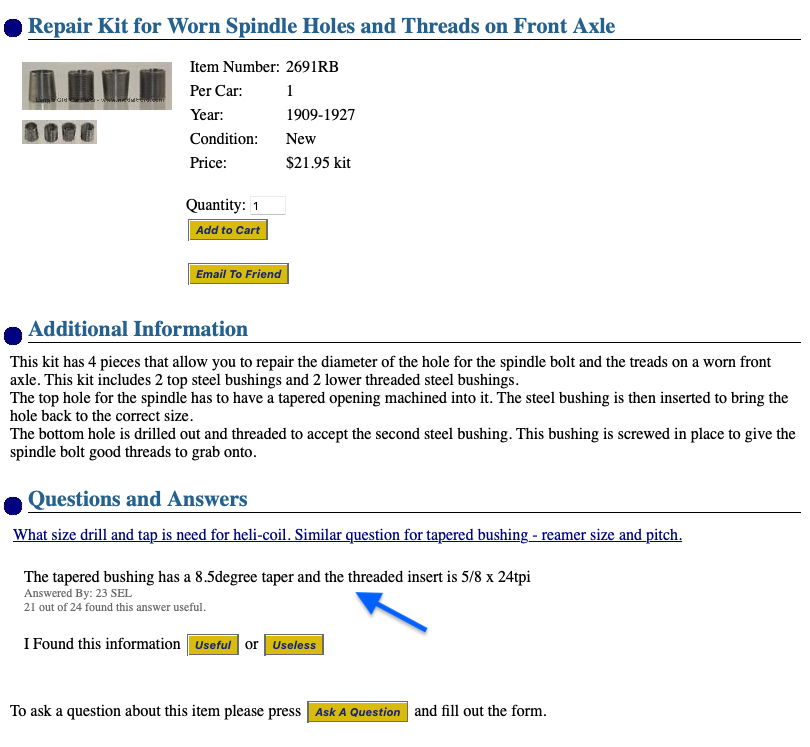

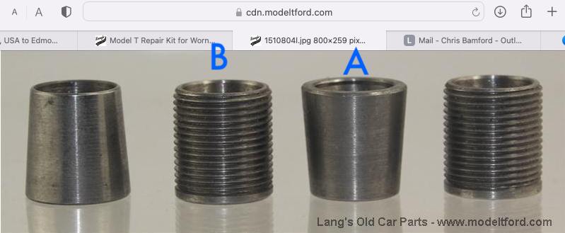

Lang's markets front axle repair kits with a tapered upper insert. They state an 8-1/2° taper reamer is required.
Internet searches for these reamers have come up dry (and/or I'm not searching right).
Where is such a tool generally available? Thank you.

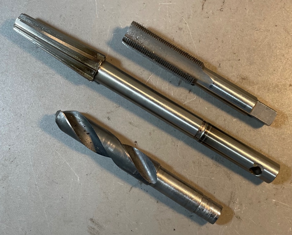

Years ago before Dan Hatch was making reproduction reamers for the Stevens Axle Bushing Jig, I made my own. For the top bushing reamer, I started with an automotive ball joint reamer and cut the length of the fluted down so it would fit in the frame. The ball joint reamer cuts the hole to a 1-1/2” per foot taper or about a 7 degree angle. I had to make my own top bushings with the 7 degree angle, which was OK because top bushings and bottom inserts were not available then either.
For the lower threaded bushing I started with a stub length 9/16” drill and turned the shank down to 1/2” so it would fit in the Stevens frame. This forms the pilot hole for a 5/8”x24 tap which came with a 1/2” diameter shank so it fit the Stevens frame. The inserts were, like the top bushings, made on my South Bend 9 lathe. They were threaded 5/8-24 on the outside and standard 1/2x20 on the inside. The top of the insert has to be relieved a bit to allow the spindle bolt to enter it.
These tools worked pretty well for me, and they were used to save a couple of scarce early front axles. Later on I bought a set of Dan’s reproduction reamers, probably from Lang’s, and have used them and the new top and bottom bushings since.
