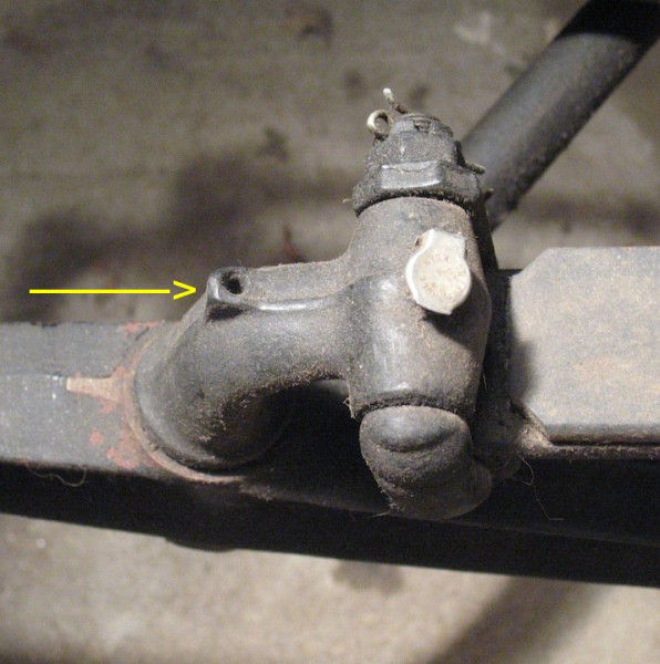

Re: Severe front end shake? Shackles?
I think David means perches backwards, not shackles. Yes, you can tell right from left by looking at them.
The casting boss (see arrow) should be toward the rear.
Several people have mentioned shackles as possibly being the problem. Specifically, a stuck shackle can cause the death wobble. Other parts of the steering system being worn loose can also be part of the problem. One worn part may not do it, but several can add up to trouble.
