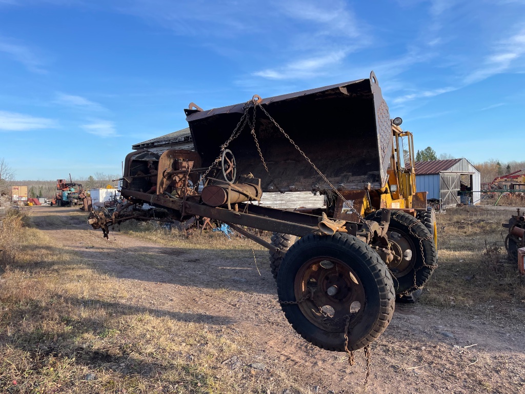

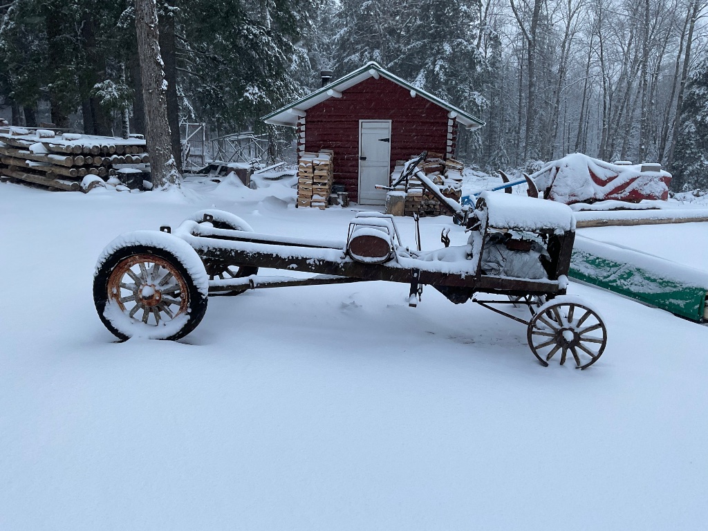

I just wanted to take a minute to introduce myself and post a pic of my TT project. My name is Mike and I'm located in the western UP of Michigan. I recently acquired this 1925(I think) TT frame. I have scrounged and borrowed wheels to make it a roller for now. I recently purchased a ‘22 engine that is complete and turns freely. My goal is assemble this truck using as many used (read CHEAP) good used parts as possible. I live remote and when finished the truck will be a daily user for cutting firewood and local hauling. I want to leave it in original working clothes and have no intentions of ever painting it. As you can see, Im going to need a LOT of pcs/parts to finish it! Let the journey begin…..

Welcome! Looks like a fun project. I think you will find the forum to be a wonderful resource.

Hello Mike
Since you’ve got the beginnings of a TT the engine would be the first thing to check out and get going. You said it’s a 22 and any history about the condition? T engines have babbitt bearings so hopefully the babbitt mains and rods are still good along with the crankshaft. Finding an engine that the babbitt is still good would be a good thing. If it is your good to go!
Have you got a Ford T service manual? If you don’t you need to get one along with the other service manuals that’s available from the T parts suppliers.

You mean it's not BURIED in snow yet? :lol:
Western UP Mich. is notorious for tons of snow, but I don't have to tell you that!! 'Course it is early yet!
Neat looking TT there, looks like it's gonna need new rear tires, and also looks like they're mounted on the "infamous widow-maker" LOCK ring rims, not to be confused with "two piece rims". Big big difference. Hard to know the condition of them from the pic, but on the outside, they don't look too good. A lot of tire installers won't touch these old, rusty rims for fear of losing life or limb. Just giving you a little heads-up on that, from my own experience.

Sorry, when I wrote "two piece" rims, I actually meant the "split rims" commonly found on the later wheels, typically 26-27 model year and some late '25s. My brain wasn't in gear yet! :lol:

It will certainly be buried by tomorrow!

Those rears are borrowed to make the project a roller as opposed to a “lifter”.

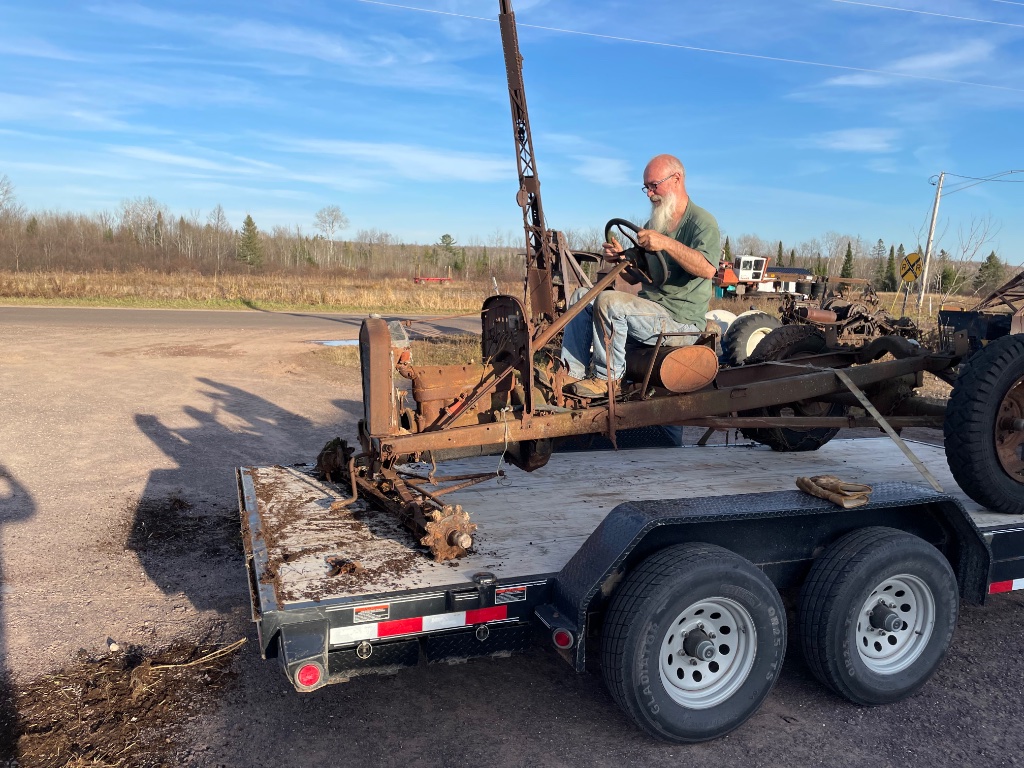

Post by BUSHMIKE » Sat Dec 03, 2022 7:49 am

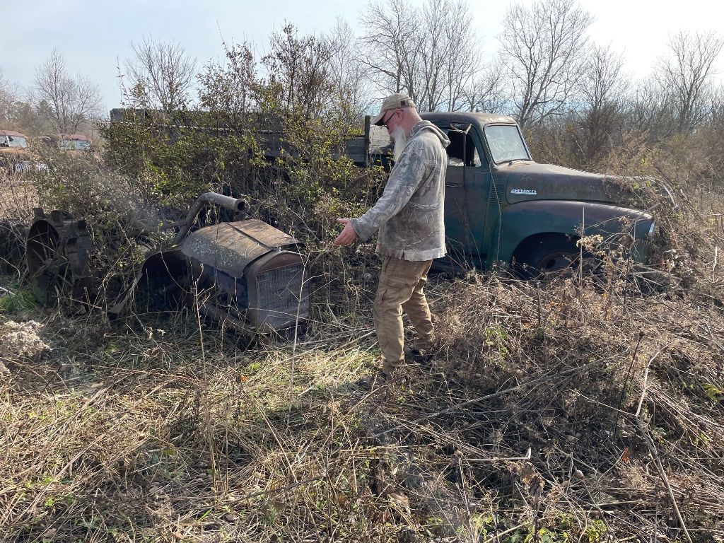

A little out of chronological order but still appropriate. A nice BEFORE pic. What was I thinking…….

Post by TWrenn » Sat Dec 03, 2022 9:23 am
I give you LOTS of credit Mike! Gotta admit if it were me staring at that hidden "mess" I'da shook my head, shed a bit of a tear, and walked away! You'll do the right thing there!

Hey Mike 👋🏼 I think it’s great you are going to save it! I would do the same thing and often dream of finding one in a fence row some day. What kind of rear wheels are on it? And it looks like in your last picture I see steel tractor wheels. Would that be a tractor conversion axle or the remnants of something else? Looks like a lot of treasures sitting around! Very good 👍

What a history your TT could tell before it ended its days under all the brush! Nice to see one being brought back to life! A little at a time and patience.

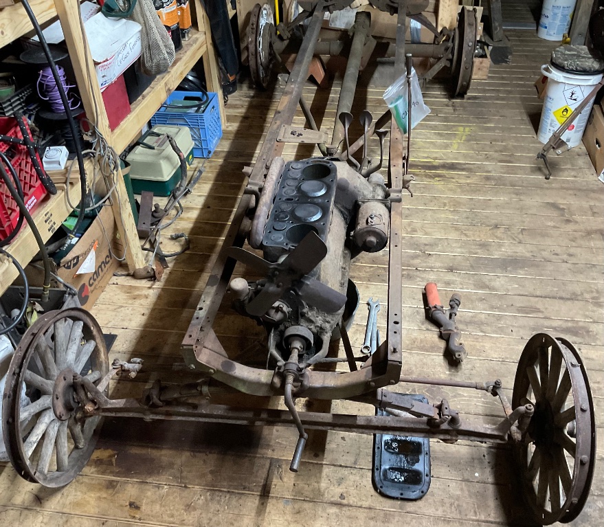

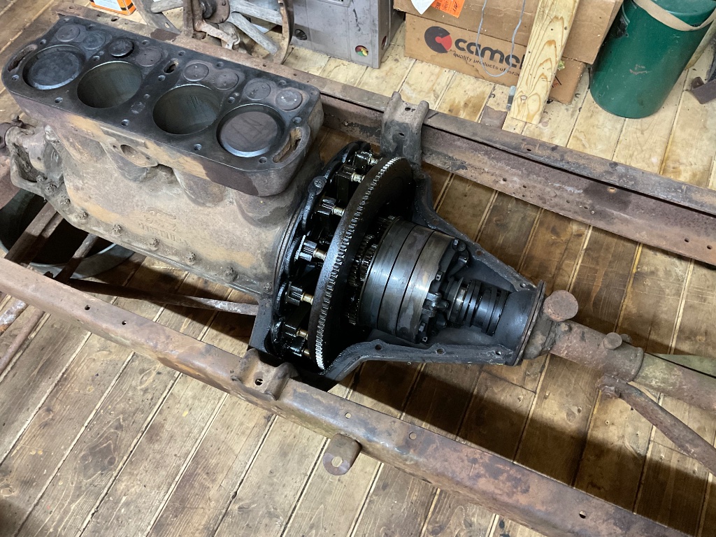

I swapped the $350 “sawmill” engine into my frame yesterday. The power unit apparently ran a small sawmill up near Oscar, MI. Just North of Houghton. After pulling the head and pan cover, I was very happy to see a very good condition standard bore engine. Valve stems are sloppy a hell and will be replaced with OS valves. I will pull the block today to then check all the bearing clearances and babbitt condition. The transmission bands were all removed and the mill apparently used in direct drive with the clutch. I have a set of quick change bands on the original tranny that I will reline and install. A hip replacement at the end of the month will slow progress down a bit. Does anyone recognize the gas tank mount on the sawmill power unit as anything Model T?
Re: Intro and my project
Post by Norman Kling » Sun Dec 04, 2022 11:12 am
It looks pretty cold in some of your pictures. I would suspect the MI is for Michigan? There are several states which start with the letters Mi, so I will guess. Do you have somewhere inside with some heat where you can work on the truck during winter? I suppose you could drive it as is if you had some tires on it and a few parts in the drivetrain. I don't know whether you would like to sit directly on the gas tank.
We have a member in the San Diego area who has a pickup. He had a buggy seat on it when he first got it, but now has a c cab body on it. He has been working on it for many years adding things to it as they became available. He does not trailer it to tours but has, many times driven it as far as 30 or more miles to the beginning of a tour or parade!

I removed the hogshead today to see what is hiding underneath. I see the slow speed drum is cracked right thru to the face. Hopefully the drum off the original is good.
Posts: 5579
Post by RajoRacer » Sun Dec 04, 2022 1:46 pm
Appears quite clean in there - no safety wire on the driven plate though !

Post by DickC » Sun Dec 04, 2022 3:11 pm
You may want to hope the other drums are good in your original engine. In addition to the cracked drum, the others look like they have deep scores which will destroy the bands quickly.

Post by John kuehn » Sun Dec 04, 2022 3:23 pm
If all the drums are good in the original engine it might be best to use those with the triple gears too. That way they would be all matched.
Another option would be to use the complete transmission from the original engine but it will depend how good the condition is overall. Sometimes when using a single drum it might be a little noisy because it’s not worn in exactly like the others are. Been there and done that.

Post by BUSHMIKE » Sun Dec 04, 2022 3:43 pm
Thanx for the input John. Ill tear into the original transmission later in the week. I will rebush all the drums and triple gears if needed. Thats easy work for me. I want to get the block off and assessed. The pistons on the Oscar engine seem loose for clearance while still in the bore. The bores are 3.752”. Thinking I will just bite the bullet and bore for new OS pistons. Are most of you running hardened valve inserts in your T’s?

Post by Scott_Conger » Sun Dec 04, 2022 3:55 pm
Mike, rebushing and reaming drums is not as straight-forward as it appears on the surface. It is also a very rarely needed repair.
As far as triple-gear bushings, I have fine results using my clearances and methods. However...they can be fraught with trouble and a source of early failure if done according to many accepted repair procedures. I would suggest a thorough study of why you can likely leave the drum bushings alone, and then contact Dan McEachern to purchase his triple gear pins and his needle bearing gears if you conclude that they need looking after (and they may well need it). They have a very good record over the years and have been well documented and discussed. They are the way to go and will be for me, too, on any future projects.

Post by Norman Kling » Sun Dec 04, 2022 4:52 pm
If you look at the brake drum very closely, it looks like a crack a little to the left of the crack in the low drum. Fortunate you found it because, an exploding drum can stop you in your tracks where you cannot even push the car off the road!

Post by BUSHMIKE » Sun Dec 04, 2022 5:45 pm
Ill look at all the drums closely when I get them cleaned up. Apparently, the sawmill was still being run in 1946. This penny was in the nose in a bunch of dried caked sawdust/grease.

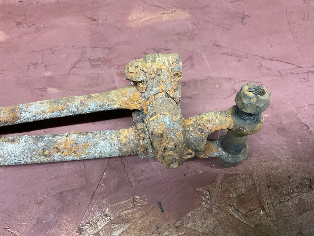

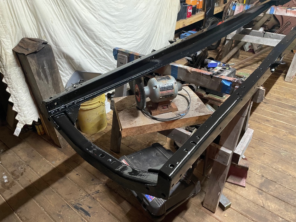

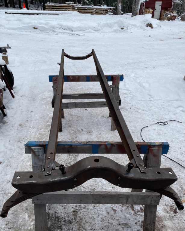

We hit 28 deg. today so I wire brushed the frame prior to prime and painting. I found this stamp inside both frame channels up near the front. I assume a suppliers ID. I l

Post by Scott_Conger » Sat Dec 10, 2022 1:15 pm
Now is the time to spend some time leveling things up on your stands and working with some string and a ruler to verify that the frame does not sag (it does) and that it it is square (it is likely not).
Don't wait to find these things out after painting!

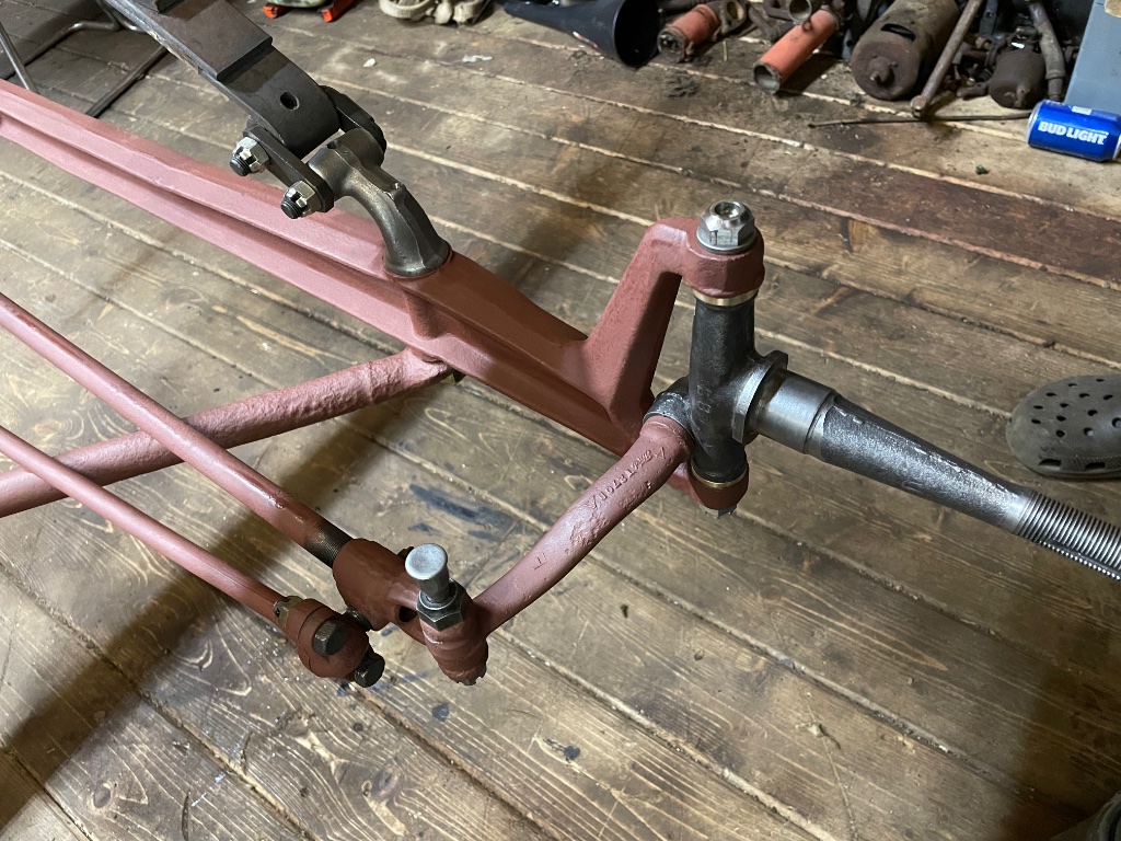

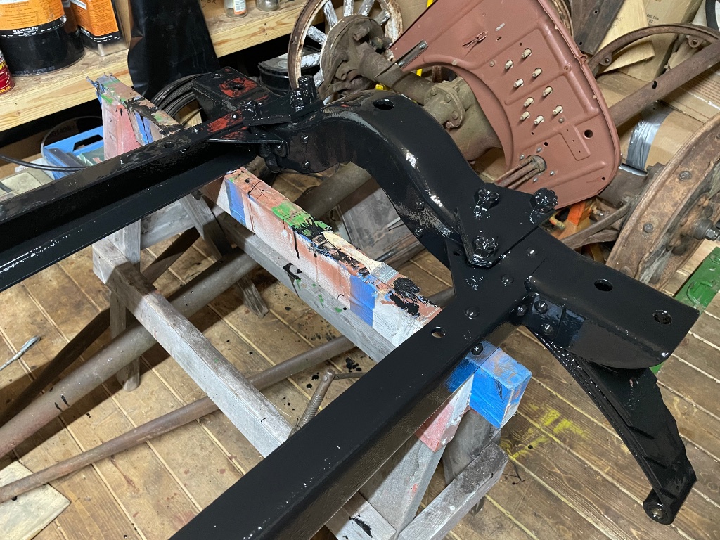

Post by BUSHMIKE » Sun Dec 11, 2022 7:46 am
Scott,
Diagonals on hard frame points are within 1/16”. Im happy with that. Betting the tolerances on frame rail oal exceeded that let alone the assembly.

Post by tdump » Sun Dec 11, 2022 2:02 pm
1 look at that frame photo and I can tell it is straighter than most.

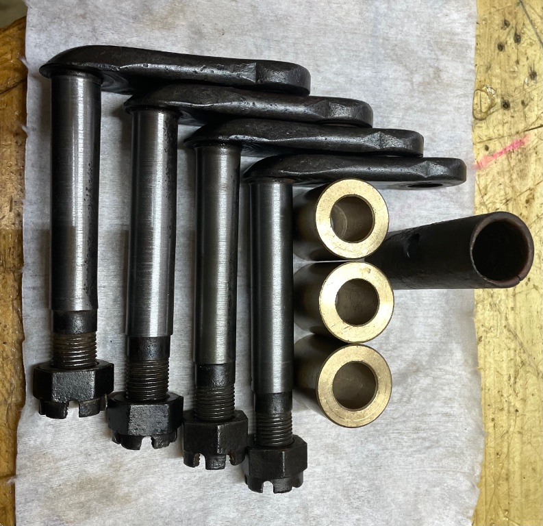

The transmission.It is all across the board as to how to repair them. Ideally you send your old transmission to a professional and spend 1000's and install and drive your car.
From a realistic stand point,budget wise maybe not. For me,the challenge was worth the effort. and I can go fire up my pickup and take it for a spin in just a few minutes,and I repaired that transmission on a piece of plywood on 2 sawbucks in my back yard .Using brake cylinder hones and and TIME.
using all the best parts from 3 transmissions and a bushing kit from 1 of the suppliers. Oh my goodness,it has a tiny whine in reverse! :shock: no biggie,it has been whining since 2008.

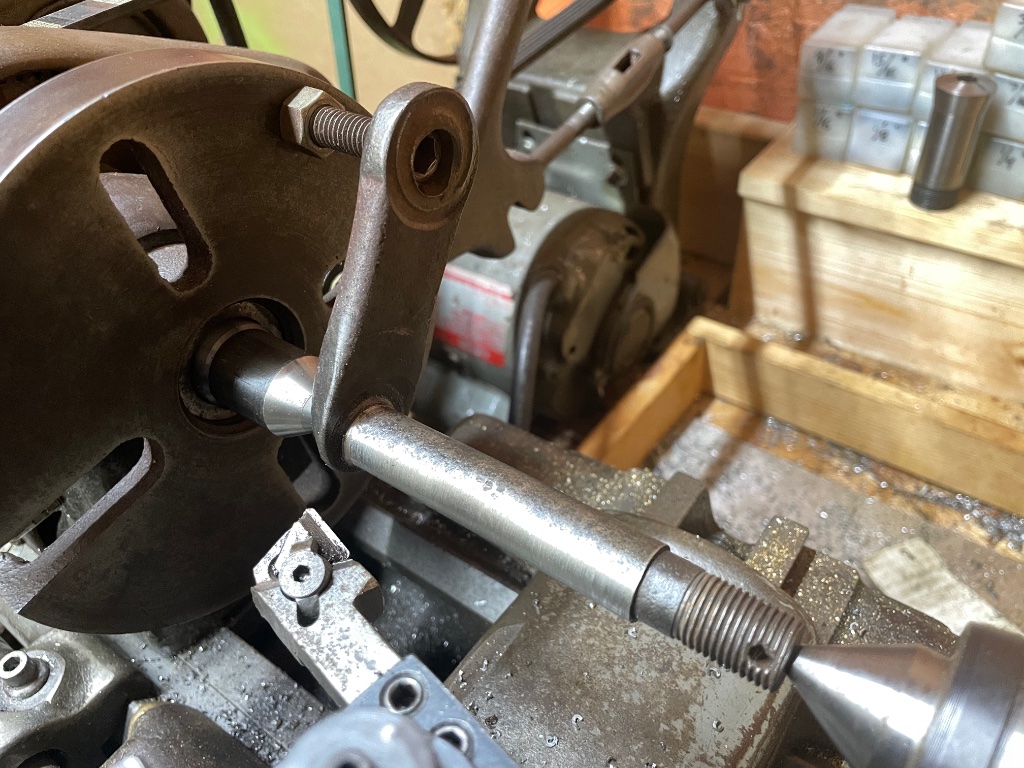

Post by BUSHMIKE » Fri Dec 16, 2022 9:57 am
This morning I set up the shackle halves in the lathe and turned 90% of the eccentricity out of them. They finished at .625”. I will bush the rear leaf spring eye with with 660 bronze reamed to .625” ID. I will also make new spring perch bushings out of steel.
BUSHMIKE
Posts: 356
Joined: Tue Nov 01, 2022 6:46 am
Last Name: Cushway
* REQUIRED* Type and Year of Model Ts owned: 1925 TT, 1926 TT, 1926 TT
Location: Trout Creek, MI

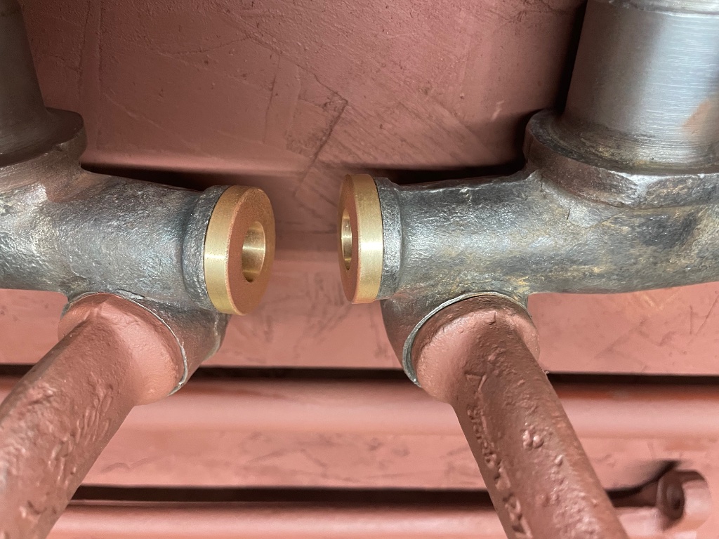

Post by BUSHMIKE » Fri Dec 16, 2022 10:00 am
The machined set. I still need to turn down the OD of the bronze bushings yet. The steel spring eye bushings were nearly worn thru.
BUSHMIKE
Posts: 356
Last Name: Cushway
Post by BUSHMIKE » Fri Dec 16, 2022 4:24 pm
I finished rebushing the spring perches this afternoon. Both the spring eyes and perches were drilled and tapped for 1/8” NPT grease zerks. Im pretty happy with the results. It sure tightened things up!

Still healing up from a full hip replacement in late Dec but I have been trying to pick away at the TT as pain allows. Today I managed to finish riveting the replacement correct front crossmember. It took me several hours to make the different back-up bucks that fit tight between the rivet head and opposite frame flange. I had to do this as I work alone. I brush painted the entire frame using RustOleum gloss black with the TSC enamel hardener catalyst. I am anxious to see how it drys now as this is the first time I have used that hardener. I am excited to start hanging parts now!

I spent the entire day slowly resurrecting the lower steering on the TT. I re-bushed anything that needed it….which was pretty much everything in hindsight! It gives me great satisfaction to save and use parts that very few others would. I ruined two turned steel steering arm bushing mandrels before I made another of 4140 and hardened it. Almost unbelievable how tight those old bushings were in the forging. I still have to line-ream the new spindle bushings, but everything else is 001” or less. The tie-rod shown in the before pic has been underground for 20+years. I buy Kroil by the gallon.

Another good day in the shop. I have almost everything in the front end restored and tightened up. It takes several pounds to rotate/swing the connected spindles by hand. I am sure this will wear in quickly with use. The before pic really doesn't do justice as to just how bad this front end was. Its starting to look like its gonna roll on its own soon! Next is the oil pan.

A better pic of the before…..

For what its worth, we have the better part of a TT Universal Transmission available if you need one. Or if anyone else needs one. The gears are pretty nice. There seems to be a small eccentric operated brake drum in this trans- anyone know what thats all about?

The small internal brake may serve the function of a clutch brake to assist in quick shifting.
