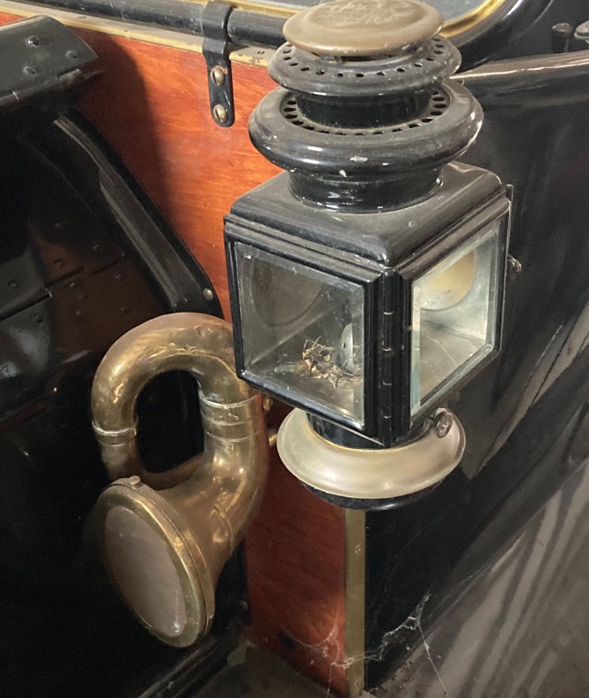

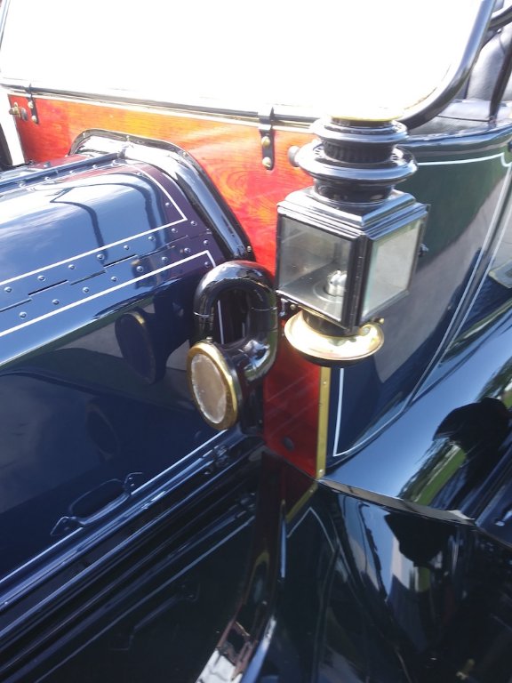

But you will on this one Original!!! :lol:

Now I'm confused. Which is correct ? The vintage photo, or George and Tim ?
(Observant fellow that I am, with a photographic memory, now I gotta go look at my Lizzie to see how her horn is mounted - at least it's painted black :lol: )

Post by George House » Mon Dec 05, 2022 6:05 pm
Rich; I always thought triple twist horns were mounted bell “up” and single twist like mine and Tim’s were mounted bell “down”.

The photo is not. And I was half asleep when I replied to Tony! :oops: I was referring to George's (and mine) when I replied. Sometimes I confuse myself! But you know me well enuf now about that eh Rich?!? :lol:
I think so. And this type like ours I have always read that the idea was to keep rain out. Who knows!! :lol:
