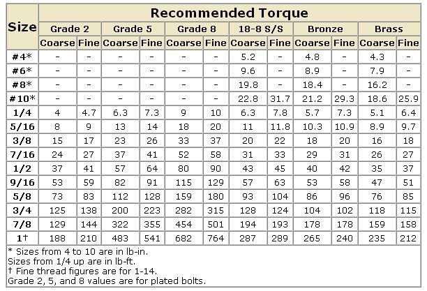

Does this help? I copied it from a Dec. 31, 2007 MTFCA thread. I believe I read on the forum that they did not use torques during the Model T era. Experienced mechanics just tightened by feel. Torque charts came about years later to show how tight certain sized bolts could be safely tightened before stripping or breaking. Jim Patrick
