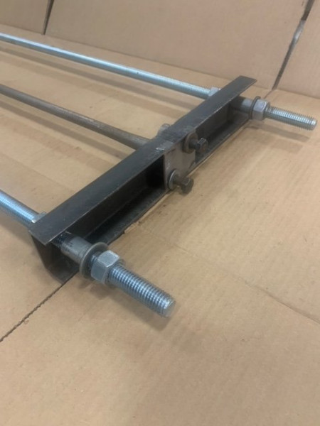

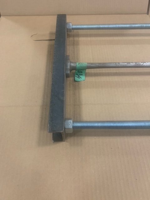

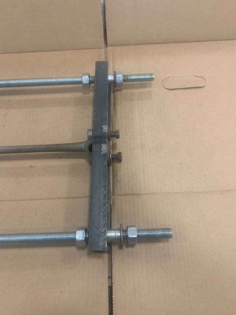

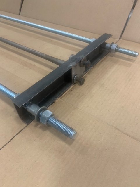

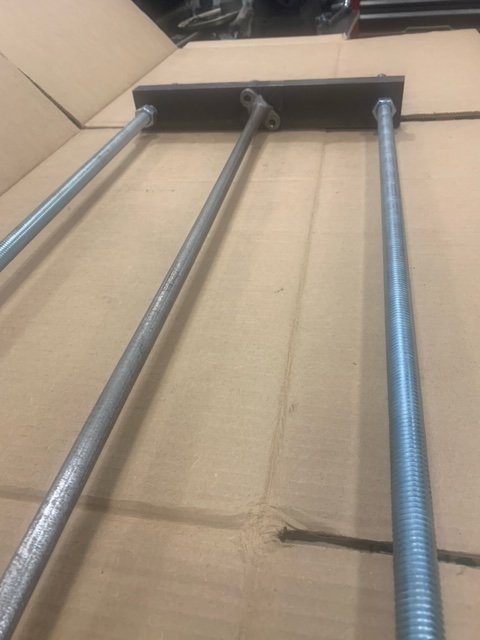

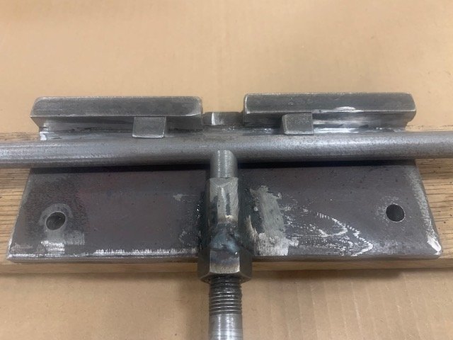

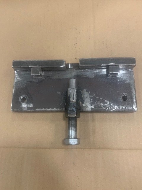

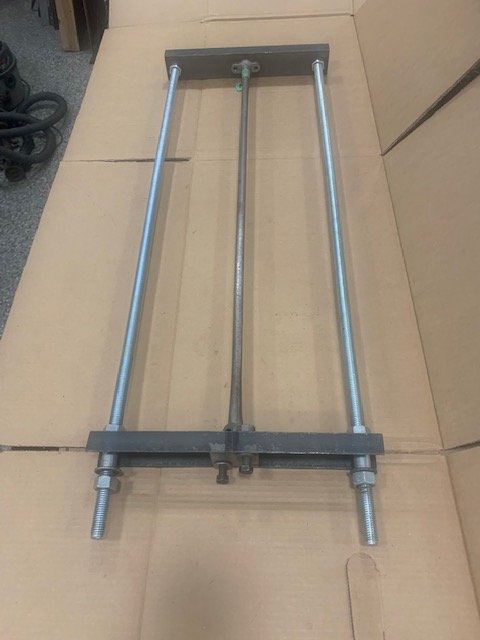

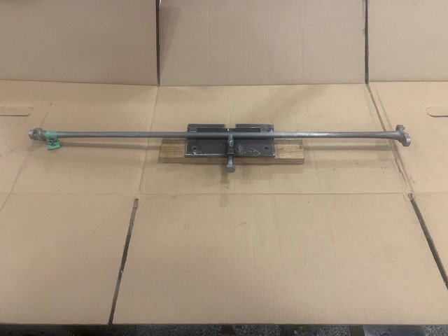

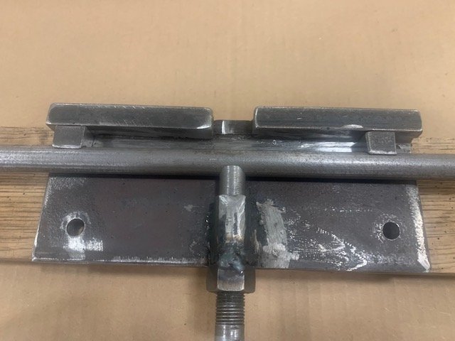

I want to share what I have been doing with drag links. I made two tools that work for me. It may take more than one posting. The drag link ends are supposed to be 45 degrees to each other and the faces parallel. Never pound the rod to straighten it as that may work harden it or otherwise change its constitution. First, I use the bench mount jig to straighten the shaft by using a basic black spray paint to shadow, and a long sanding block to show discrepancies, over and over again. The small blocks are moved narrow or wide to match the need for each correction. After I have the rod straightened, I use the frame for aligning the ends. I used some channel iron and all thread to make the frame. One end is fixed (those nuts are always left tight) and the other is for the work. First, to twist the rod rotationally and to parallel the ends, I install the rod and tighten the 3/8" bolts on both ends, I move the outer end nuts touching but not tight. Then I lay it on the bench and twist it to get it flat when relaxed. Then I use the adjustable end nuts to push the rod end out into parallel. I found it is better to push out to parallel the end rather than pull in. You can then switch the mounting to true the opposite end.
[/quote]
Now the frame.
[/quote]
Now the frame.

Hello Allan,Allan wrote: ↑Wed Dec 14, 2022 4:44 pmI had no reference to reset the angles between the two ends of the rod when re-fastening the one end. Fortunately, on this 1912 item, the other end is threaded, and the adjustment made, purely by eye as the rod sat on the car. On the later fixed end rods, is there a simple way to make this setting, or is it rarely significant enough to require correction?
My frame is designed to correct the rod ends to be at 45 degrees to each other and the ends absolutely parallel. I highly recommend the drag links to be absolutely correct as they are one of the most critical links in the steering. If you would like more clarity, I welcome you to connect directly with me.
