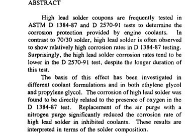

My Father loved antifreeze, made him a very wealthy man, the stuff is corrosive to solder. Even new cars from England sold in Australia needed radiators replaced before leaving the show room.

Soldered radiators can suffer from "solder bloom" if the coolant is neglected. This appears as a white crust around the solder joint between the upper tank tubes and the header plate. Aerated coolant or a leaking headgasket sitaution would probably aggravate the tendency. I believe that using anti-freeze as directed prevents the problem.
