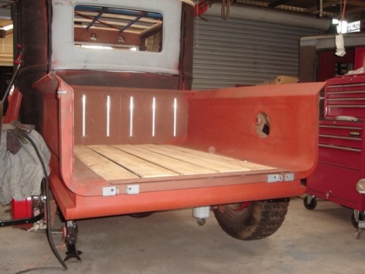

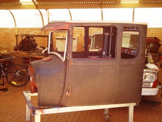

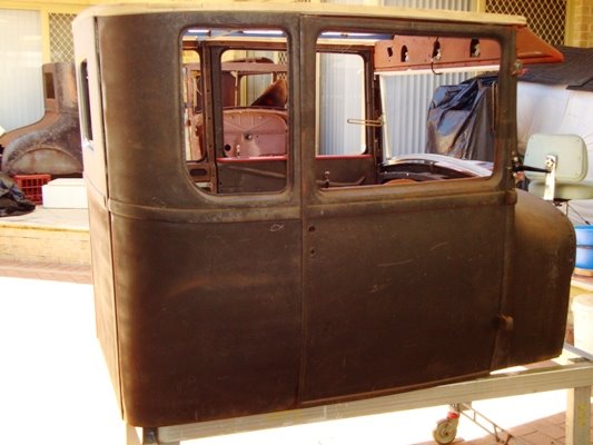

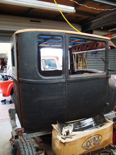

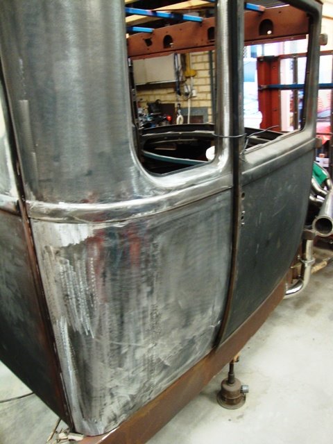

Just for interest sake I guess, I am posting the pic of a project I am building which is a 1926 T coupe body that had serious rust out issues in the rear so I got it modified in a shop and converted to a 5 window closed can pickup body.
I thought that mine may have been the only one in existence, but have since been told there is another similar plus a 4 door extended cab pickup as well.
Anyway, it sure provides a lot of extra legroom for starters.

looks like a very good fit and a good save on a project that may have been lost due to it being too difficult for many people to accomplish … will look good with a flat bed or box … we have seen many tourings cut down into pickups here in the western states … always an optimist ...Gene French

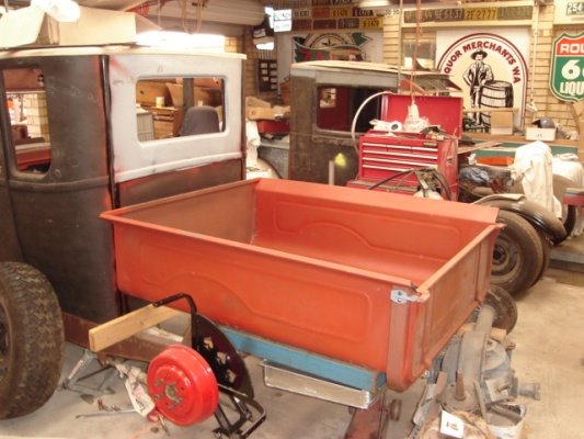

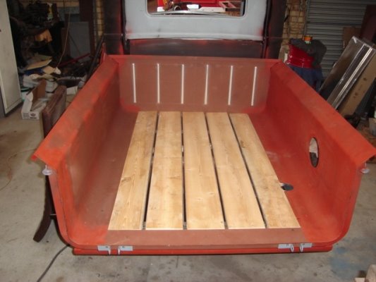

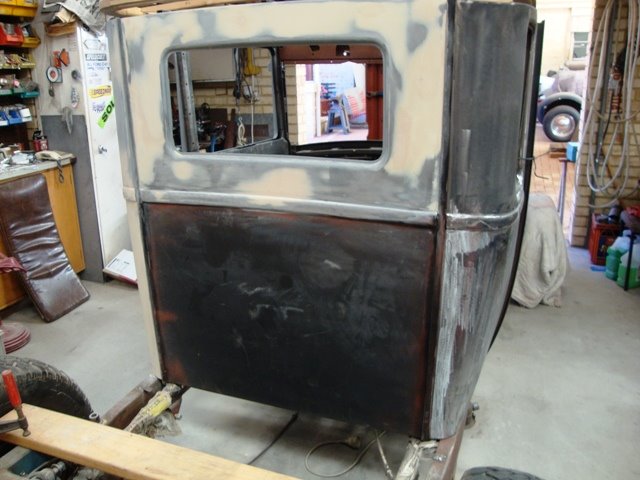

Yes, this body was saved and the girl/lady that did all the body work did an exceptional job.
The work was done in CO.
It is destine to become part of a hot rod project using a 1940 Cadillac flathead V8 engine...
A view of the chassis and other parts can be seen on YouTube by using the link below,
https://youtu.be/5GQ8Ujaq7MY
The box is a custom made item also from CO shortened a few inches with a modified beltline to center with the new rear wheel location.
I can post pic's of the engine if anybody is interested...

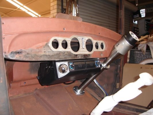

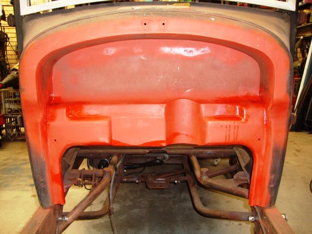

Firewall was reversed and recessed.

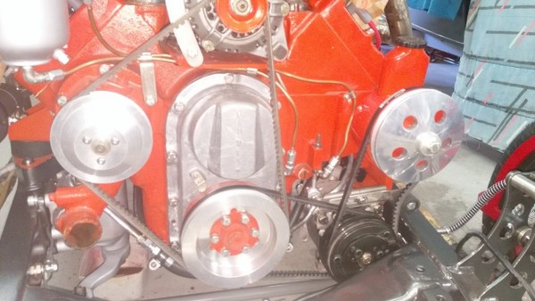

The engine and modern transmission weight in at a combined weight in the region of 720kgs (1585lbs) and boy that is a lot of weight to sit on the front transverse spring.
I've had to rework the spring twice now and this even before taking it out on the road.
I will post the engine pic's here and then call it a day.
I thank you all for your kind words and interest and hope I have added a extra dimension of entertainment on this Forum without treading on too many toes.

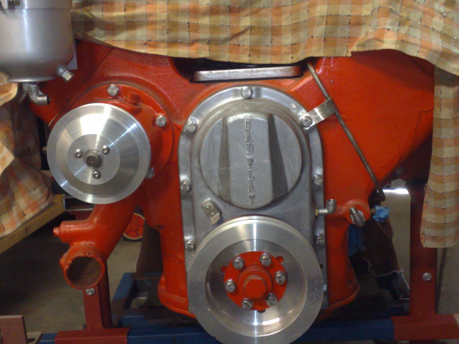

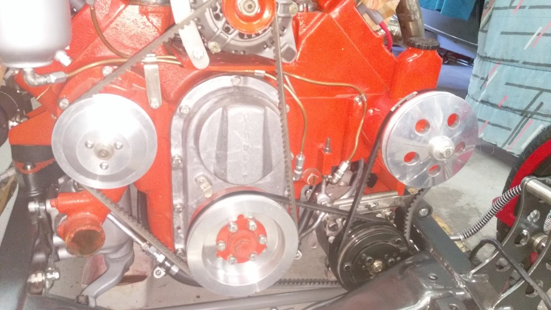

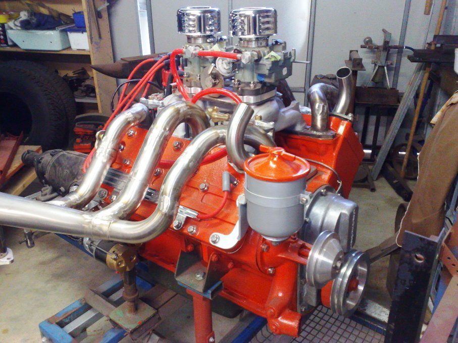

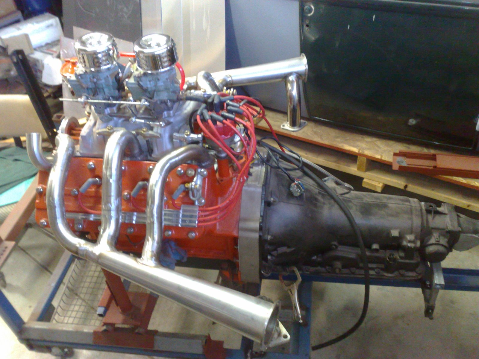

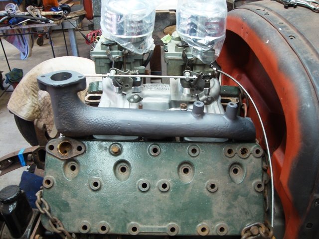

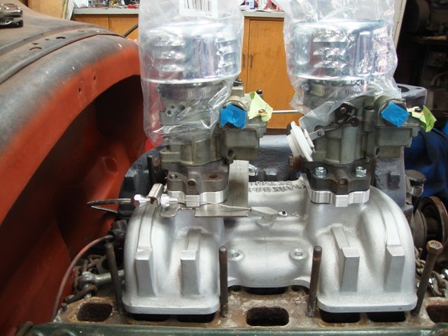

Just for the record, if you look at the attached engine pic's I designed and manufactured both the cast aluminum valley plates and timing chain cover as a means of stamping my slant on things.
The engine runs power steering and a/c, twin thermostats, twin carbs and improved cam, HEI ignition and a dual homemade exhaust system.
