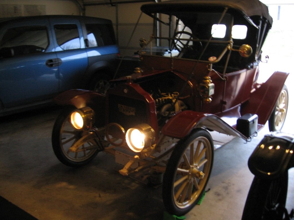

A bit OT, but here are a few pictures of the lamps lit on my 1912 Flanders. Note that the burners are oriented so that the "Y" faces parallel to the axis of the car. A lot of folks orient them so that you can see the "Y" from the front, this is incorrect.

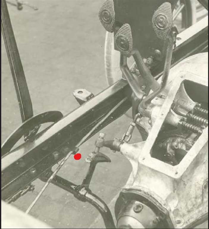

You need to fabricate the crossover pipe. It solders to the fins of the radiator.
The "tee" and two small 2-inch pieces of tubing are shown below. The single long piece
not shown in the cropped photo of tubing is about 14-1/2-inches on my Brass Works radiator.
It lays against the fins, "tee" on driver side of radiator, soldered, and is about 1/2" lower
than the gas hose holes in the side panels. The fan is close, so securely soldered.
If someone has the "factory" length on the "14-1/2" piece", please chime in.
The crossover lays against the fins and each end, about one inch, bends slightly away from the fins
to allow the acetylene hose to clear the fins to slip on and place a clamp.
The "Rear Gas Line" is a single 44" long piece of your brass tube and is held by a single clamp as shown
by the photo at the red Dot. It slides forward through the hole in the wood engine mounting block.
The tube lengths are: Two each at 2-inches, one at 44-inches and one at 14-1/2-inches.
