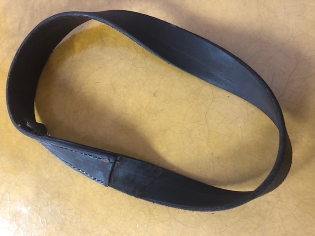

I made a leather fan belt about six years ago. I used good latigo leather, but I believe it has Finally stretched out of adjustment. I stitched the scarf joint after gluing it with Barge Cement. I soon found out that antifreeze dissolves it ! I note that the parts book illustrations of leather belts show them stitched the entire circumference. Perhaps the stitching retards stretch ? I didn't do that :oops:
I have some horse butt for the next one. It's preferred for belts you wear because it doesn't stretch much.

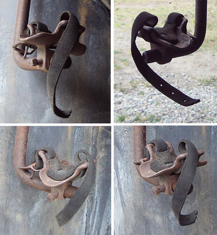

I have noticed that many top bow saddles and other straps seem to be made from chrome-tanned leathers which do not weather well. They tend to fry like bacon in the hot summer sun, and shrink a lot. Oak-tanned leather lasts better, I believe, especially if treated occasionally with saddle oil. Ray Holes saddle butter is an excellent treatment for leather exposed to the elements, if you can find it.

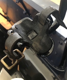

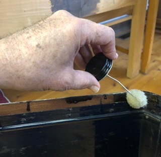

Here's a neglected lubrication point ! Hoods on the brass cars have strips of leather for cushion/anti-rattle lining. Apply saddle oil now and then to keep them supple !

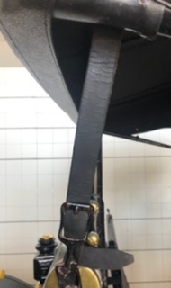

I made these top straps a few years ago. I should have oiled them sooner, some weather checking shows, but they'll be okay if oiled regularly.
Get a horse !

Too late for the bow saddle liner, but the strap is responding to the oiling. I'll be making new ones.
