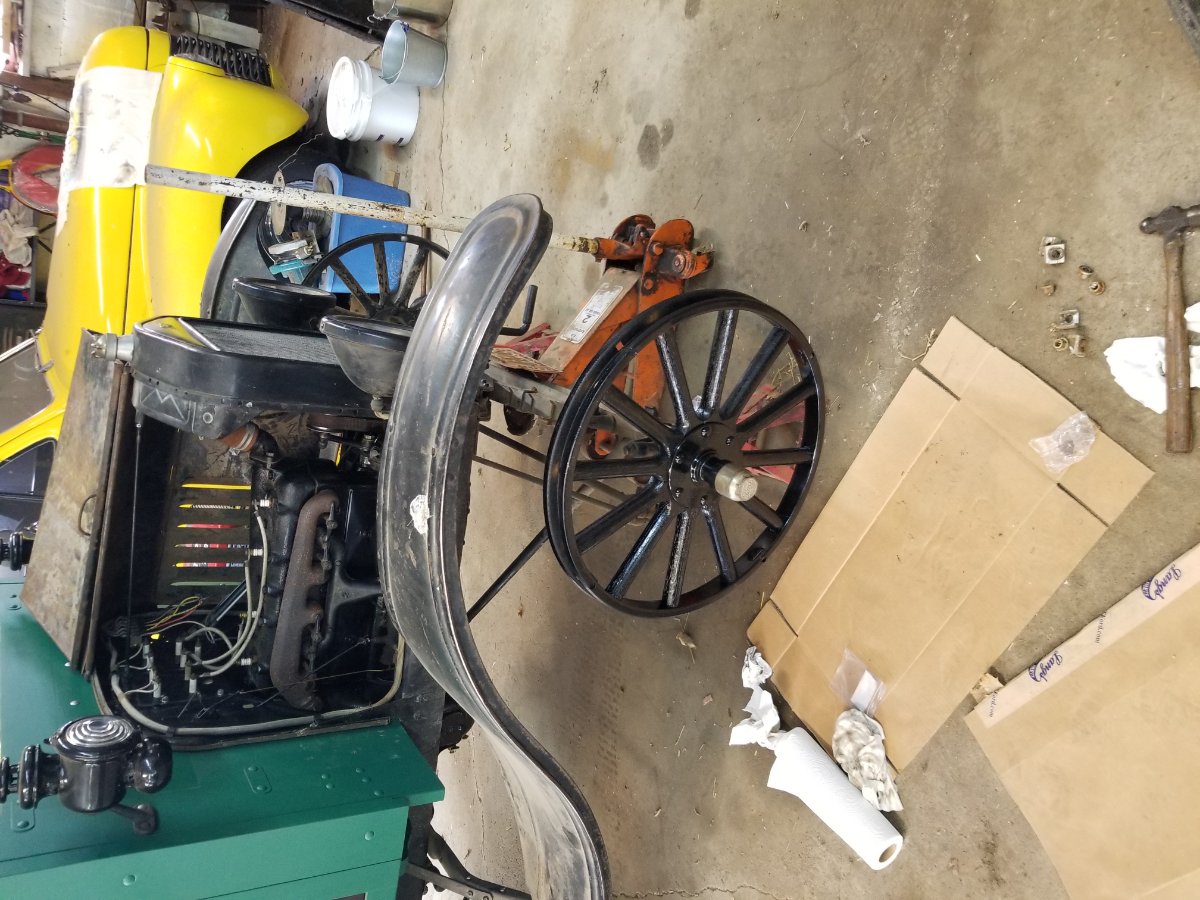

When the rain stops I hope to finish 'Lulubell'. I fell a couple of weeks ago and cracked a rib and then came down with the flu. I have to get her ready for the Kansas tour .

Sorry to hear of your incident. Just thought I'd mention that with cracked ribs, and now the flu (unless you're over it already) keep in mind you are also susceptible to pnuemonia. Having just gotten over pnuemonia myself I can say you sure don't want that.
So take good care of yourself!! Hope you make your tour.

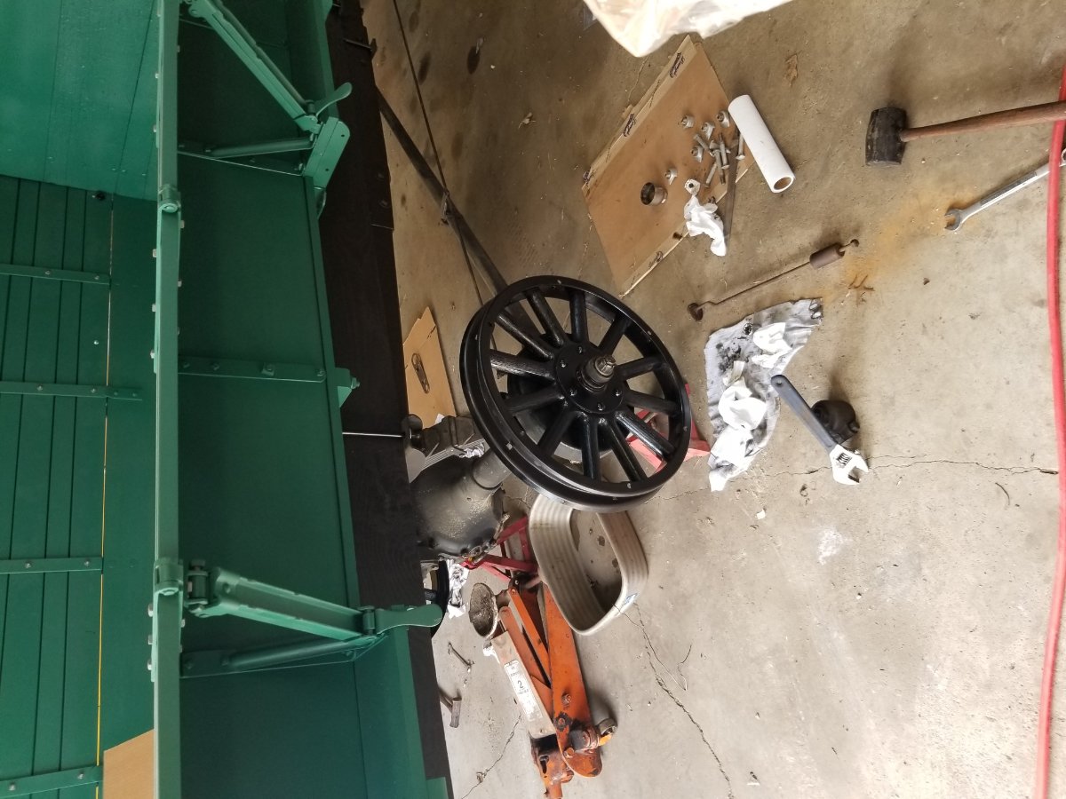

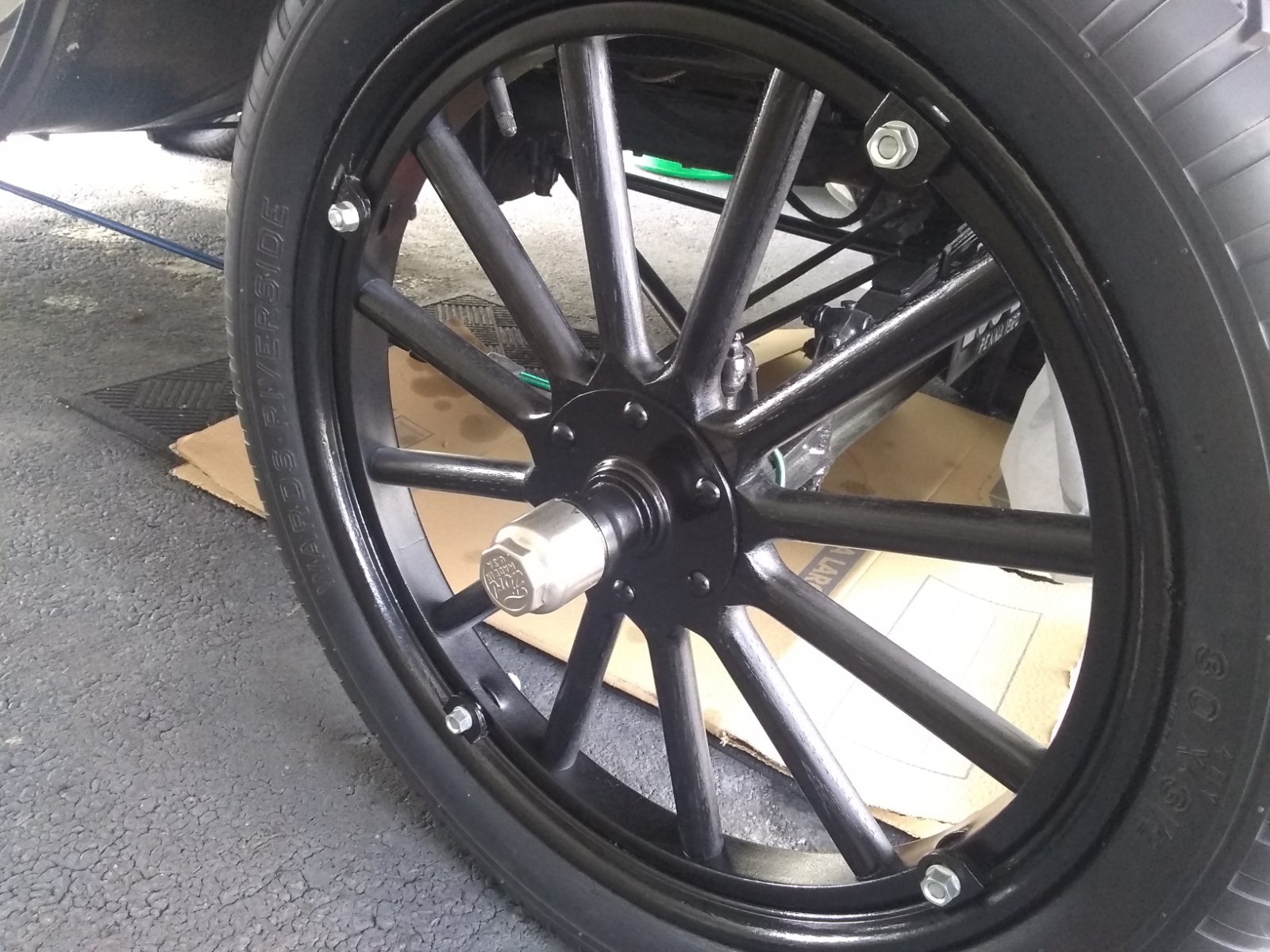

Enjoying the last of the wheel rebuilds.
Began last October. Done!

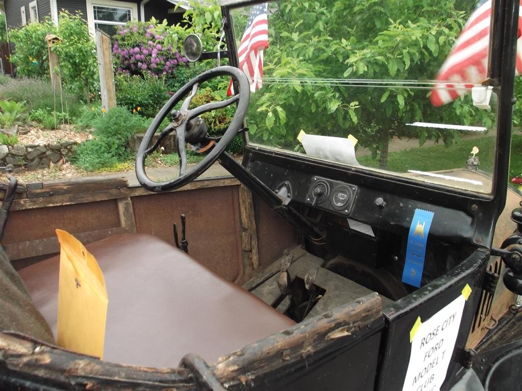

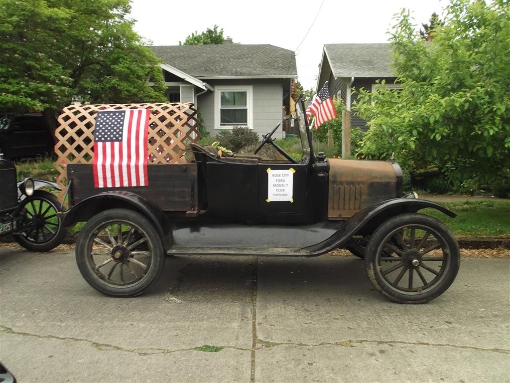

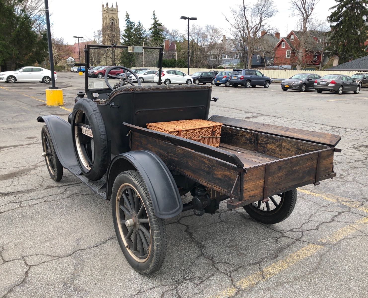

Now that the snow and salt are behind us in Rochester I’m driving the T to work every day.

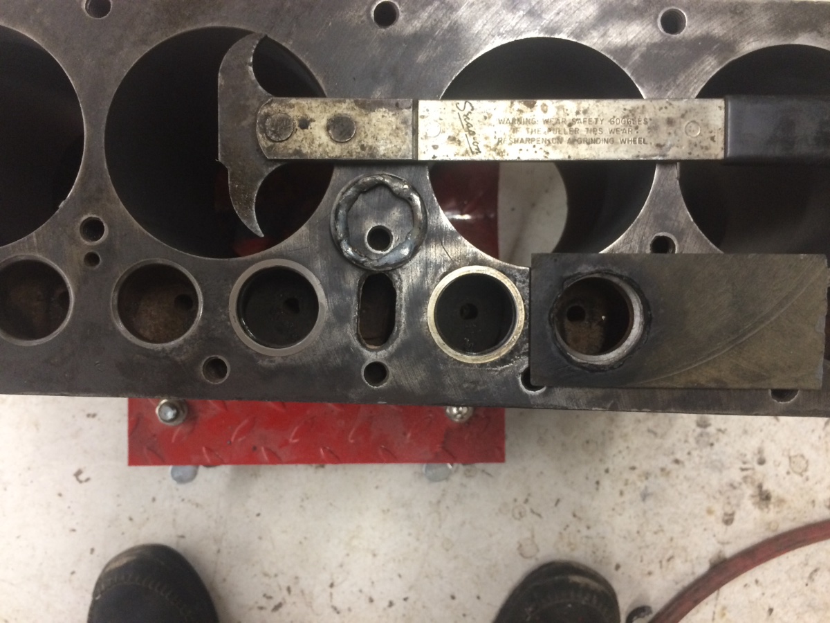

Bored 40 over, hard seat installed, valve and lifter guides reamed oversized. Babbitt comes next.

Brooks, now all you need is correct rims. The wheel you show is the type with the notch in the felloe at the bolt hole. it should have a loose lug rim which has the U shaped piece held in place by a flanged wheel nut. Fixed lug rims will go on, but they will not wedge on the felloe. The load is all on the 4 bolts.
The photo shows what I think is a Hayes lugged rim. It does not appear to go right to the back of the felloe, and looks like it sits well off the outside. This is caused by the 'foot' on a Hayes lug needing a relief in the felloe edge to allow it to go fully on. If this is the case, your is the lest desireable combination.
Sorry to dampen your enthusiasm, but it may become a safety issue, and should be addressed one way or another.

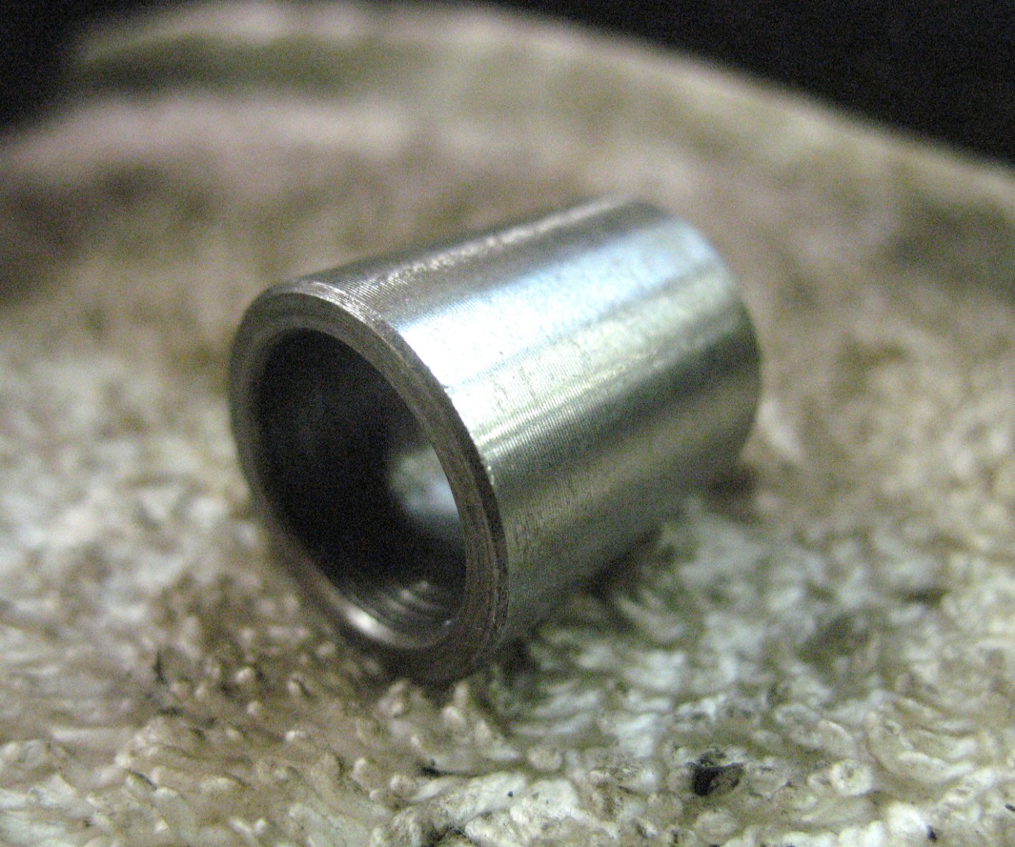

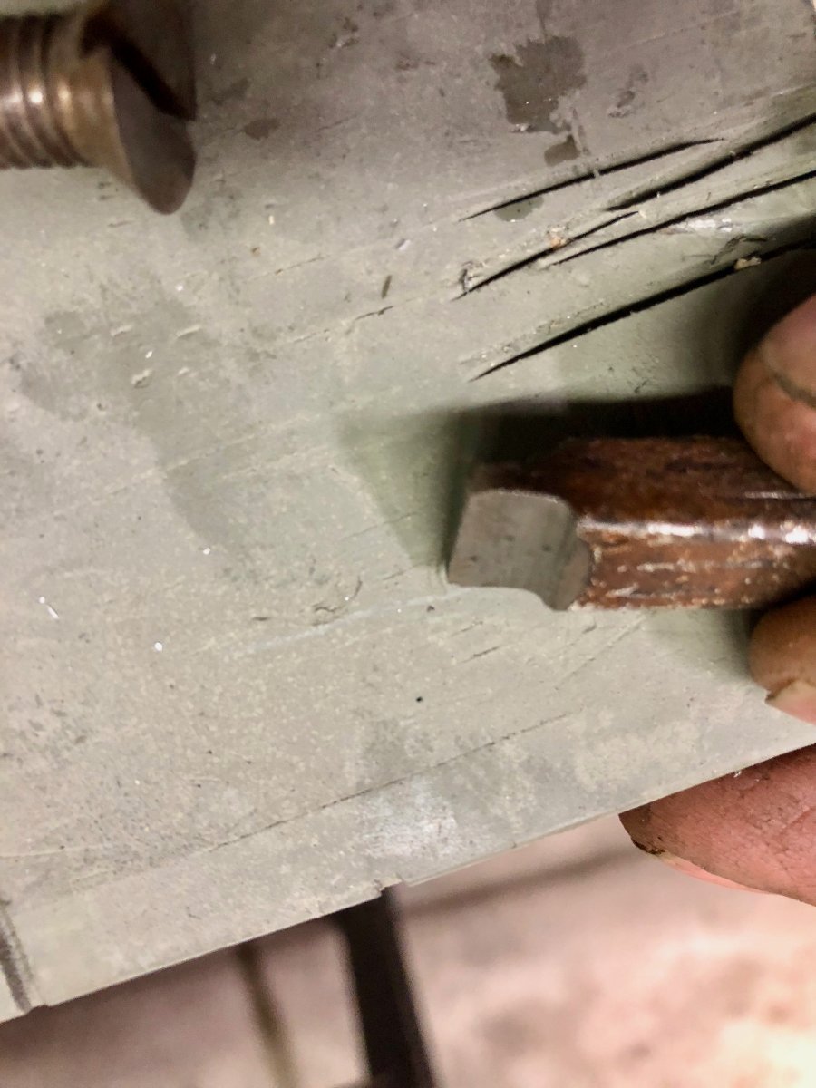

Yesterday my speedometer was skipping around to all sorts of crazy numbers (26, 52, 47, 19, 300, etc.).
I found that in a hard right turn the bracket holding the sensor was pressing against the axle. This forced the tube covering the sensor against the wheel (thus the scratches on the spokes), and the covering was now gone, with the sensor hanging loose.
So today I narrowed the bracket so it wouldn't contact the axle....
...installed a new sensor cover (3/8" brass tubing), and sealed it with Ultra Black.
Later I drove up to the county seat to renew my driver's license (a round trip of 37 miles), and the speedometer worked perfectly. I checked it against the "Your speed" sign in Winfield.

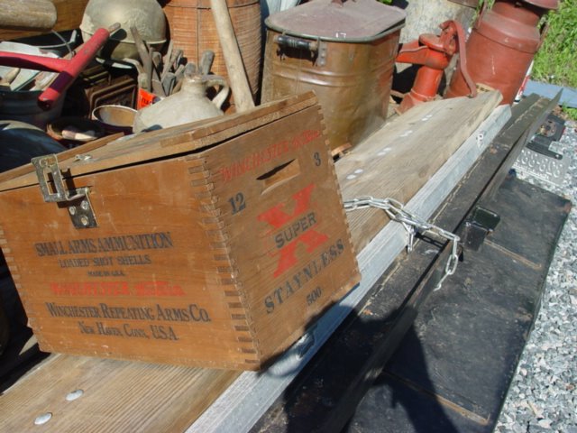

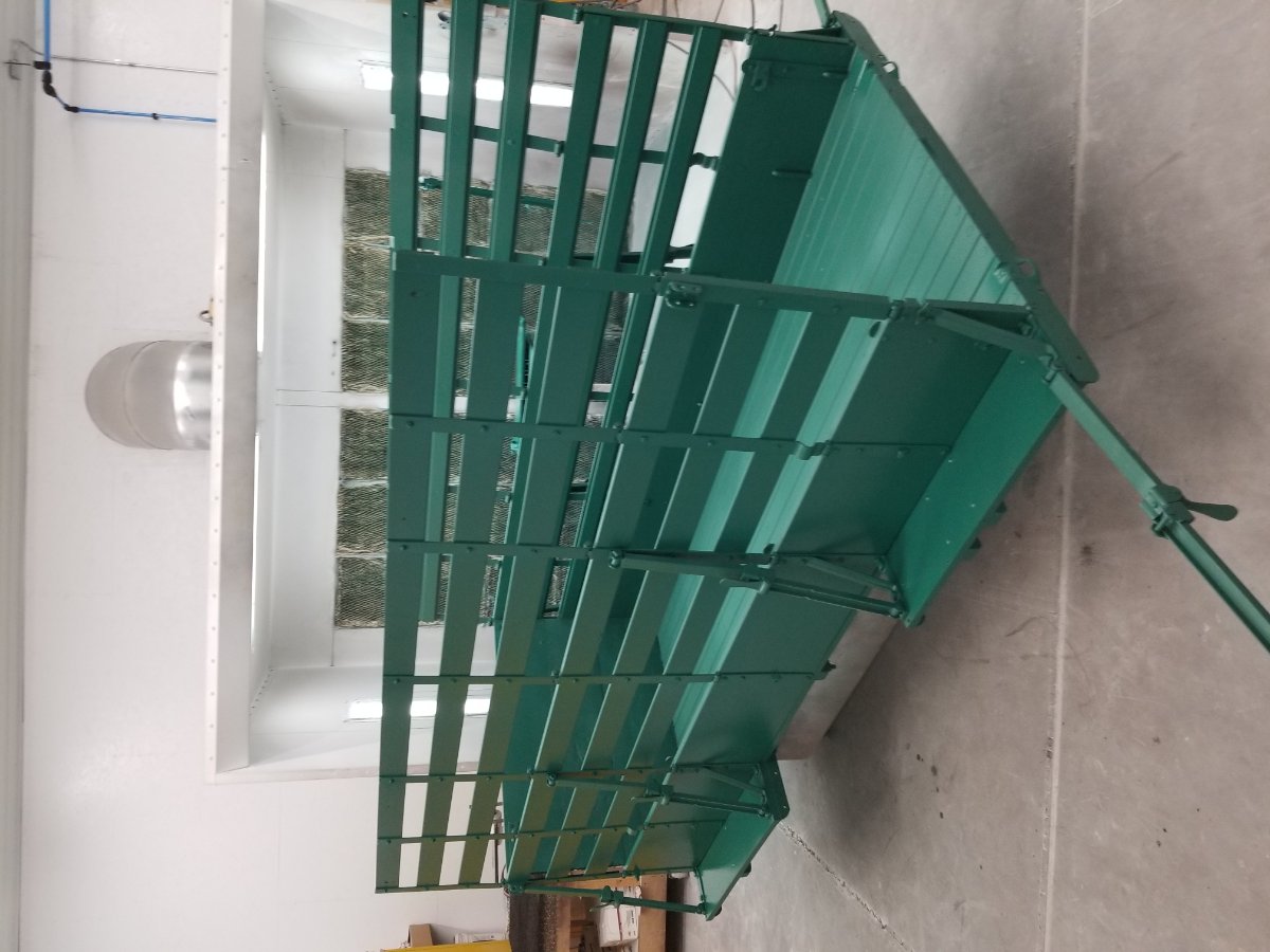

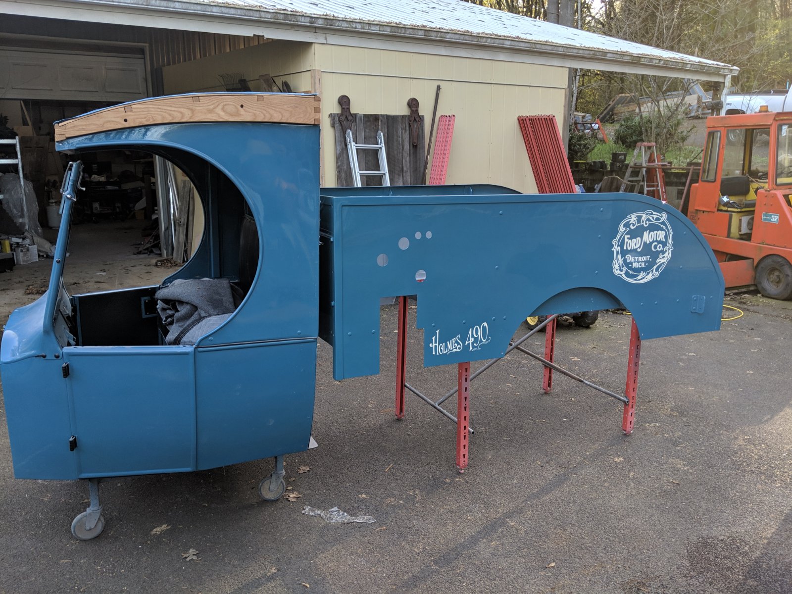

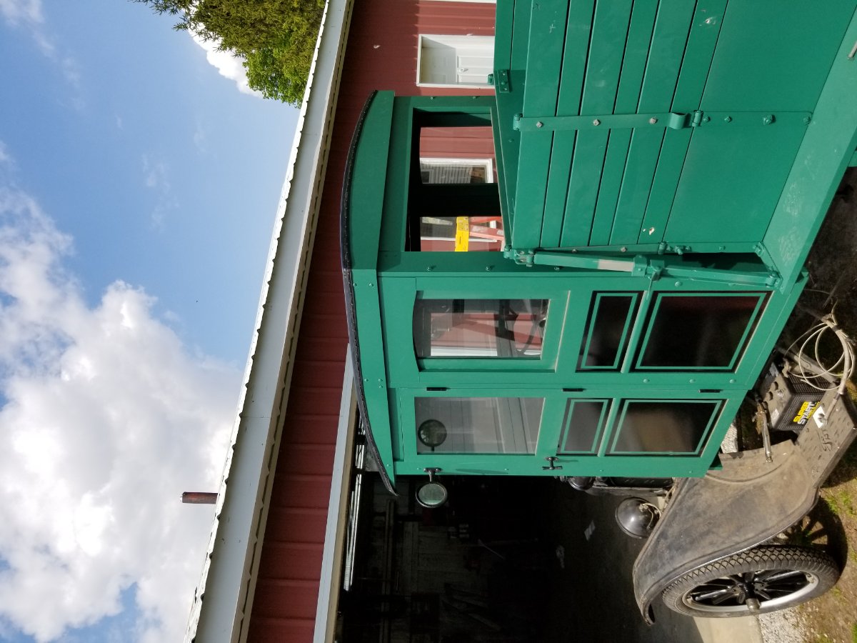

I got Ellie Mae's rear gate on...

Hauling livestock, Tom? :)

I like the way you think! It is a long way from Tennessee to Beverly Hills, so we will probably take some laying hens for eggs along the way. Those, plus the roadkill and a huge mess of biscuits Granny is cooking up should get us through.

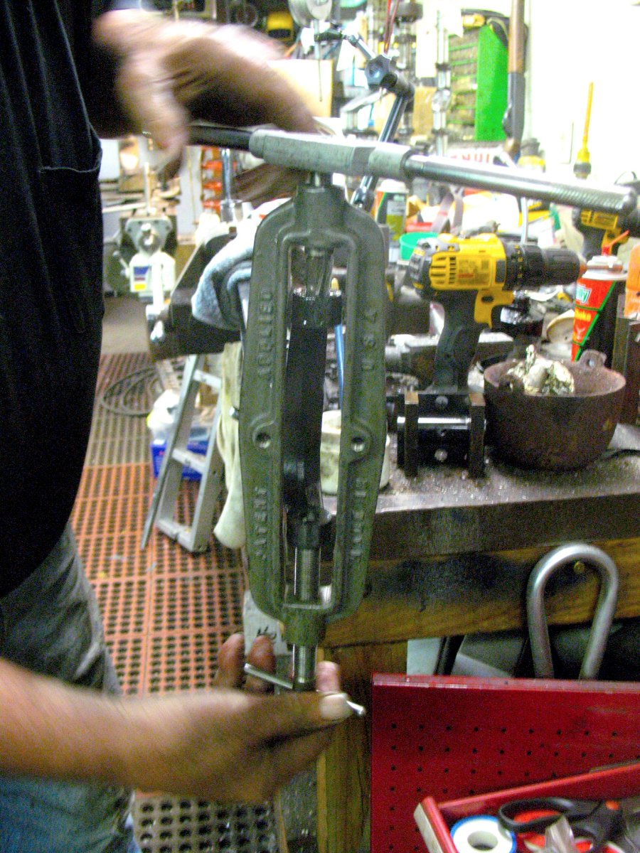

Drilled hole in right differential housing and tapped for 1/8”- 27 pipe thread and installed 1/8” brass drain plug. :)

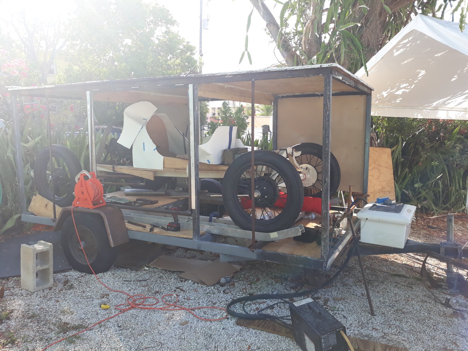

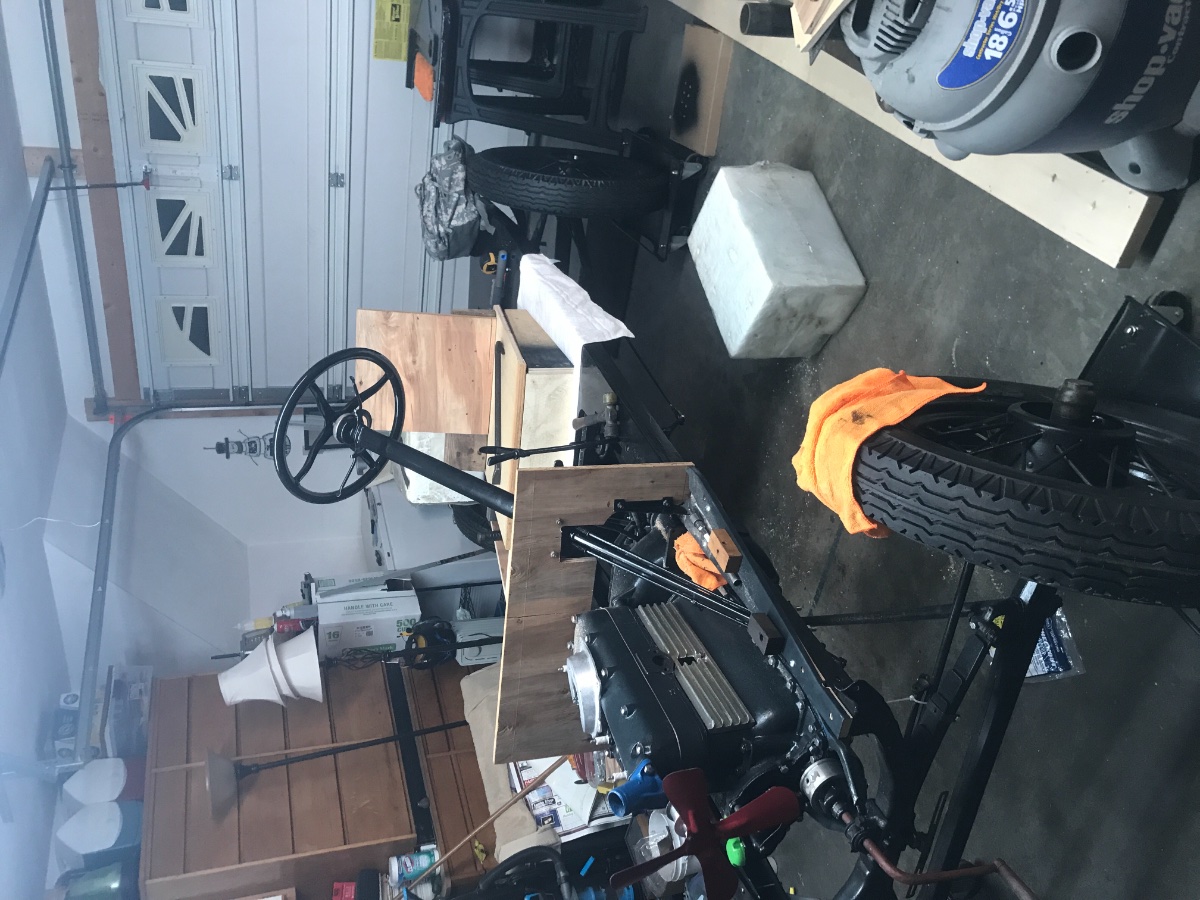

Got the speedsters body partially mocked up! Summer here we come!

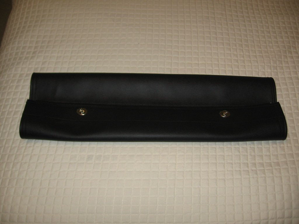

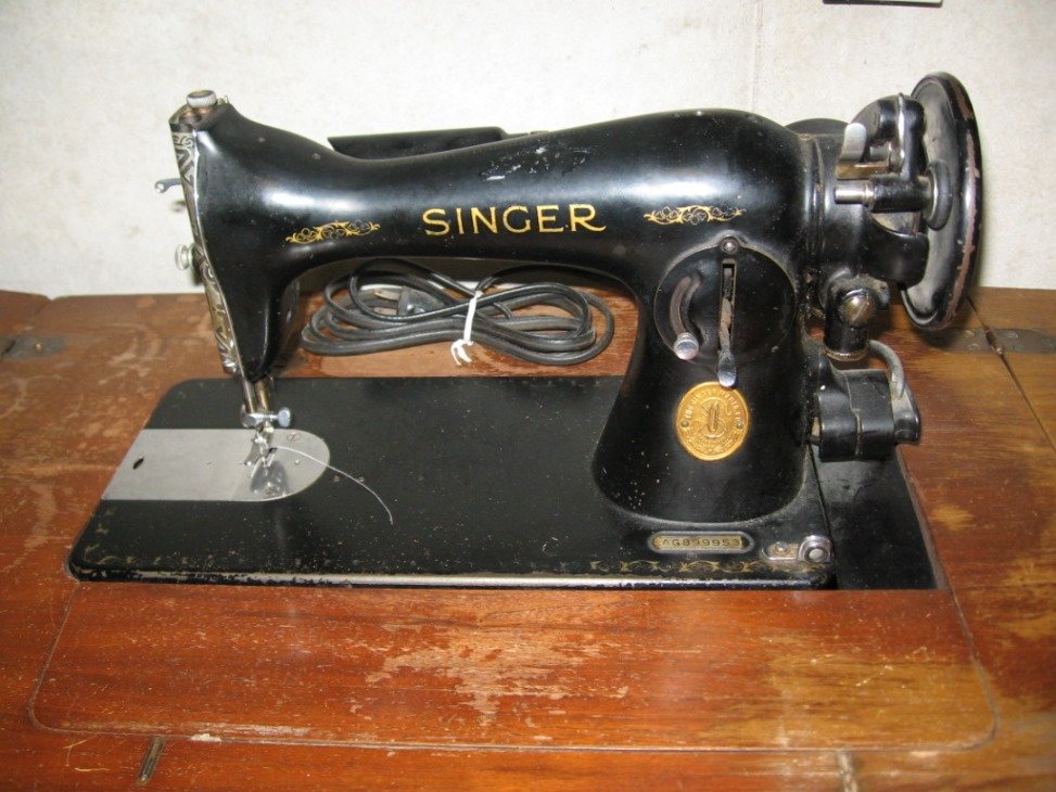

After seeing Larry Smith's photos of original Ford side curtain rolls, I decided to take some black vinyl material that I had on hand and make one of my own using Larry's dimensions.
I sewed a double seam on the sides (instead of the factory single seam) for extra strength and cut notches in the corners so that my machine wouldn't have to sew through more than two layers of vinyl at a time. I also used spray contact cement to hold the seams in position for sewing on my 1948 Singer 15-91 sewing machine.
It took me a couple of hours total, which included measuring and cutting the material, contact cementing the seams, then sewing them. I also sprayed the back of the material flat black to match the original (my vinyl material had white cloth backing).
The original Ford workers would have received pre-cut material and would have just held the seams in position while sewing them. I wonder how many side curtain rolls a typical Ford worker was expected to turn out in a single shift? :)

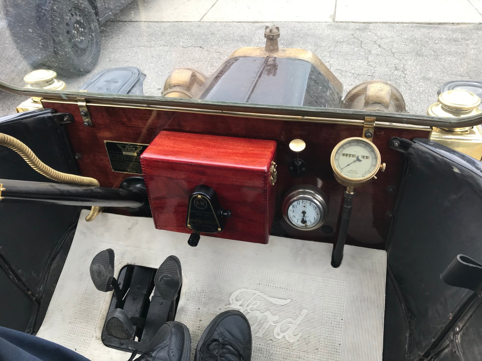

Installed the correct style coil box in my early '13

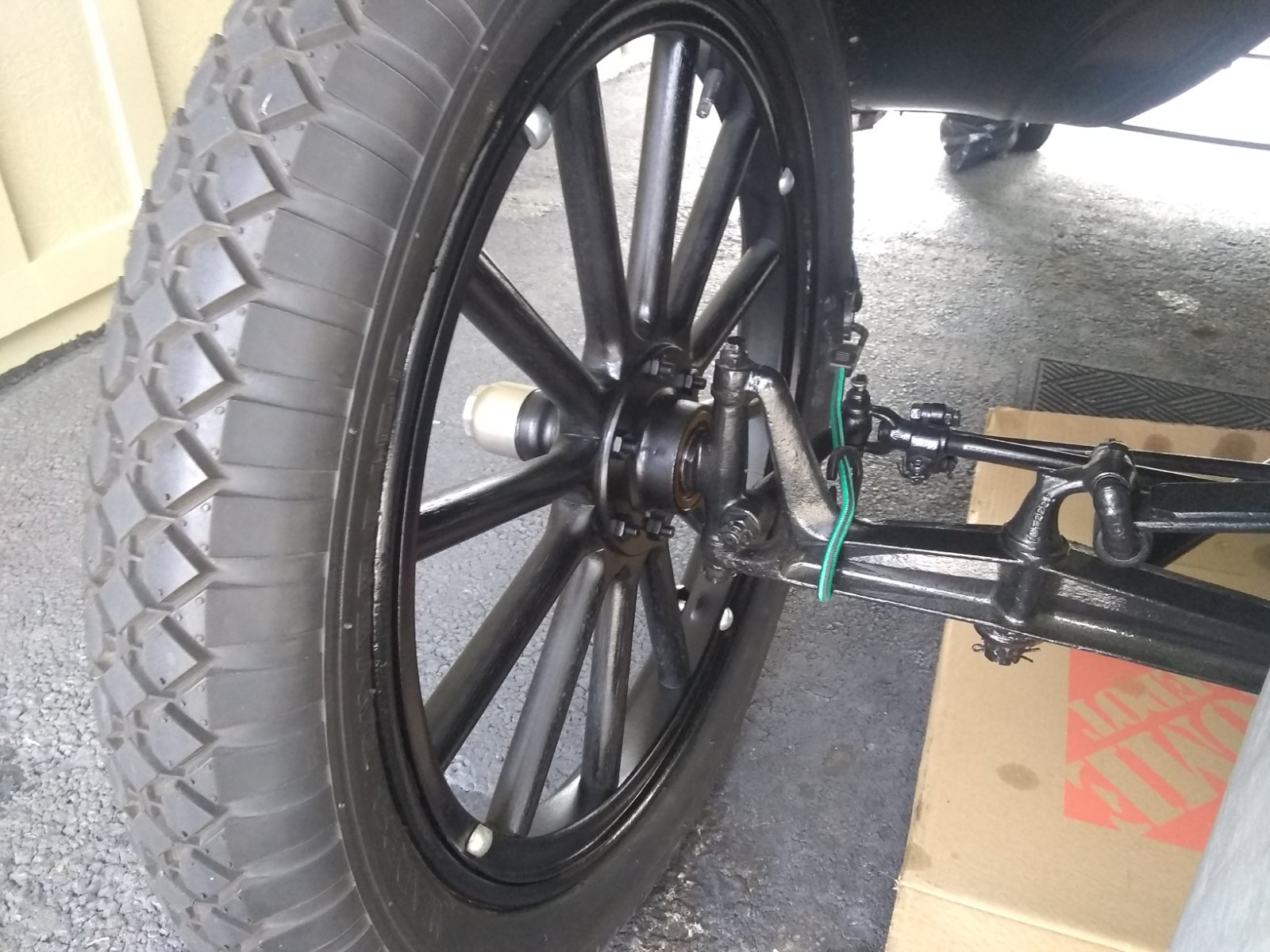

Post by Ruxstel24 » Sat May 04, 2019 4:47 pm
Took a fellow for a ride today, who's building a 24, but not a lot to experience driving one. He was asking questions about the Ruckstell, "show and tell" is easier and way more fun !! :D
After setting the toe correctly and the spindle being tight...straight down the road. I even let go of the wheel for 10 seconds or so !!
(I don't recommend or condone this behavior) :lol:

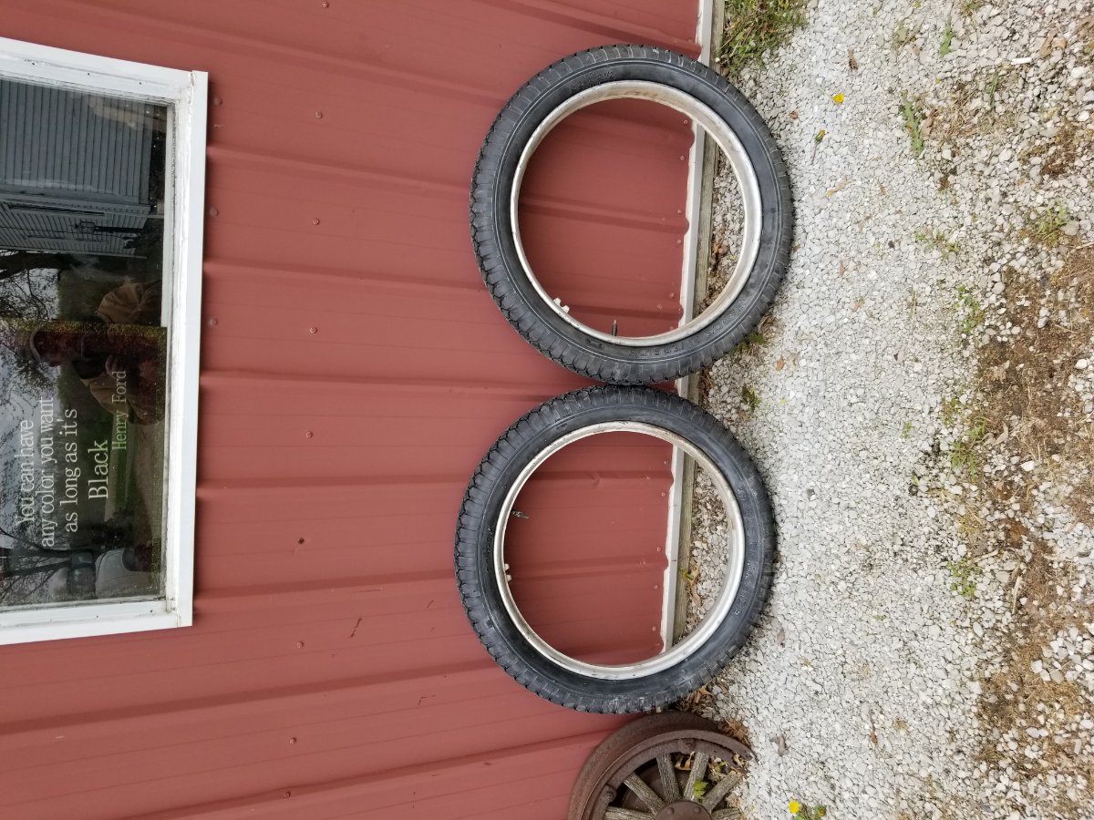

Post by Dallas Landers » Sat May 04, 2019 4:52 pm
Started this morning with this
After a wrastlin match I had this
Then the next logical step was mounting these
And wound up here
Now I getting rear wheels ready for paint on the TT

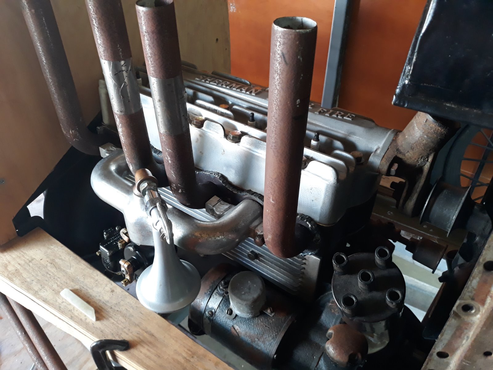

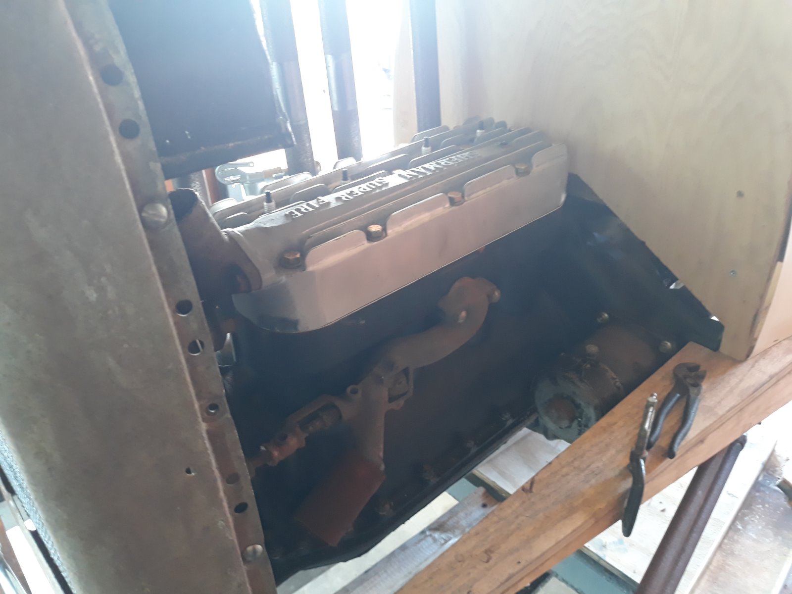

Finally got the motor into Virginia, my speedster. There hasn't been a motor between the frame rails since 2016. Life and other projects have gotten in the way, but the time is now!
Zoom zoom!

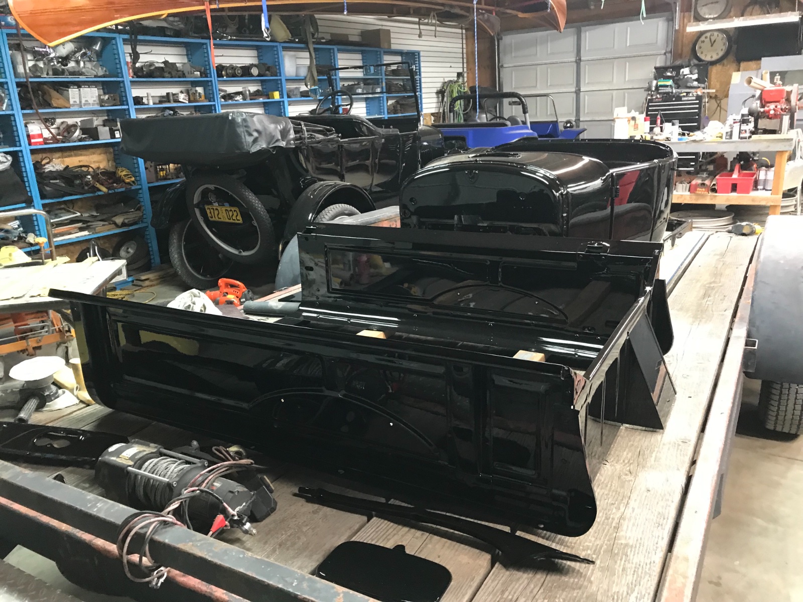

Post by Mike Robinson » Mon May 06, 2019 12:41 am
Picked up my 26 T Roadster pickup from the paint shop Friday.Im very happy with the results. Now the real fun begins!

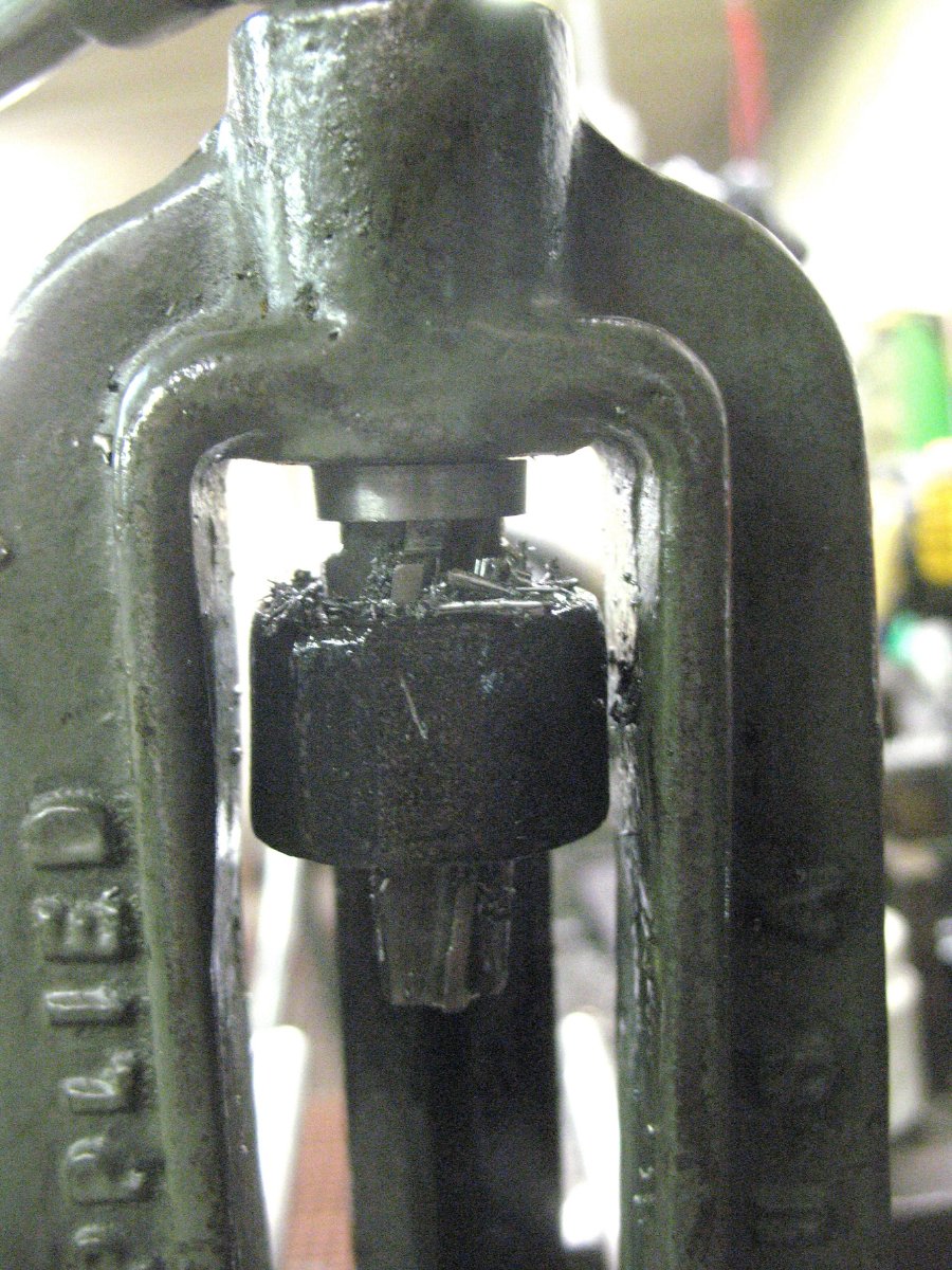

Post by Steve Jelf » Mon May 06, 2019 1:20 am

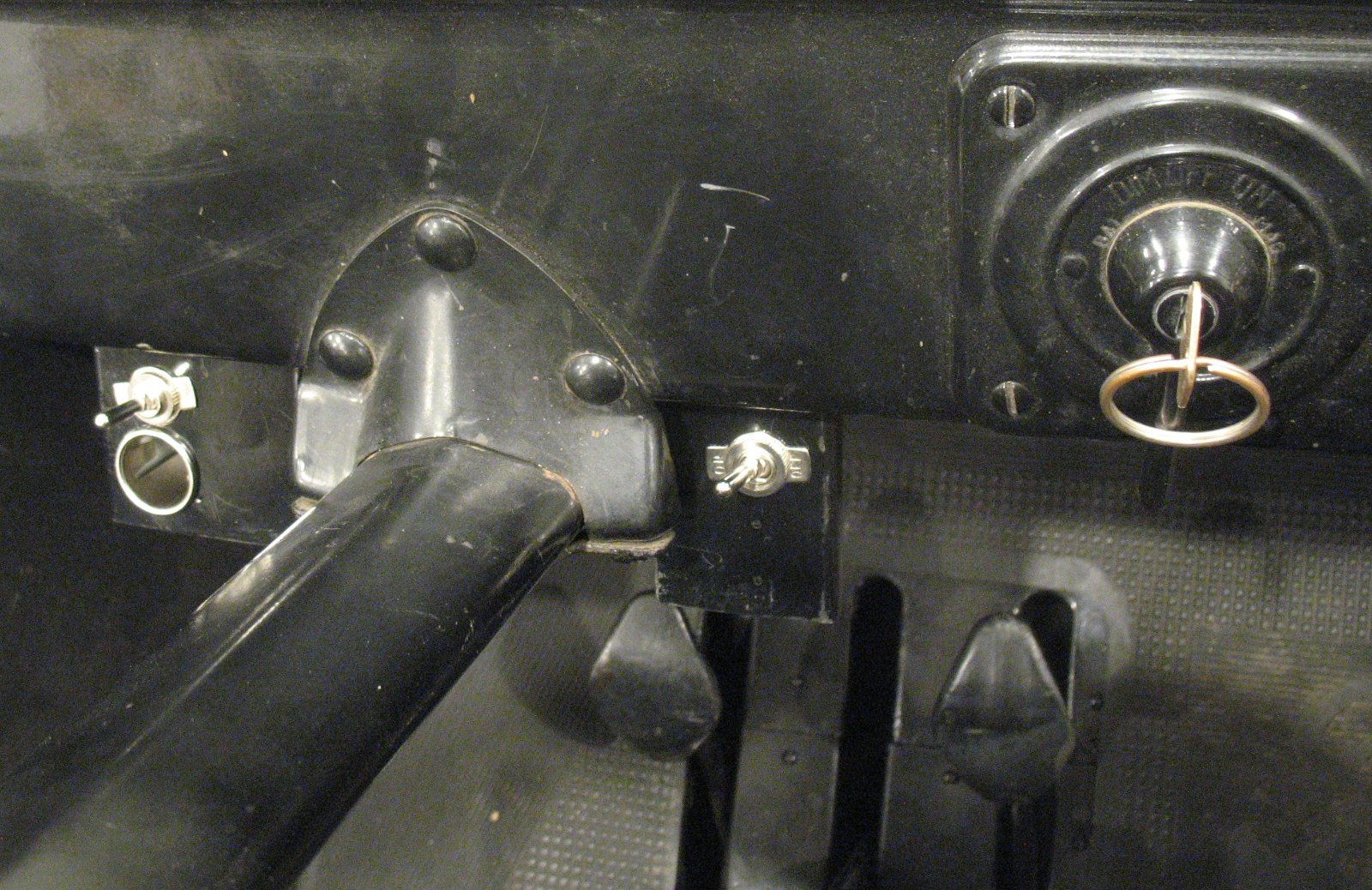

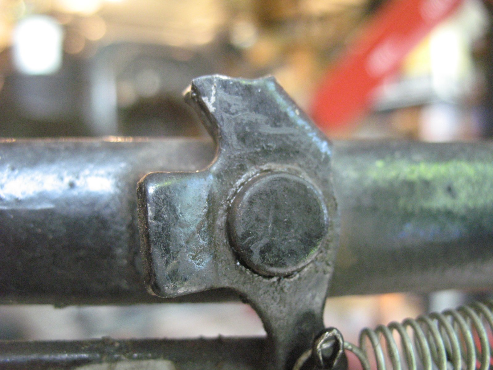

When the brake lever won't stay put it's at least annoying, and in some circumstances it can be dangerous.
The pawl was worn down to such a little nubbin that it wouldn't catch on most of the quadrant teeth.
Milt Webb's recent piece in The Vintage Ford suggested welding it up and grinding to fit, which is what I would have done anyway. Not having a good pawl for comparison, I overdid it a bit. When I installed the lever it had gone from moving too easily to not moving at all. I had to take it off and grind some more, reinstall it and try it, take it off and grind some more, etc. The third grinding got it right. With some filing on the quadrant and the pawl built up, my brake lever now stays where I put it.

Post by HaroldRJr » Mon May 06, 2019 2:22 pm
Steve - Just solved that problem on one of my T's! The hand brake lever pawl/quadrant thing,.....that's kind of a common problem that needs attention on many Model T's. I know you are aware of this Steve, and me too,....but my bit of knowledge on this subject is one of many of the things I've learned,....just by experience (some good and some bad) and by long-time reading of this forum.
It's pretty simple really,....proper use of the hand brake lever can all but eliminate problems, but I had to learn the hard way. When something wears over time, either the once sharp point of the pawl becomes rounded, or the the teeth of the quadrant wear and become rounded, or a combination of both. Makes one wonder which is harder metal, or, more specifically, which "SHOULD BE" harder metal, the point of the pawl, or the teeth of the quadrant. As we know, when either (or both) become rounded from wear, the hand brake lever can get to where it eventually will not "hold" when hand brake is applied, and this is "inconvenient" at best, and actually dangerous at worst. Actually, I'll try to explain why any hardening of either the pawl or the quadrant teeth is really a "moot" point if the hand brake is regularly applied in what I believe is the proper manner:
What I have had to learn (the hard way) is that the whole problem can be avoided regarding good quadrant teeth and a sharp pawl, just by making a habit of squeezing the latch while you set the hand brake, instead of just dragging the lever back and hearing the clicking of the pawl against the quadrant teeth as you set the hand brake. I'm of the firm belief that that "clicking" of the point of the pawl against the quadrant teeth is you hear as you move the hand brake lever back is what causes most (if not "ALL") of the wear of the pawl & quadrant teeth, and it is completely unnecessary and can be completely avoided by just squeezing the latch as you set the hand brake, and releasing the latch only when the hand brake lever is pulled all the way back. The point of the pawl will never wear just from a stationary position when engaged between two quadrant teeth, but I guess most people just like to hear that clicking or "buzz" of the pawl clattering against the quadrant teeth as the hand brake is applied.
Much too "wordy" here as is usual for me, but I really believe this is an important issue and just one other good Model T driving habit that can totally eliminate a common and sometimes even dangerous problem,....FWIW,.....harold

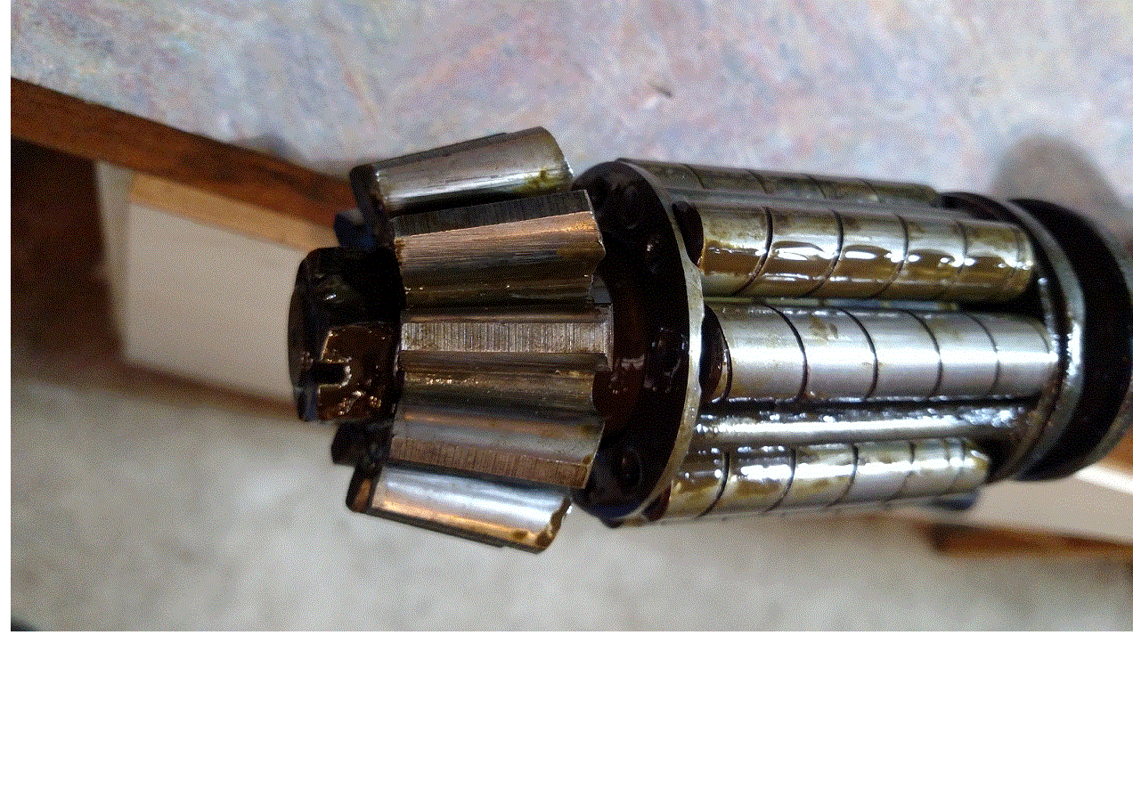

I started to disassemble my spare rear end and torque tube. I've already salvaged a couple usable parts and now I found a near-perfect pinion gear to replace my current paperweight. The bearing is worn only about .001" to .002" but I plan to install a Fun Projects sealed bearing.
Thanks for the parts Dave and Tim!

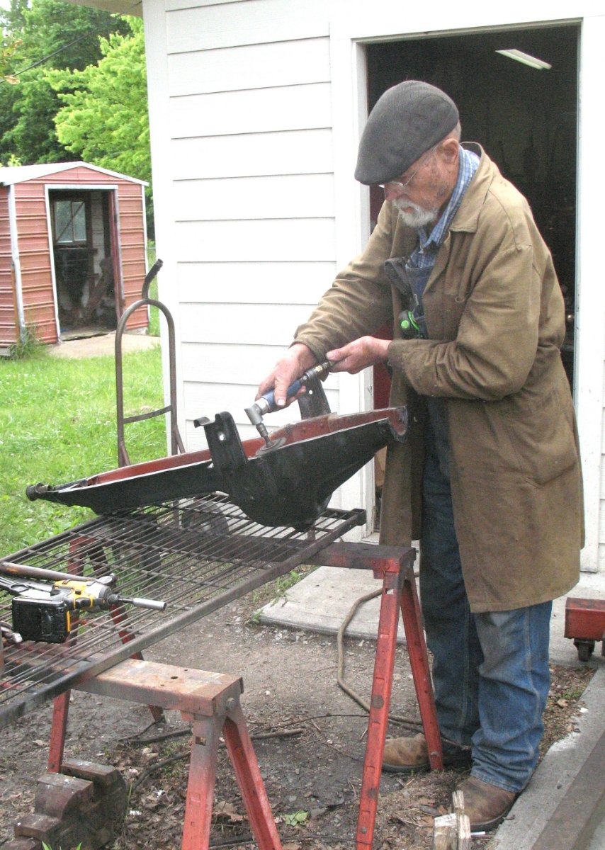

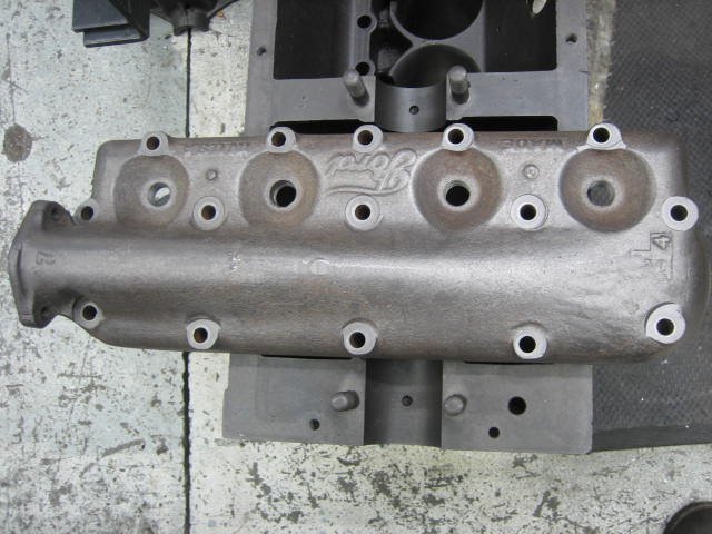

Post by Steve Jelf » Sat May 11, 2019 10:20 am

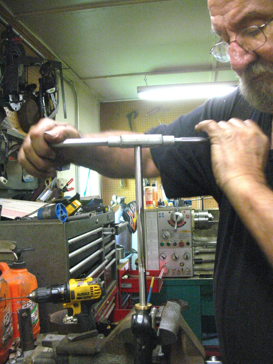

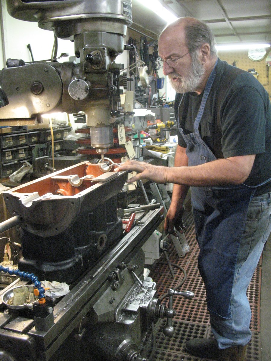

Change of plans: I'm going to look for a better axle. For my work day at Mike's I did mostly grunt work, sandblasting and cleaning. Mike handled the jobs that take skill and knowledge. :)
Machinist at work.
Taking off a sharp corner.
Removing old gasket and sealer.
Checking the pan. It was straightened a few years ago, but is a little off now. I wonder if that big pothole in Chicago bent it. I suspect that very few Model T's that get driven have perfectly straight pans.

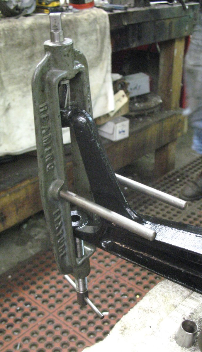

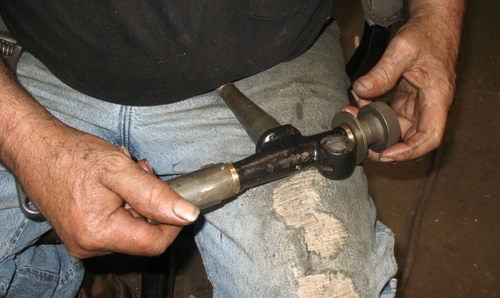

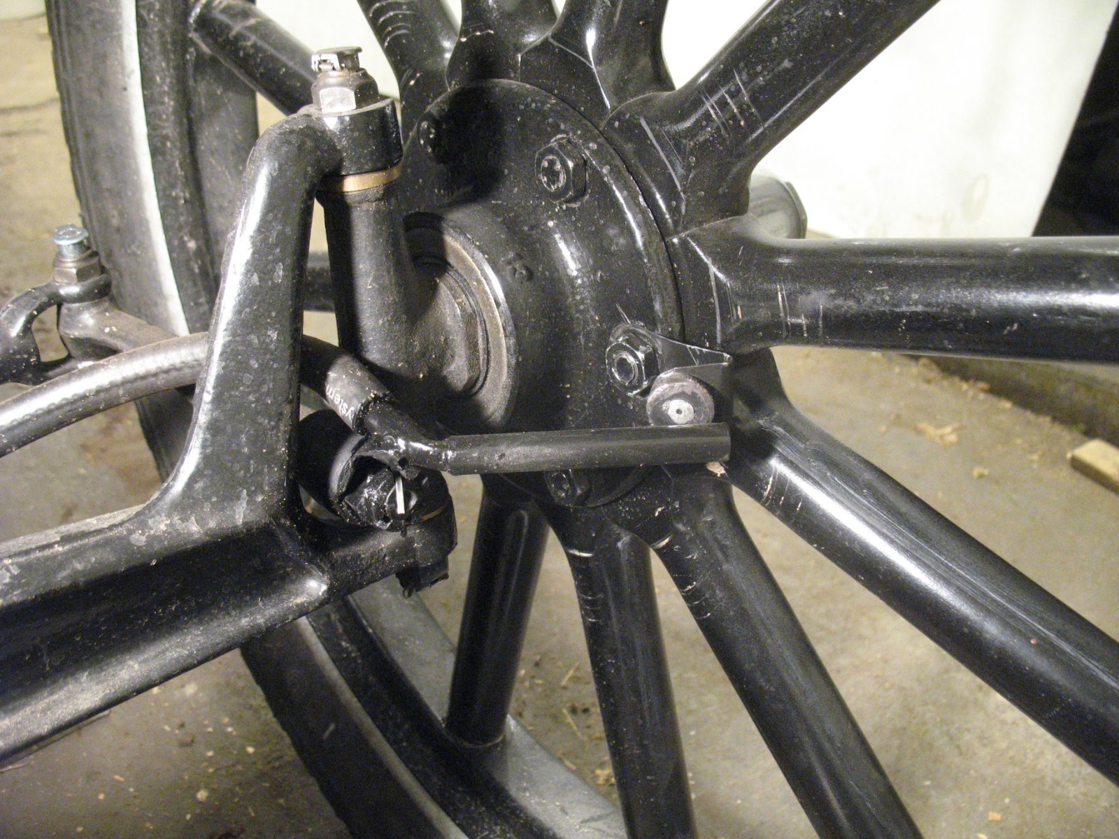

Mike Bender suggested I replace the bent front axle from my runabout with a better one, so this morning I went to the parts pile out back and found a straight one, then spent the day removing rusted-on parts: farm wagon tongue accessory, wishbone, spindles, perches. Pretty tough going. One perch left to do.

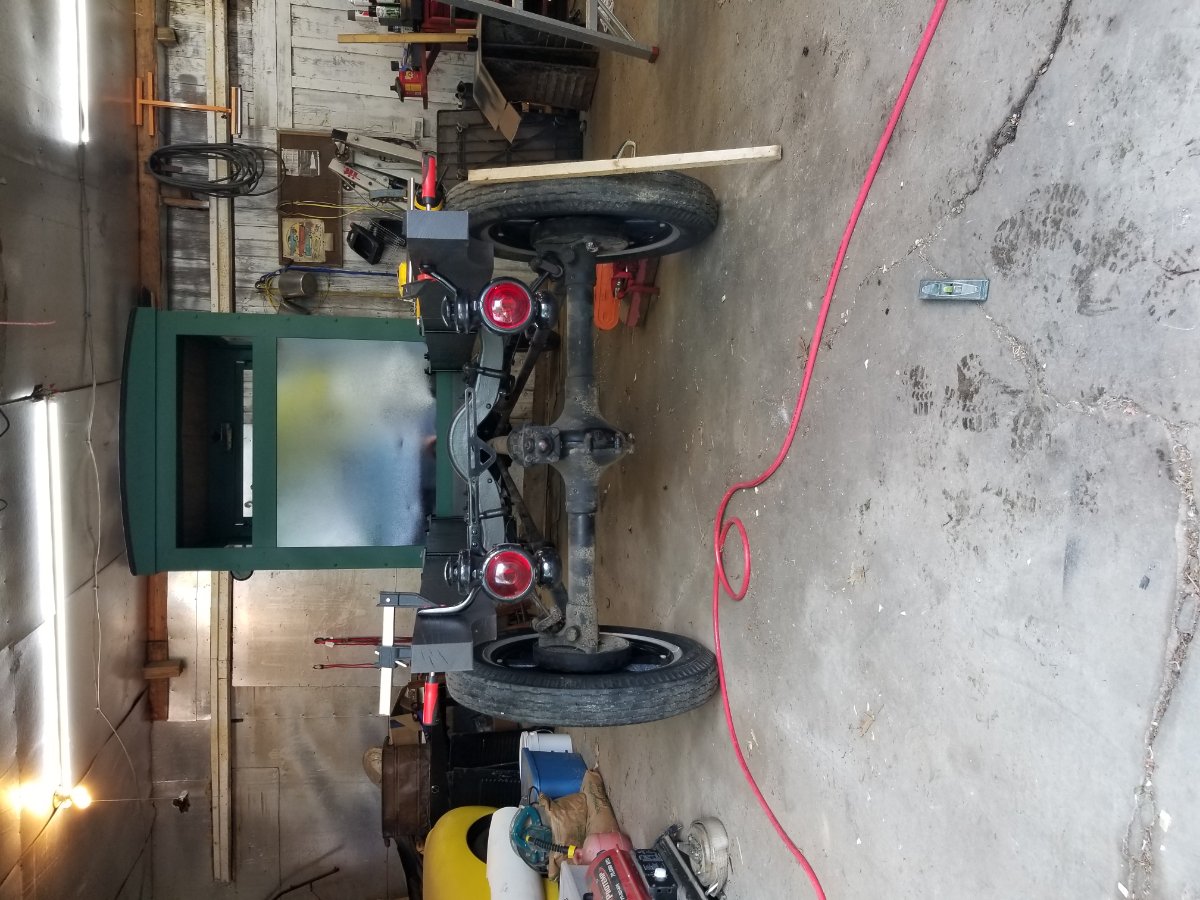

Post by 1925TT » Wed May 15, 2019 10:54 pm
The tow truck is coming together. After some body work on the fenders it should be hitting the road. It's been 5 years in the making.

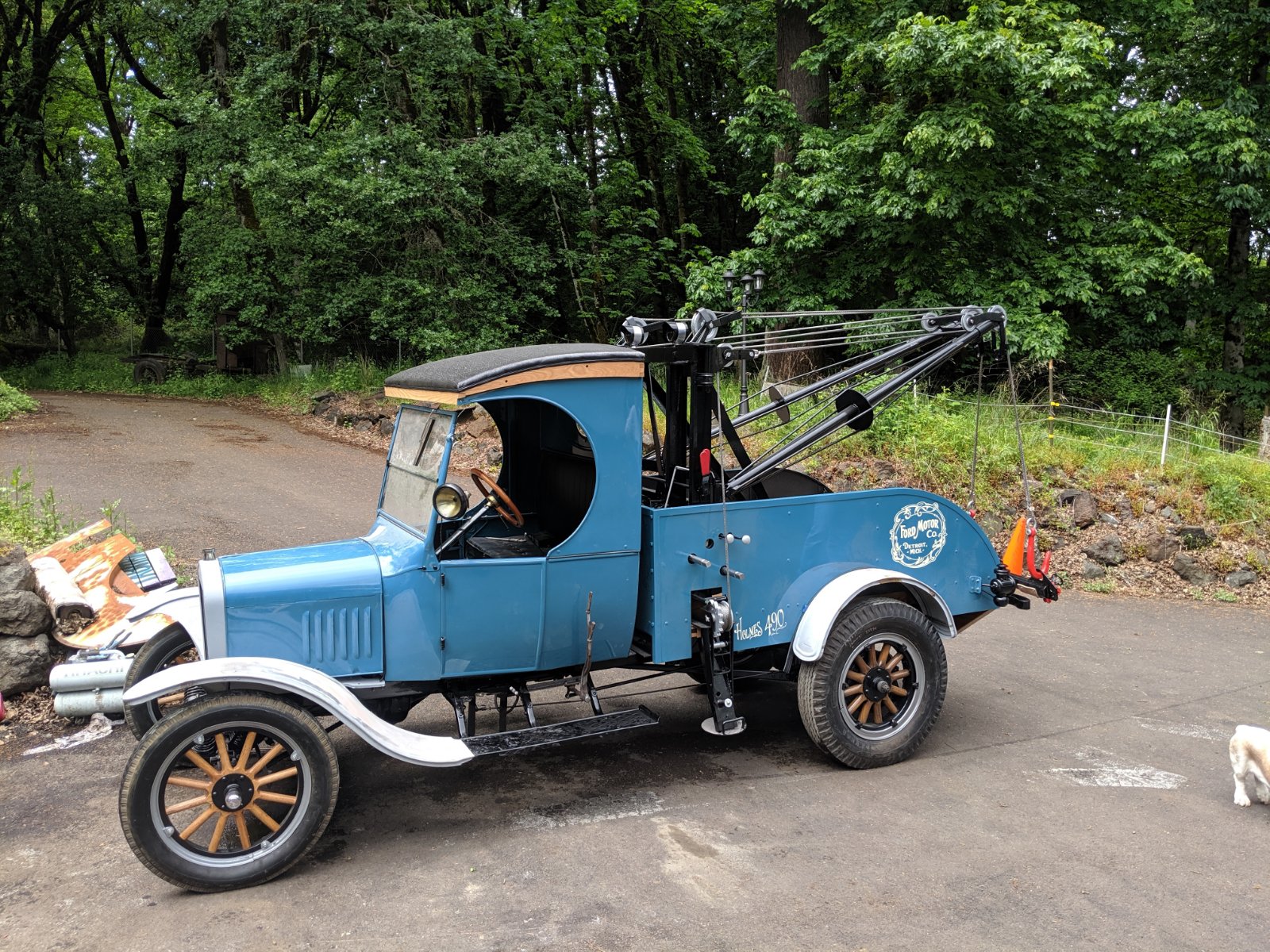

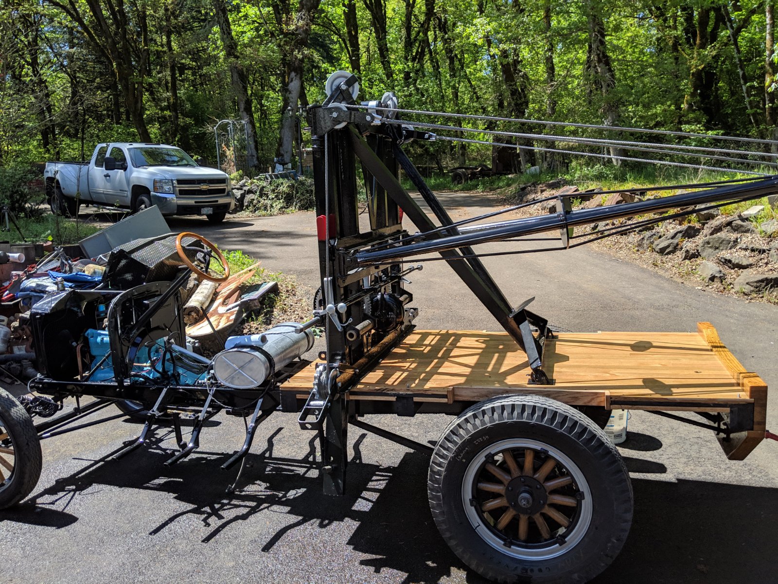

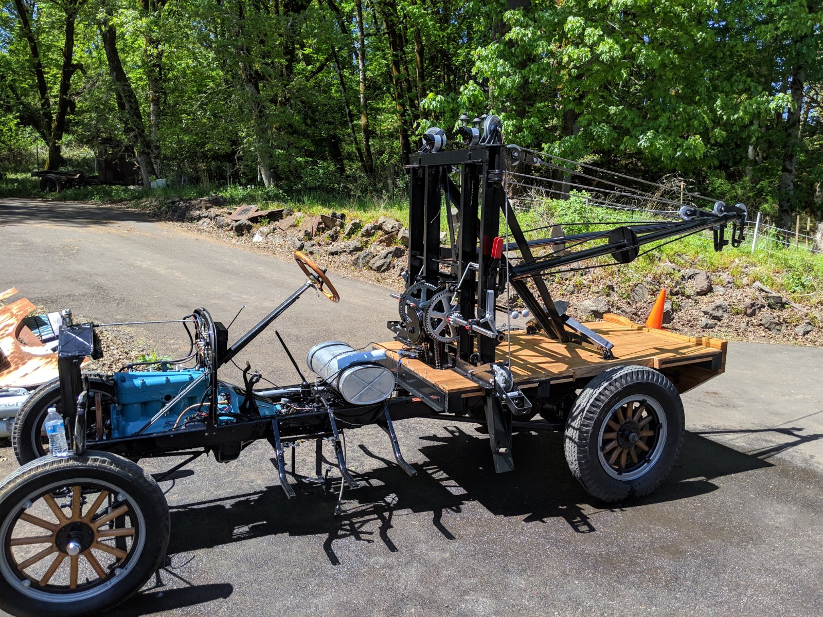

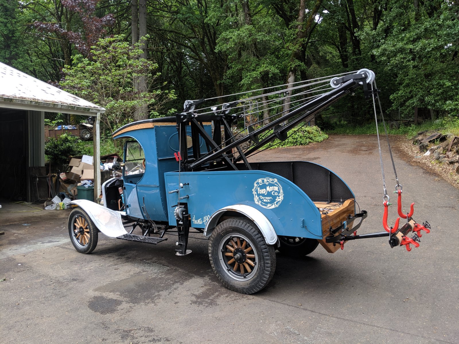

It's a Holmes 490. Hand operation or cone clutch.

How cool is that. Nice job!

Wow, looks like a first class rig!

Procurement for Ellie Mae. She is not ready for all of her accouterments yet, I am still road testing, but an auction came along so I bought some old stuff. I think she will look good with a cross cut saw hanging from her side, a milk jug, a whiskey jug of course, a couple of cow bells, some lanterns, and a barrel roped to the fender like Jethro had. I ended up with a lot of other stuff, most I don't need, and some I don't know what it is for. But Ellie Mae will be well decked out!
The guy lived in Amelia Va. and had stream across the back of his property. He was on the edge of the mineral belt which runs through central Va. A guy at the pickup told me that the owner used to get a lot of tocks out of that stream and found an area where Indians used to make arrowheads. The picture of arrowheads is just a few of the many I found in the various boxes I bought at auction. I know nothing of arrowheads, but they are neat.

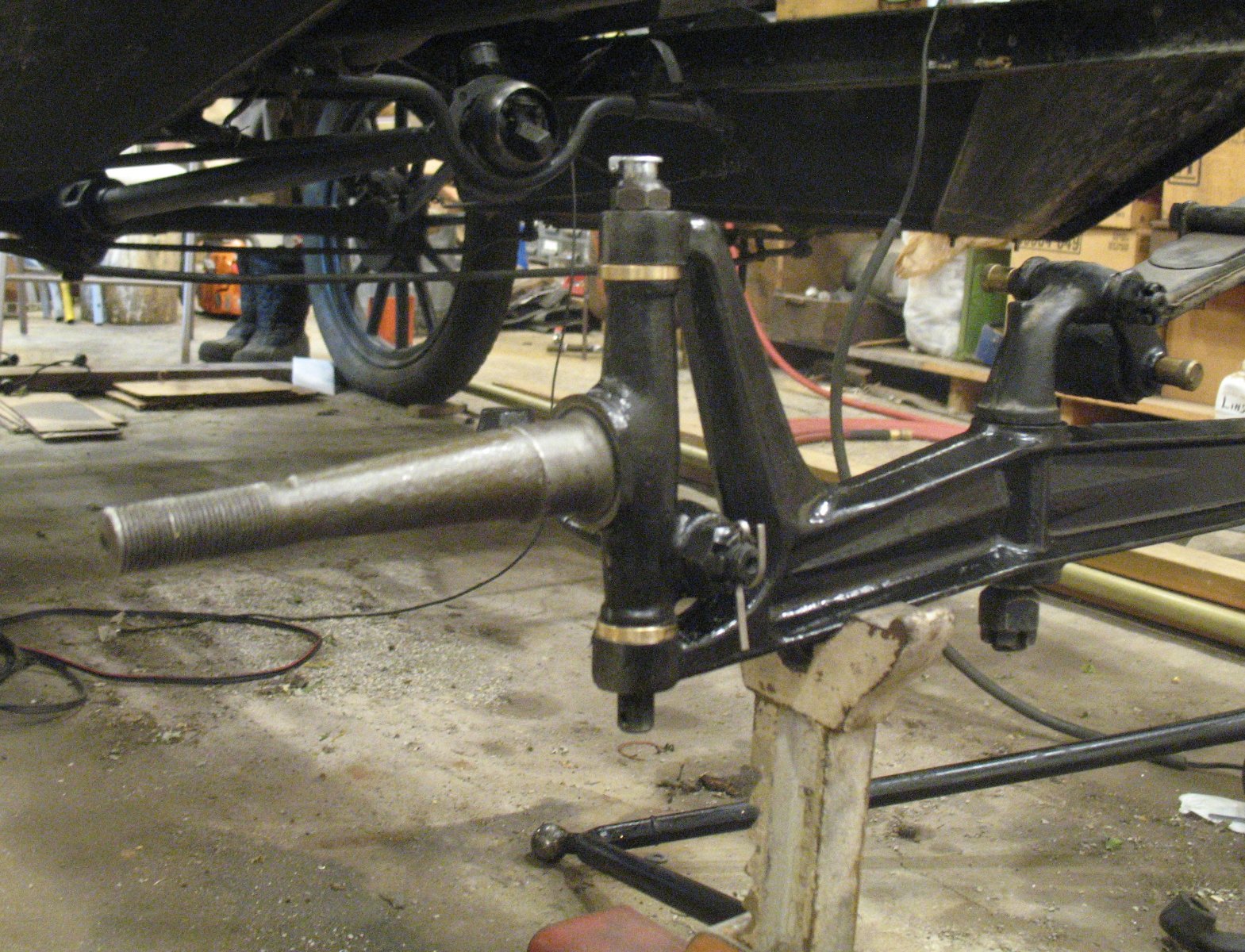

Part One

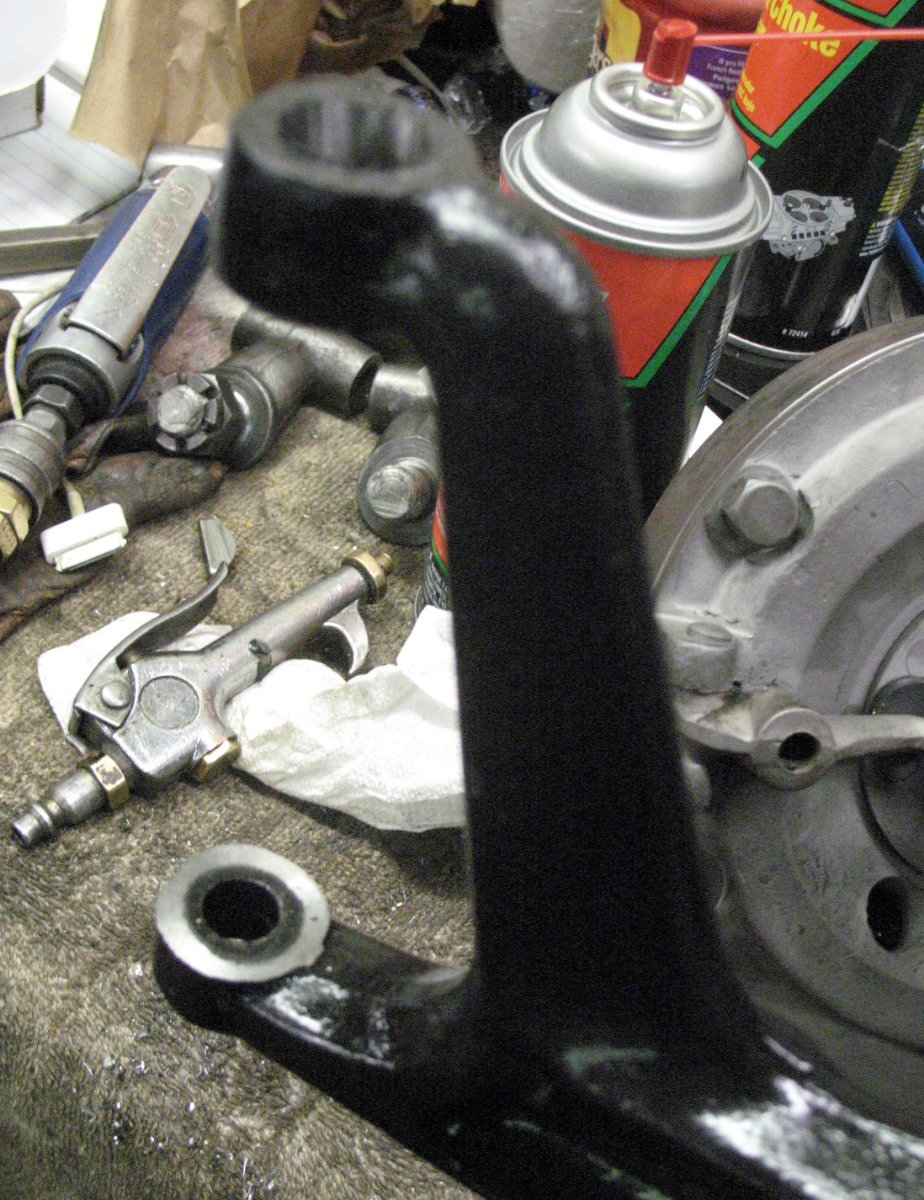

Friday I went for another work day at Mike's. We spent half the day trying to get rid of main shaft run out and never did get it under .002". So we decided to take a break from that and do spindle bushings instead.
I'm using a "new" axle in place of the bent one that was on the car. It's nice and straight and has good threads, but the top holes were wallowed out and we used the Stevens tool to fix that.
The fix is a tapered bushing that the spindle bolt will fit.
A tapered cutter adapts the hole for the bushing to fit, and a screw at the bottom takes up the slack and keeps it aligned.
The cutter has to go in all the way. In fact, more cutting was required to make the bushing fit into the hole. Luckily Mike had a bigger cutter to finish the job.
The bushing stands a little proud so the bolt will press it into the hole.

Part Two
Pressing new bushings into the spindles.
The spindle bushing reamer is really two in one. The bottom one cuts the bottom bushing to pilot the shaft, and the larger upper one cuts both bushings to fit the bolt.
This shell cutter flattens the surfaces where the bushing faces will fit.
That's flat enough.
The final step is cutting the bushing faces to fit.
Posts: 7413
Re: What are you doing with your "T" in May
Post by Steve Jelf » Sun May 19, 2019 11:12 am
Part Three
The axle is back on the car awaiting more reassembly.

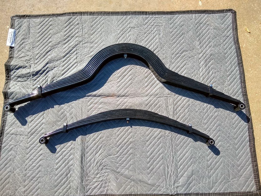

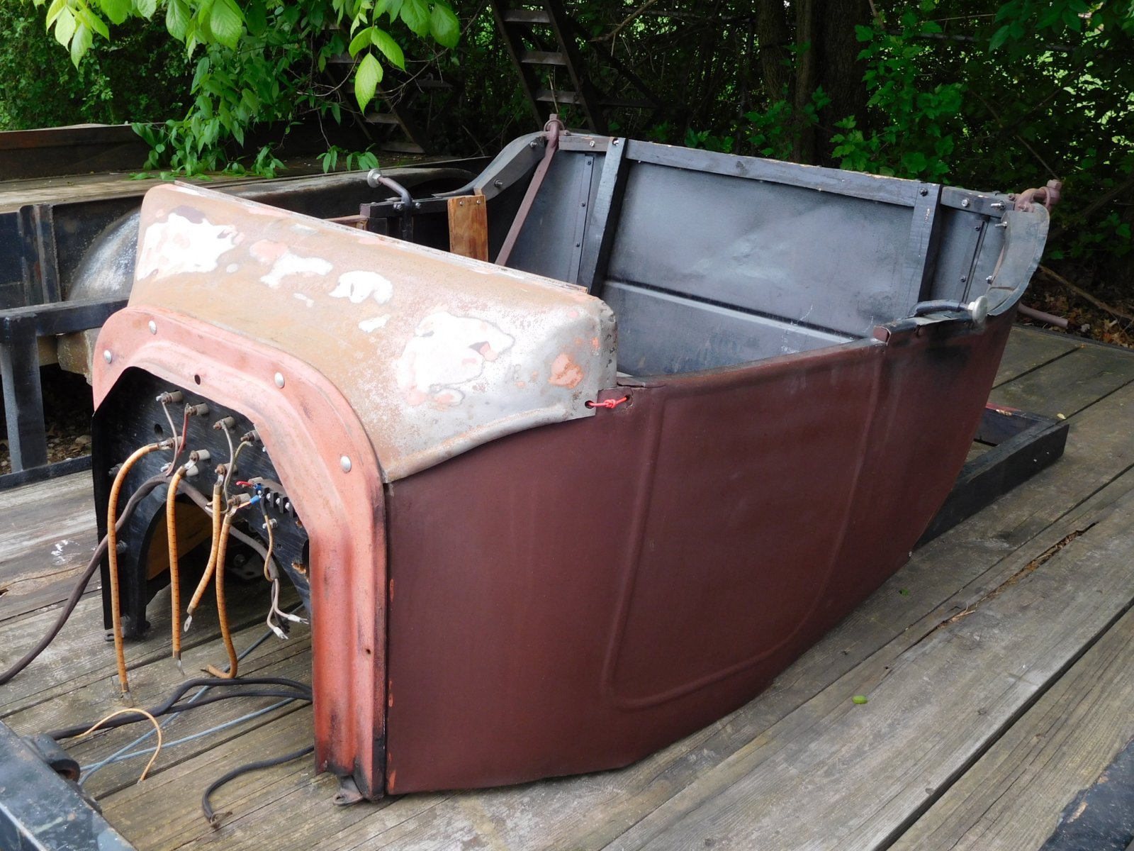

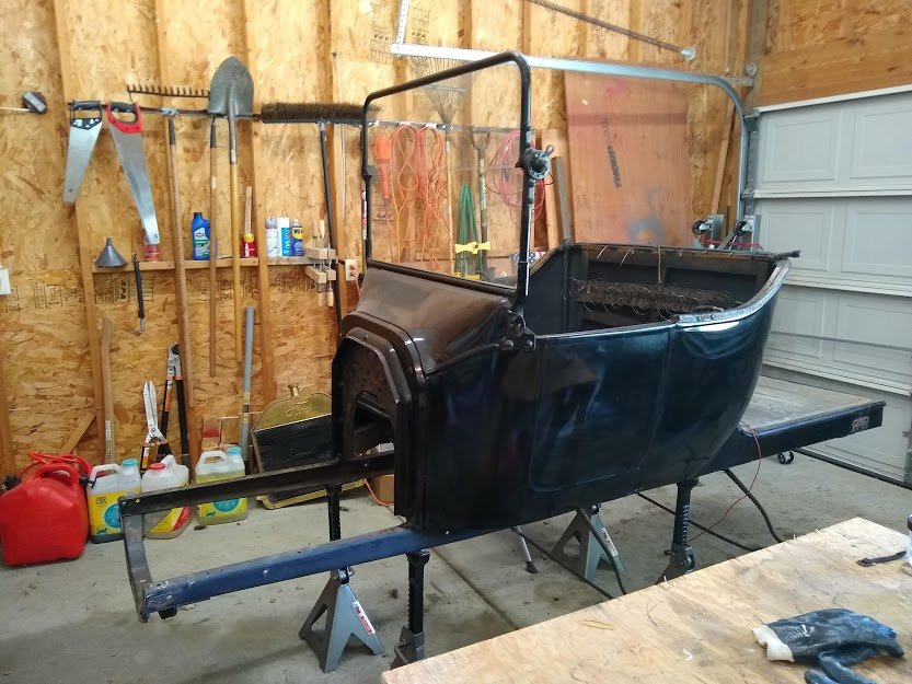

[image][/image]I have been able to make good progress so far this month on my 15 runabout restoration. Progress includes:
Getting my non demountable wheels back from Stutzmans. They finished them in less than 3 weeks. They do beautiful work! Current pricing is $190/wheel for correct year spoke and felloe shapes. I provided the wheel hardware and splice plates. I used appliance epoxy paint on the hub parts and bolt heads, but left the rims in primer because, based on past experience installing tires, I will likely nick them up a bit installing the new tubes and tires!
Got my fenders, headlights and splash boards low pressure/high volume media blasted by a company specializing in this process. Very reasonable price with no damage to the parts. I've since etch primed them. This was a very old original restoration, and there is some lead work on the front fenders around the area where the three rivets attach the brackets.
Finished removing everything from the body. I felt like I was working on an old piece of furniture instead of a car when I removed the upholstery and top. It is amazing how small a runabout body is once everything is removed.
Also got my running boards and leaf springs back from the blaster/powder coater. Reassembled the springs after applying slip paint between the leaves. After mostly disassembling for the last two months, it was nice to finally have something restored and finished!
Mike Bender has also been making progress on my engine, with getting the babbitt poured and the block and head machined.
We are working hard to get the restoration complete by the car's 105th birthday at the end of September.

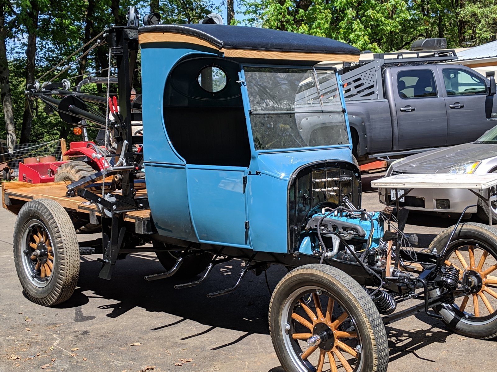

All of the blue is Done. Now to finish up the body work that will be black

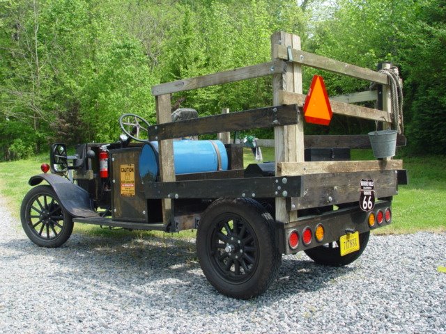

Bi-weekly trip to the co-op for feed and fuel. I almost grabbed a bungee cord to secure the gas can to the runningboard carrier, then thought it would be better to be "period correct". A length of sash cord not only worked better, but looks better !
"Get a horse !"

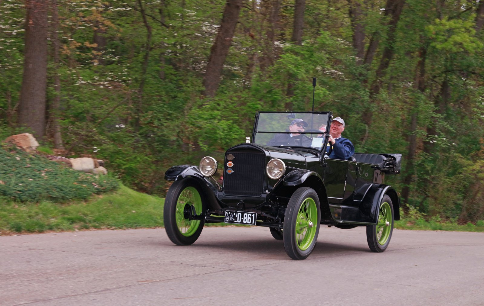

I drove my 26 in the Gilmore Museum tour. A photographer along the route (Museum volunteer John Lacko) shot this photo of me and passenger, Museum Education Director Fred Colgren.Folks, this is a do not miss tour.

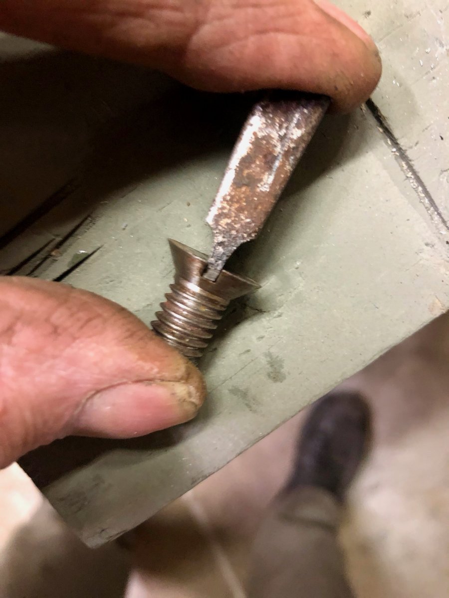

I started to rebuild my generator but ran in to a problem right off the bat. I did not have the correct tool to remove the field pole screws and I made matters worse by using the same method as the last guy, a punch and hammer!
I did manage to get one loose, but the others would not budge. So I sacrificed one of my extra chisels to make a "tool" that would work and fit the new screw correctly to reinstall.
I then put it in my vise to hold the tool tightly to the screw.
I tried using the 3/8" end wrench that fit the shank but I didn't have enough leverage. So I added some vise grips and a piece of 3/4" EMT conduit for added leverage.
SUCCESS! the rest broke free easily. Now to get every thing cleaned up and ready to assemble.

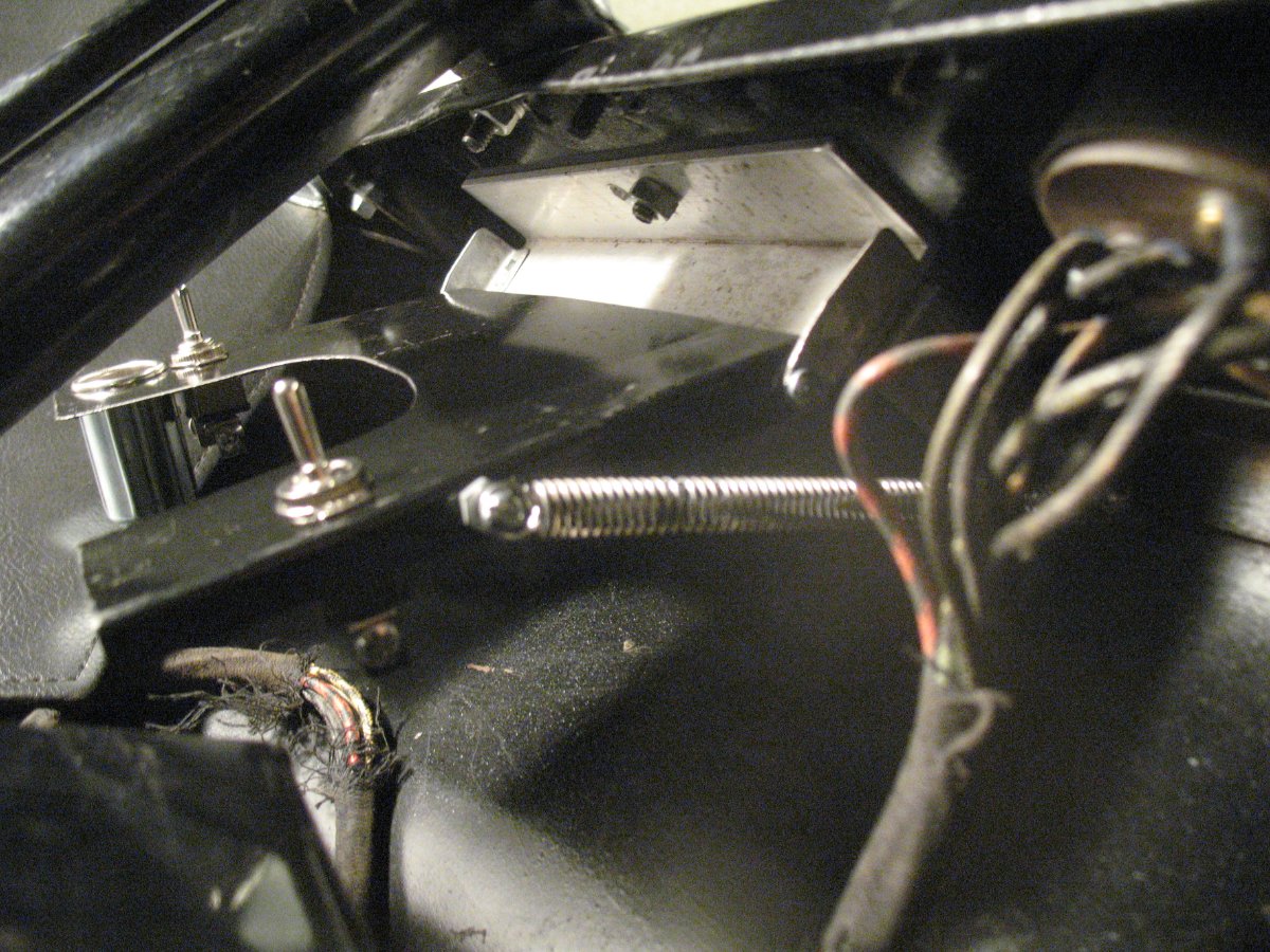

Yesterday and today I worked on an instrument panel for my 1923 touring car. I installed it this evening, but I still need to do the wiring.
Under construction. Making the thing is the easy part. Mounting it behind the dash is something else. Working on anything behind the dash of a car is torture.
On the left is a switched outlet for a phone charger. The switch on the right side is for a speedometer light. There's room for more switches if I want to add more accessories.
When it's not needed it flips back under the dash out of sight.

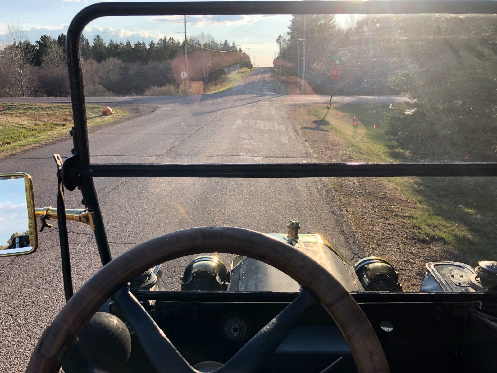

Took T to Walmart for potatoes and lamp oil. Got both. Headed back home. ~ 6 miles one way. Good trip.
Tried to post a pic, but my right side up pic on my iPhone looks upside down here.
