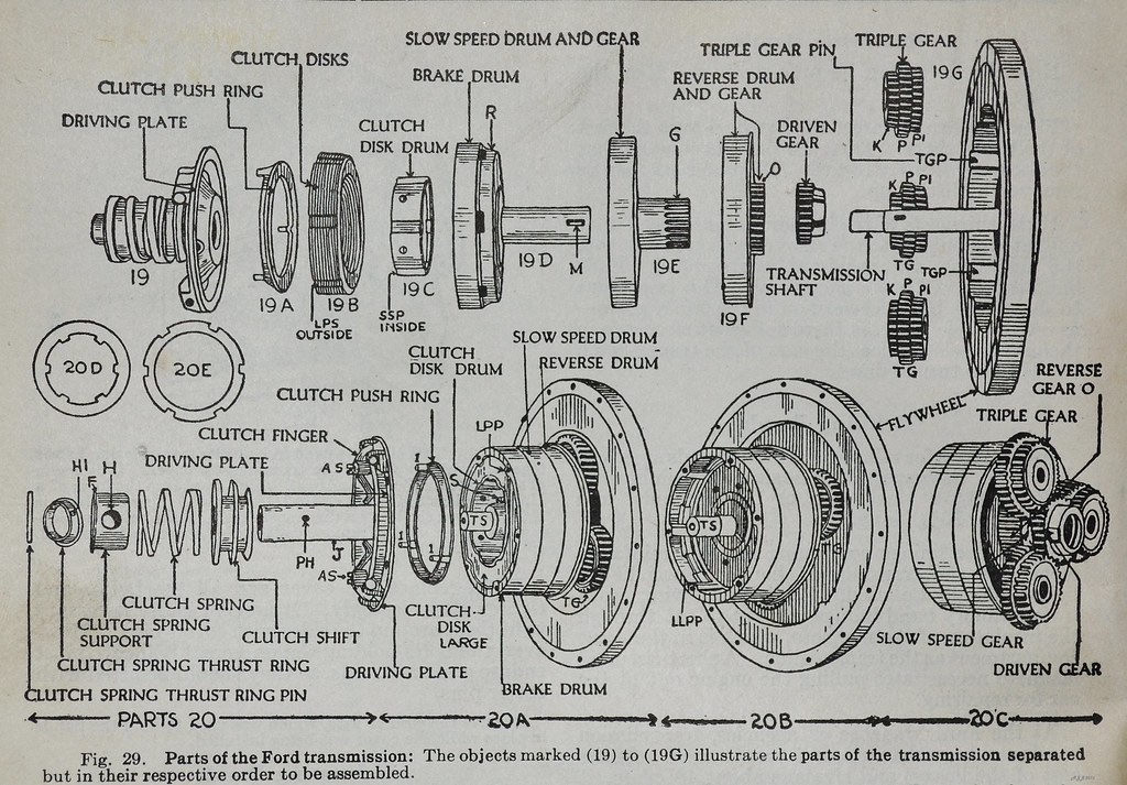

I am in the beginning of an engine tare down for rebuilding on a 26. When unbuttoning,…removing the hogshead, it became apparent that the front of the ball cap had been touching the clutch spring support as both surfaces are scored.
This engine has been rebuilt not many miles ago, and has some other issues so this is not a huge surprise.
Wondering if anyone has a reference dimension for the driving plate position, how far should it extend in relation to the rear of the crankcase ?

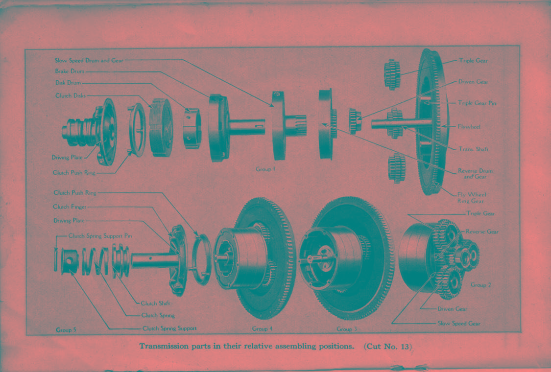

Exploded transmission drawings:
