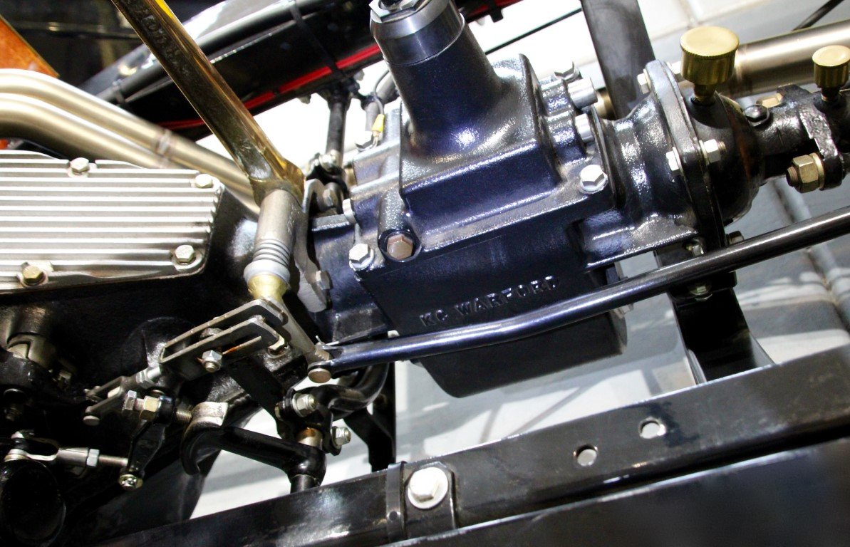

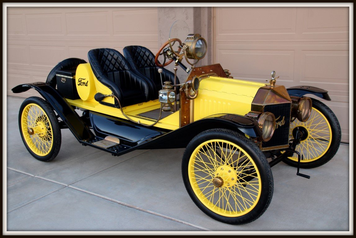

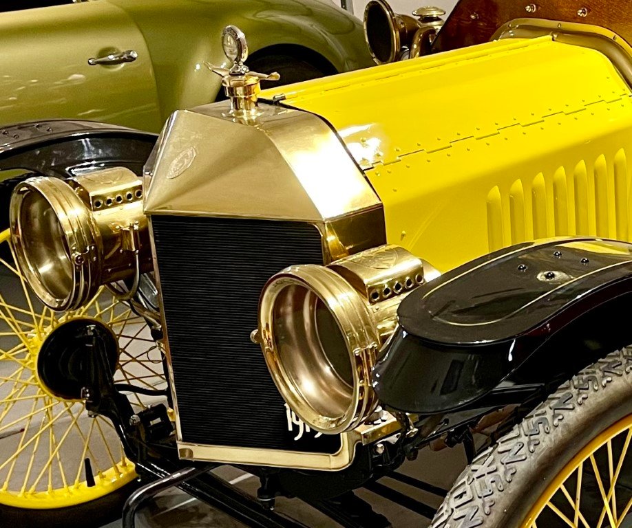

Excited about purchased a 1913 Speedster with some exciting upgrades! It is in transport to me. But the online dealer has no knowledge of parts worked into it except
5 McClaren wheels (new)
KC Warford (new)
Brass Livingston Vee Radiator
Large brakes
Alternator
E&J headlights (converted LED)
Electric Starter
Spotlight
12v System
"Fatman" steering wheel
Under carriage, fenders, black powder coated
Engine completely rebuilt
Questions:
what upgrades to the engine?
what brakes are on it? I an tell it has larger drums, like 1927 and 1926
what else?
who built it and how can I talk with them?

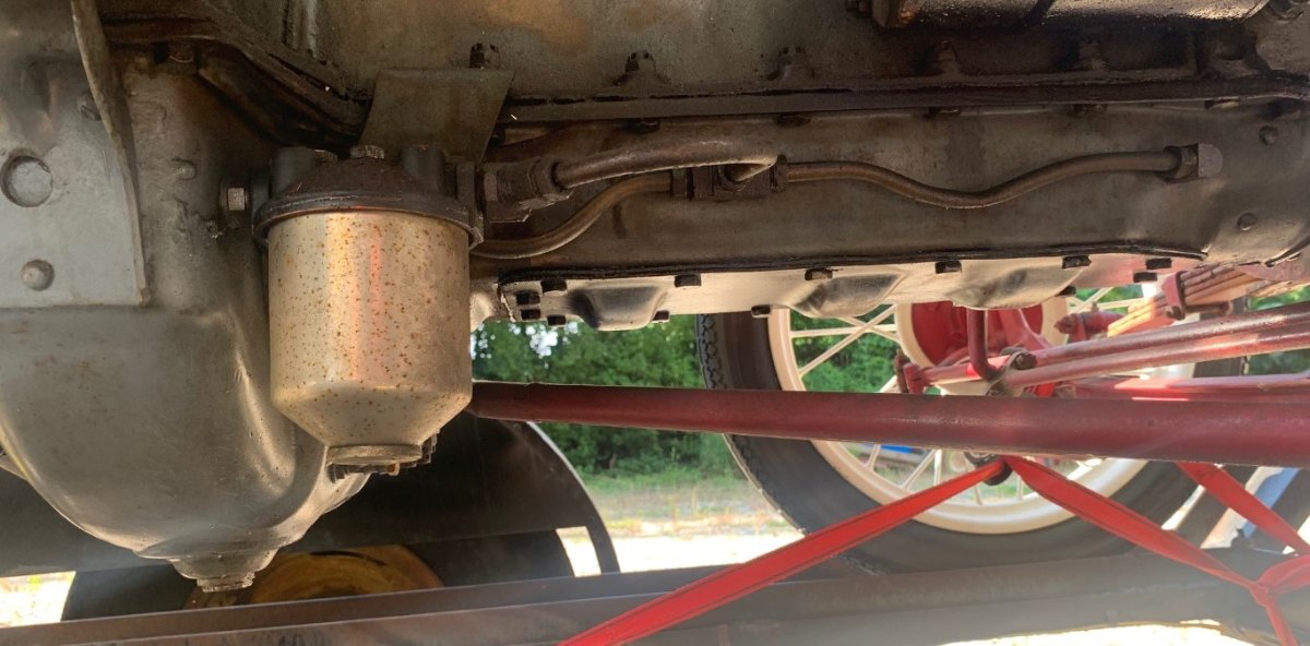

Additional pics

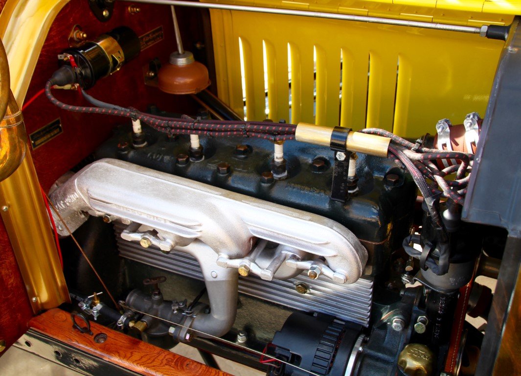

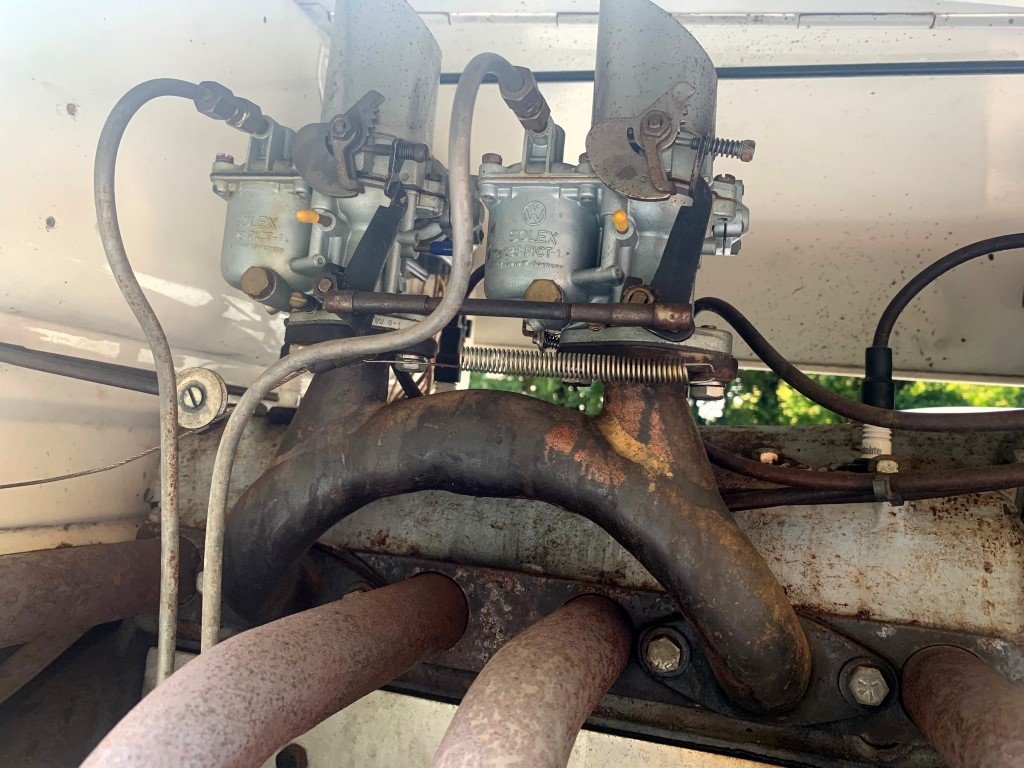

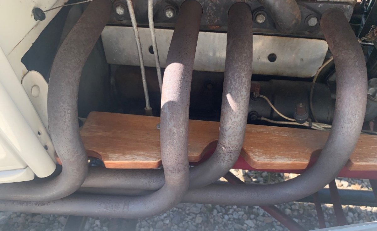

Wow sure is a nice looker, looks like dual exhaust a new Warford & ruckstell plus new Rocky Mountain brakes. Hi volume intake & straight through Nh carb.
There’s a lot of eye candy there. I also believe I saw a distributor set up based on the coil inside the engine bay on the firewall but not sure because of the master coil. I think you may be having some fun soon.

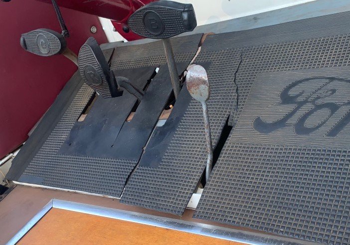

Does the dealer know where he got it? Maybe that person can tell you about it, or steer you to somebody who can.
I see two extra levers. One is the Layne Warford, and the other has a rod toward the rear. Ruckstell?

Yes, Steve, it also has a Ruckstell.

A lovely looking speedster. I have no idea who built it but they appear to have done a very nice job. It is so clean I would say it has also not done many miles? I am a little perplexed as to why someone would install both a Ruxstell and a Warford? For such a light car and with a few mods, Henry's original 2 speeds are more than enough. Good luck with finding out who built it. I have always wanted something like that.

The best thing about this little speedster is that the original builder spared no expense or effort in building it. McLaren wire wheels were OVER $700 EACH when I bought my set in 2002. The quality of the build appears beyond reproach. Everything on the car looks like it was VERY WELL DONE. You appear to be getting a car that will be very capable, and a joy to tour with. I hope you spend many happy hours and miles seeing the country the best way possible - from on top of a Model T!

Likely an unpopular opinion here, but here goes.
What I see is a part salad.
If the engine is NOT a 1913 it is not a true '13 speedster. Is the frame a '13? Is the rear end a '13?
I would love to see a TRUE '13 speedster.
Fakes such as these are corrupting the idea of a '13 speedster.
Thus these should not be held in high esteem.
The excellent workmanship I see here ought to have been done on a car that is worthy of it.
The original builder is clearly an artist--why not build an above average black-era speedster or a 26/27 speedster (whatever year the engine/frame is)?

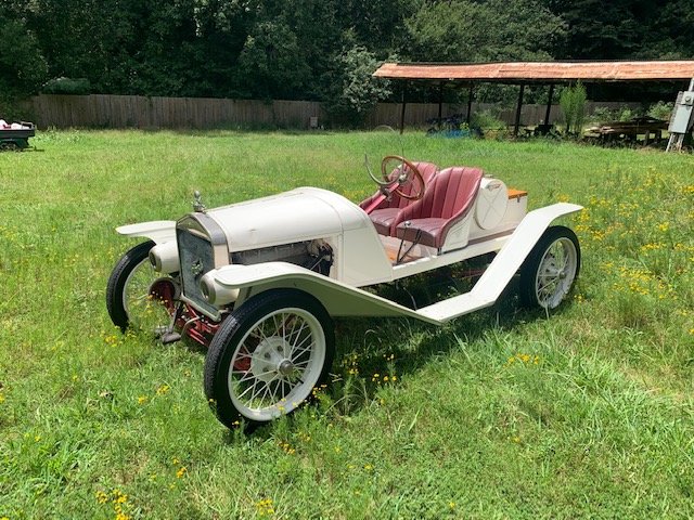

My other speedster (1927) owner died and did not leave documentation. Working around from an outside filter and an oil pressure gage. A Model A crank. Possibly balanced. I guess it has drilled passages. Have high compression pistons (had the head off due to leaking gasket) and dual Solex carbs and custom exhaust. Ruckstell axle. Obvious things.
But the joy is the detective work that we all like to do about our toys. Too bad they can't talk!

Yellow car is beautiful! Original 13 or not someone put some $ into that.
Warford and Ruxtell does seem like overkill tho.

Just real nifty to look at! The builder did great work, from the pics can see it has a ‘26-‘27 engine block, elec start, alternator. Intake is repro large alum, looks like ‘straight thru’ Holley NH carb too. Should be a bunch of fun, and some brass rubbingCatbird wrote: ↑Mon Jan 16, 2023 4:50 amThank you for your opinions. I am still waiting delivery. I suspected it is not a true representation of a 1913 Speedster, but it is very well done. The dealer I am buying it from may not be a true Model T expert. Neither than me. But the car has a certain naïve charm. A large amount of money has been well spent. Not sure what money has been done to the engine, but imagine. . . . . . . .
Let's see when
Check over all fluids and grease all before running as may need overall maintenance. Only other odd is that brass steering wheel spider, looks like it has dome cover for cosmetics? Can’t see the typical steering wheel nut that captures the wheel spider center to remove the wheel and gain access to the steering cluster underneath to lube its gearing.
