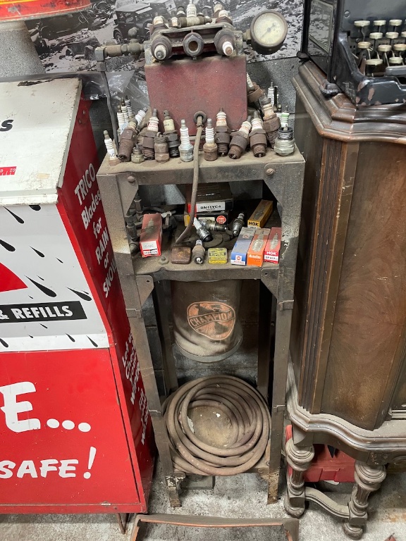

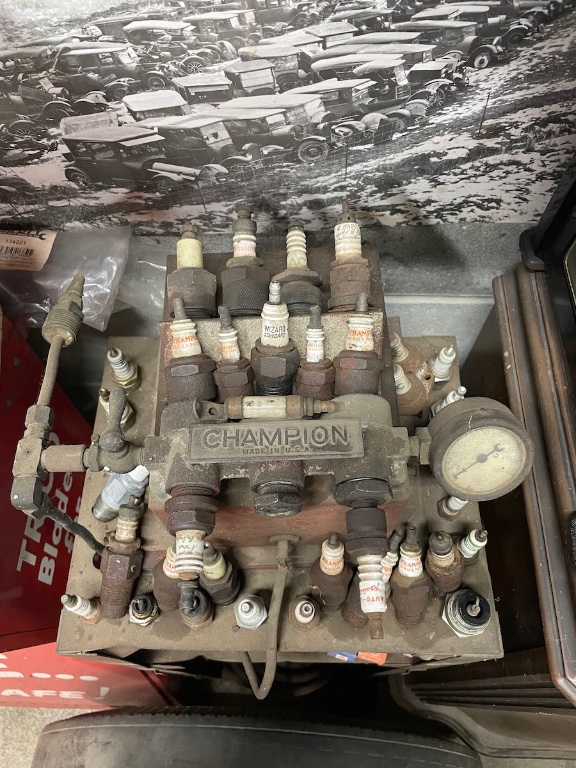

Posts: 8633
Re: How do you clean Champion X plugs?
Post by TXGOAT2 » Sat Jan 14, 2023 1:47 pm
Nice radio. What brand is it?
Post by su8pack1 » Sat Jan 14, 2023 8:12 pm
Carlton.
