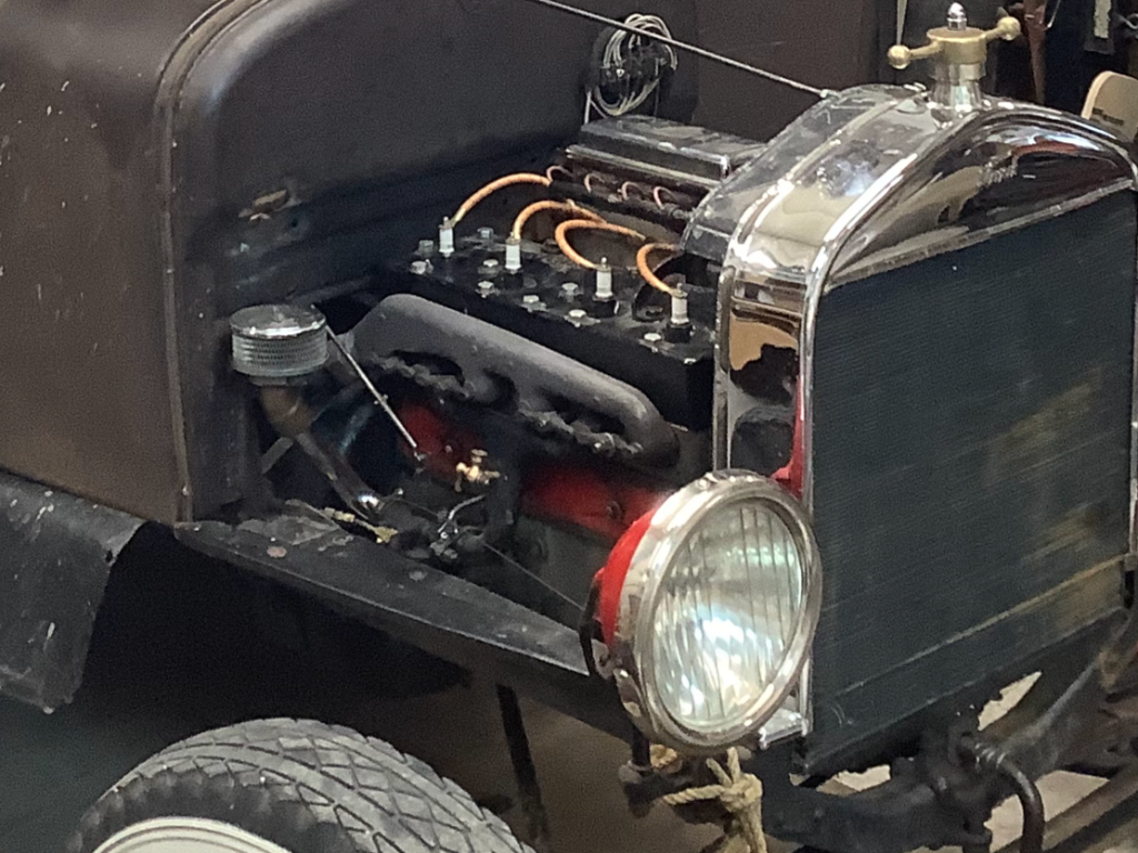

The problem with this item is it makes it really hard to install a air cleaner which I want!

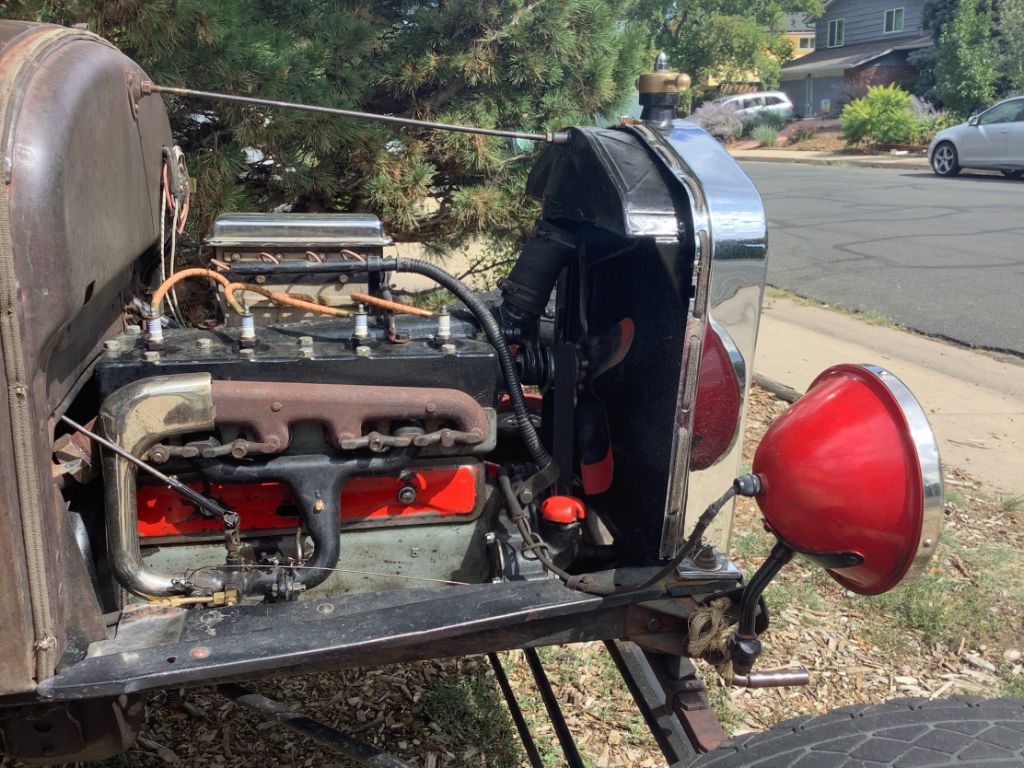

Funny you mention the air filter! I drove the $#!* out of the no hood, no fenders roadster around the very dusty, gravelly industrial park like a rally car when testing it for traffic worthiness. I figured an air cleaner would be prudent and tried to send it up by the exhaust (yup, with bathroom plumbing, haha) to at least get fairly hot air. I briefly considered a screen or some chore boy in the new heat stove but would hate to have any material sucked in! The hot air pipe is pretty far up and away from the road but on a really fresh engine build I think I’d try to figure out a combo. New everything deserves a dirt free mixture for sure. Mine is ummm, “experimental”…. Really any air down by the exhaust is pretty hot, but I noticed a big difference with my engine that is “medium” fresh, and our local weather, which is different every few minutes….-Chris, in Boulder

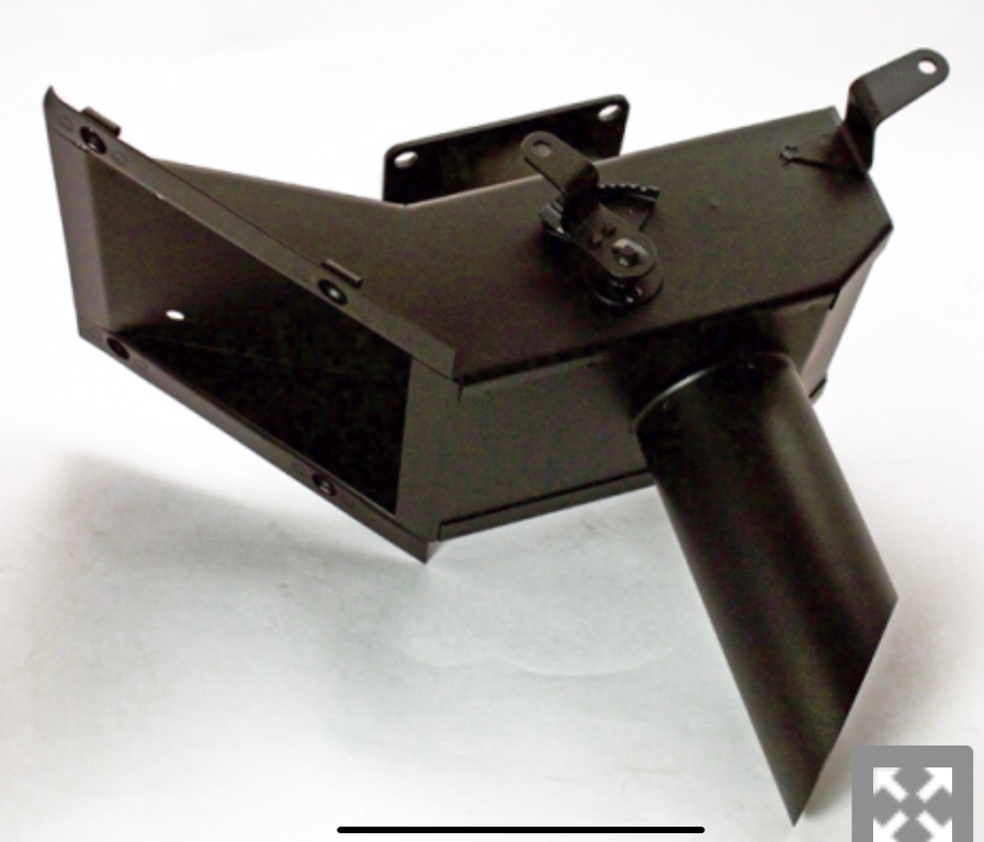

Typical aircraft carb-heat box. In my mind, this would LOOK very period correct on a T.

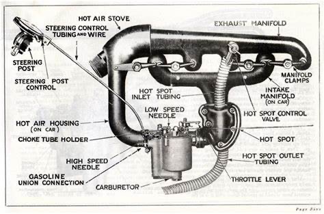

The Stromberg OF SET UP has a press steel unit that wraps around a portion of the stock intake manifold, in addition a steel flex tube attached to the exhaust manifold via a piece that is tapped into the EM somewhere between the 1 & 2 cylinder. That tube then runs into and then a separate flex tube coming out of the stamped piece on the intake to preheat/vaporize the fuel before it enters the combustion chamber. I always thought that was a much better way plus you could put a filter on the carb if you’d like. The problem is those pieces are hard to find. I don’t think it would be difficult to mimic that system though. Dan McEachern has a wilmco combination exhaust for sale on the classifieds that appears to have had that setup attached at one time. In theory I suppose the radiant heat from the pressed steel piece would also warm the carburetor a bit. I’d post a picture of the exhaust Dan has but don’t have his permission to. You can go to the classifieds though and see his post.

Thanks for posting the Stromberg set-up John. Actually, the Stromberg OF and RF along with the Rayfield UF, the Wheeler-Schebler FAX8 and FA2, and the U&J carburetors designed for the "T" all were sold with a provision for manifold heat and detailed instructions as to how to install it. Along with this, every Model T Ford sold new (after 1910) came with a heat pipe, and now we're questioning if it's really necessary. What am I missing??

Bruce if those guys knew what they were doing back in the day you’d probably see those vehicles still around. Your not missing a thing
