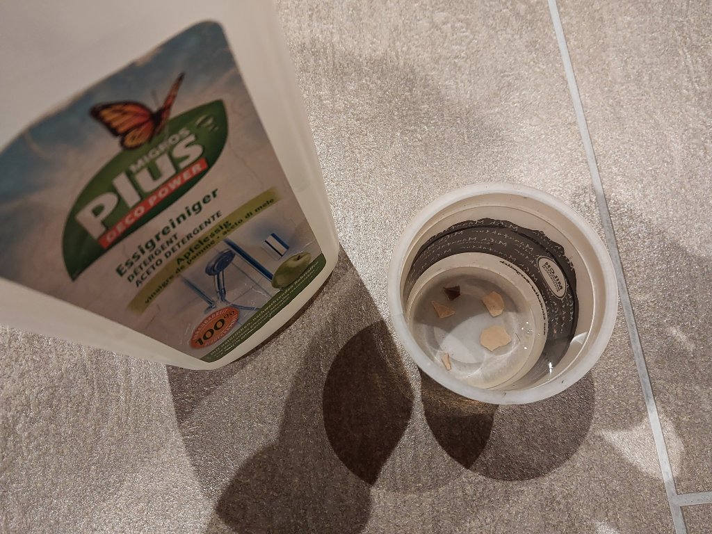

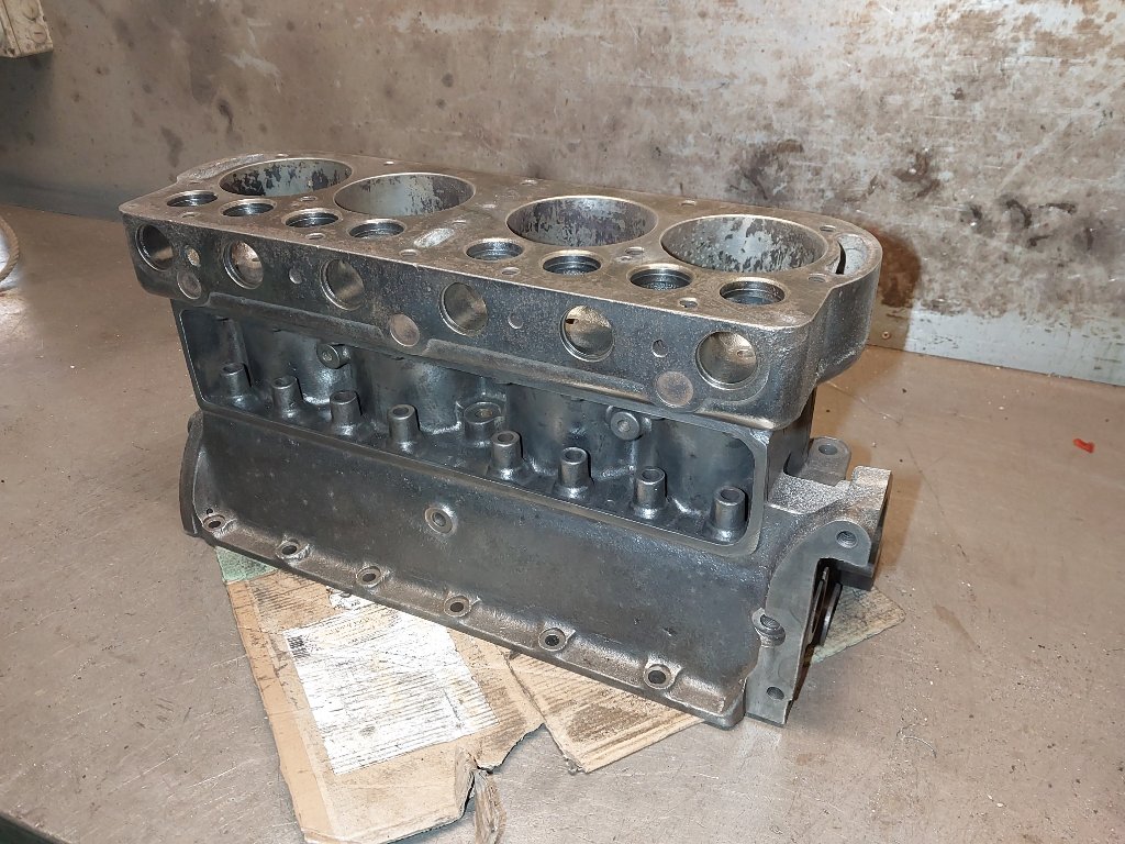

I just cleaned my block of rust. I used many different rotating wire brushes to do this. Took some time and the valve area was complex.

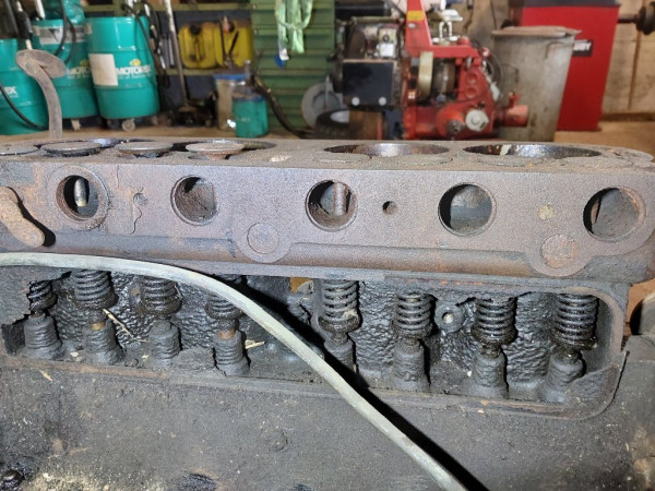

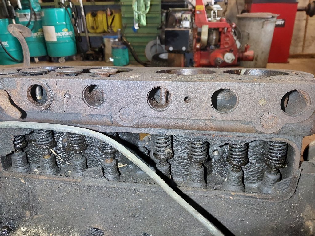

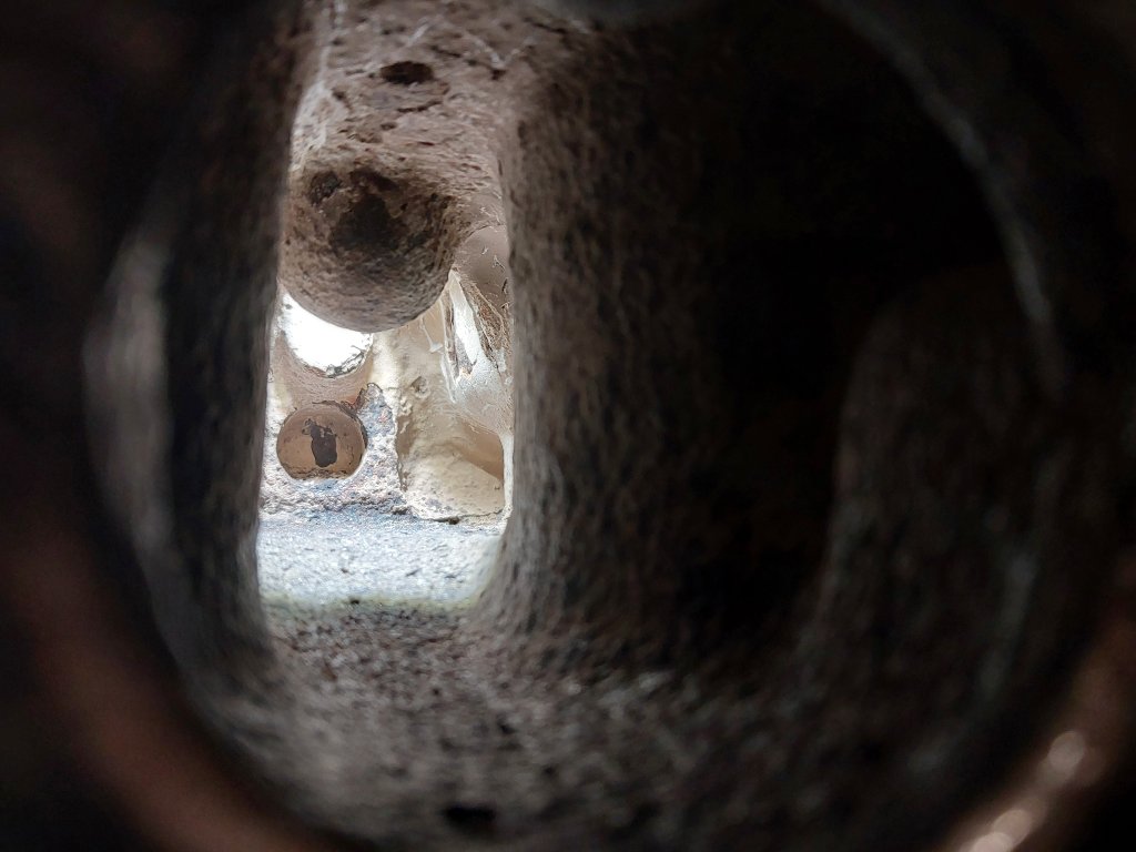

My problem now is the cooling water channels. Limescale has built up quite thickly (picture) and I still don't have a solution. Does anyone have an idea how to get rid of this?
greetings from Switzerland

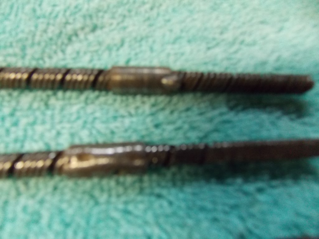

Topic author - Posts: 4638
Re: Engine block cleaning solution
Some have used an old speedometer cable chucked up in a cordless drill. The flexible cable helps in loosening the scale.

Craig Leach
- Posts: 2024
- First Name: craig
- Last Name: leach
- Location: Laveen Az
Hi Beat,
Nice job cleaning up that block. I use a Zep product ( calcium rust & lime remover ) very much like CLR but cheaper & better. I don't
know if they are available where you live. I set the block up in a cement mixing tub, make sure its level, put the water outlet on upside
down with apiece of hose on it and fill it up to almost the top. Try not to get it on the Babbitt. And let it set. then drain it ( you can use
it over again ) then flush well with clean water. A pressure washer helps if you have one. if not satisfied repeat. you can do the same
with the head but its harder to get level. There are stronger solutions but have found this to work good. The speedo cable idea will help.
I once used it on a skinny block Chevy to clean out the EGR port while on the engine. Speedo cable is not very easy to find now days if
I find any good cable I save it to make speedo cables out of.
Craig.

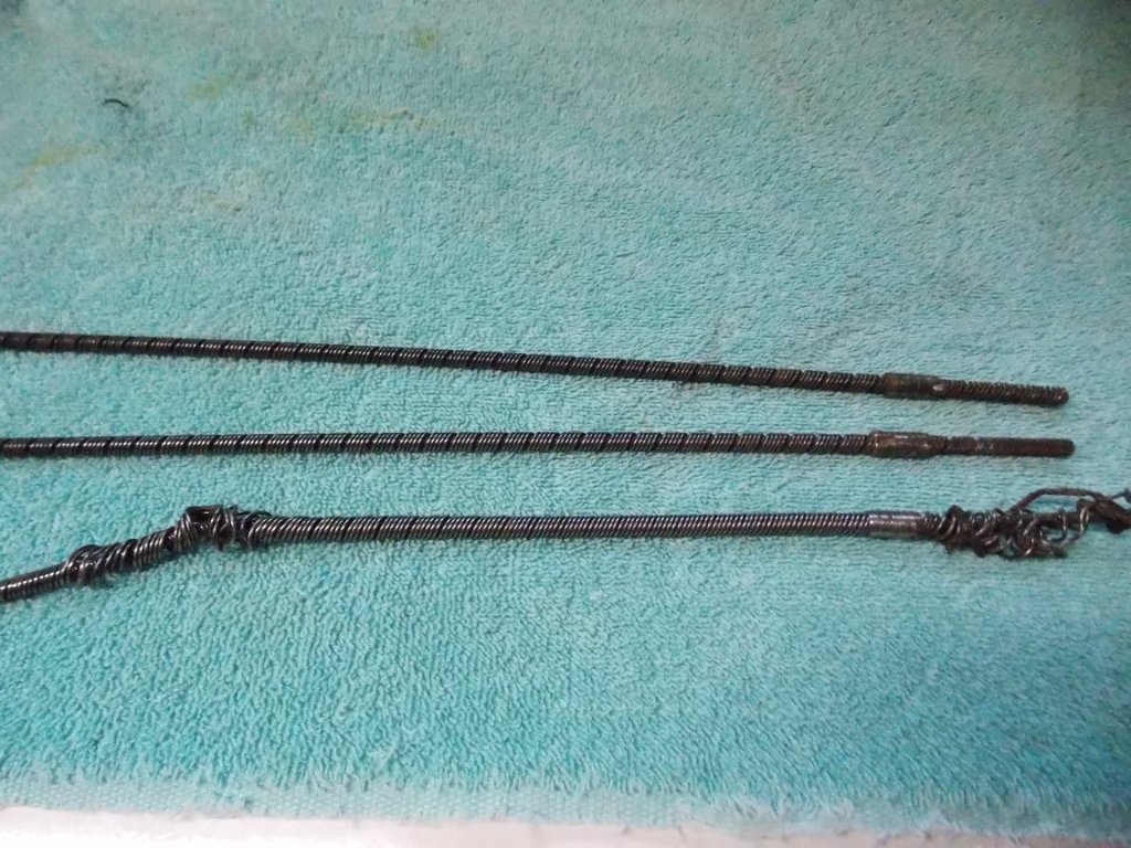

TFan
- Posts: 411
- First Name: Jim
- Last Name: Riedy
- Location: Sandusky,Ohio
Look for an old junk weed wacker and get the cable out from it. I got three pieces out of one cable cut them with a grinding wheel or a Dremel type tool, I put a piece of tubing about 1/4'' inch long over the cable about 2 inches back from the tip and staked it in place then I splayed out the end of the cable. When chucked in a drill this makes an excellent rotary wire brush. Jim

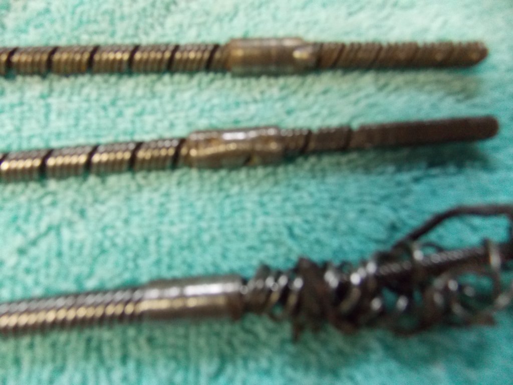

TFan
- Posts: 411
- First Name: Jim
- Last Name: Riedy
I was wrong about staking the tube piece I actually put a little weld to it. Here are some pics. The one is quite well used. the ones that aren't splayed are good for getting into the smaller openings on the head and block. Jim
Hi
Thank you for all the good advice.
I've tried different wire ropes. But the lime is very hard and I don't stand a chance with that alone. Motor has stood still for about 70 years).
As an experiment, I also placed some chunks of lime in phosphoric acid. Lime was completely dissolved. But I see that would damage the casting. So it's out of the question.
I see I can't buy CLR from us. It doesn't look any better with Zep products.
I'm currently trying my wife's vinegar cleaner (apple cider vinegar). Put in some chunks of lime from the engine. Let's see how it looks until tomorrow.
