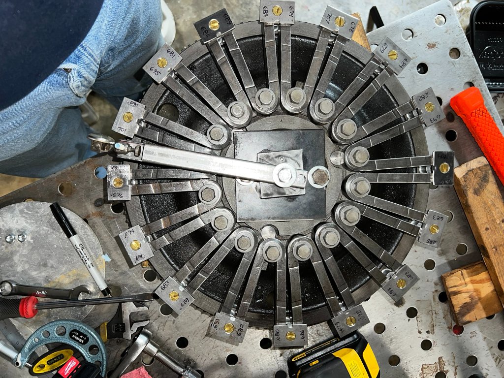

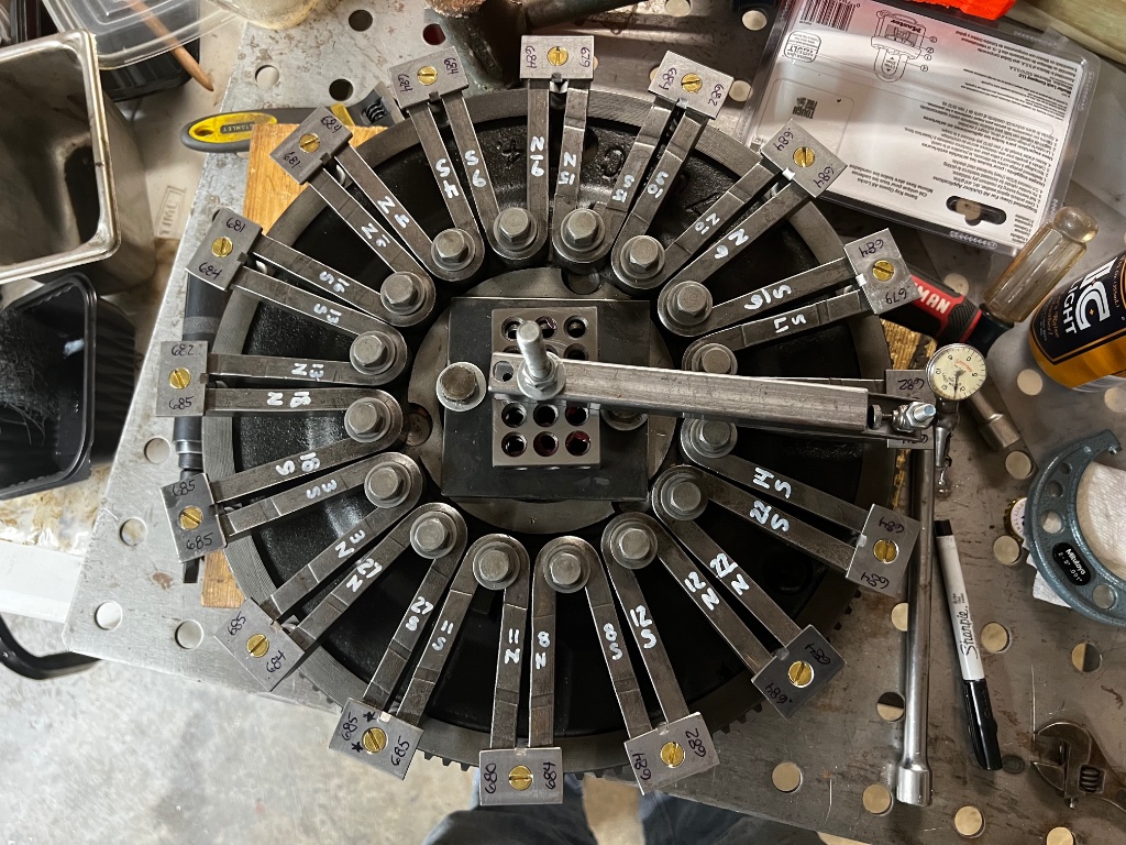

I've been reading the tons of posts on the forum about setting the brass screws for the magnet retainer plates. Folks discuss having the plates all in the same general plane and within a certain tolerance of each other in that plane. I've seen where folks say not to tap down the plates to adjust heights because of killing the magnetism of the magnets.
With mine, I have all new retaining plates, screws, and spools. The magnets were recharged.

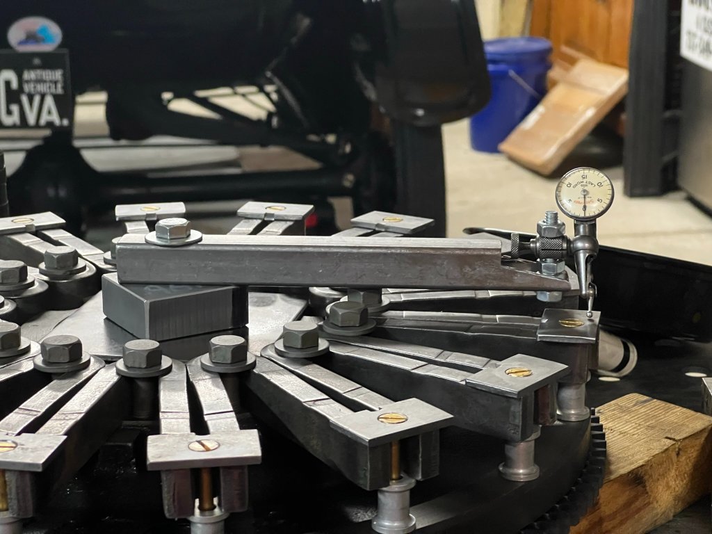

I made a rig to see whether the plates are at about the same height
But when I ran the dial indicator over the pieces, I was surprised that there was a 'slope' across the plates.
I'm guessing this is due to the magnet thicknesses. This can be quite the difference in height too. I decided to take some time and went around the set of plates and measured the height from the back side of the ring gear to the top of the plates (on both sides) and found that these have a big difference in some places (or what I feel is a big difference)
Is this something I should be worried about and if so, how do I fix it? I tried sanding/grinding off one side of a plate for S&G. Is that a bad thing to do?

I measure the thickness on the spools, magnets & keepers & try to mate for even height. Real shorts I might add a .010" shim washer.
Heights still need tweeking.
To adjust (lower) the height I use a big C clamp with a thick hardened washer as a spacer to protect the screw on the back side. I have broken a few aluminum thimbles. Goes with the territory I guess.
Yes, its a pain & time consuming job. I dont mind for my own motors. Yea fun.

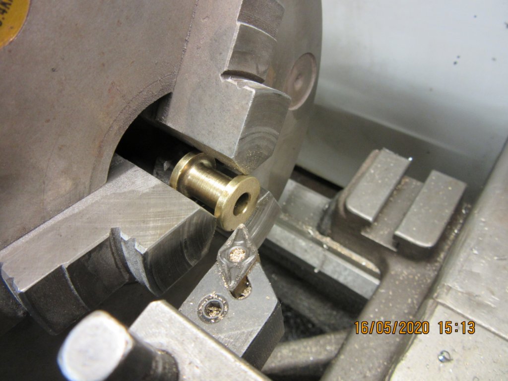

Max ,I turn down the Support Spools if they are to high .

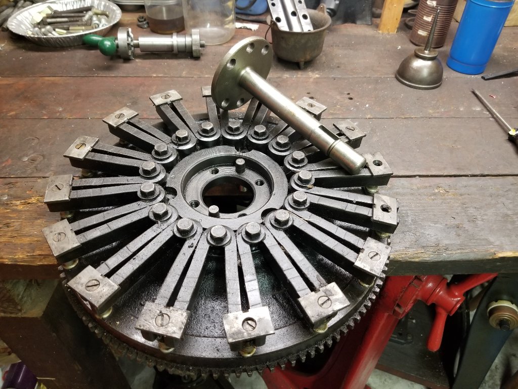

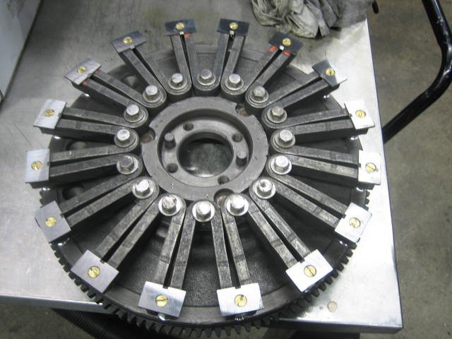

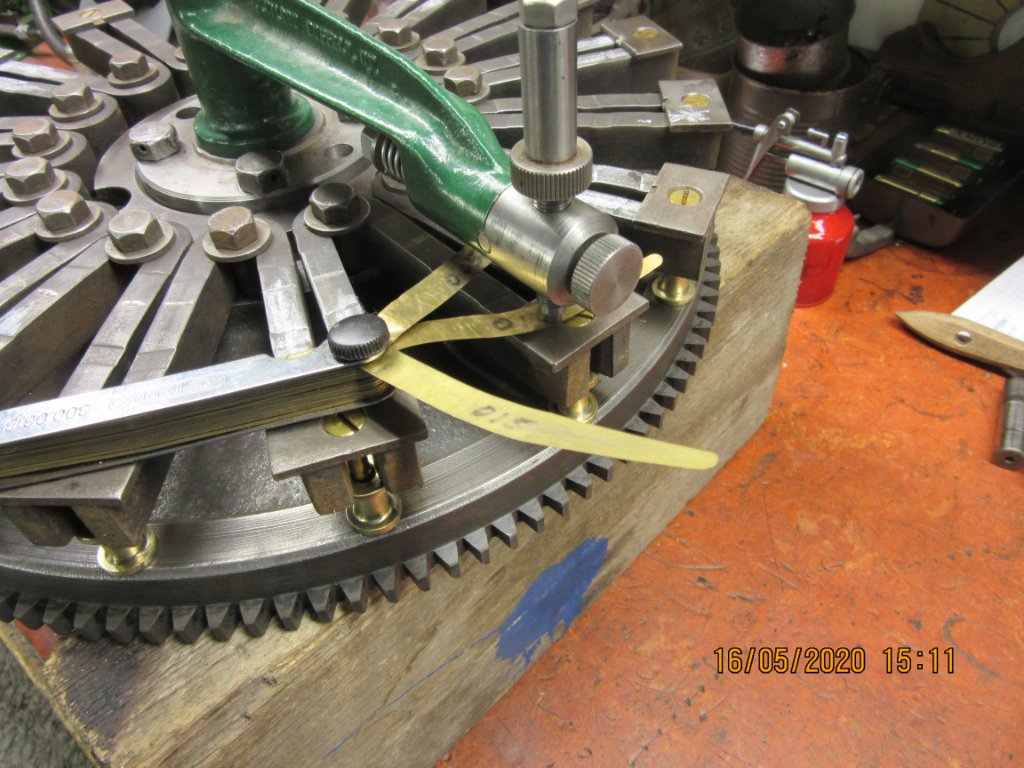

The gap between the plates and the field coil is supposed to be .025" - .040". I guess if everything is within that .015" spread it's good enough. But I prefer to match magnets for thickness and raise the low spots with shims under the spools to get as much of each plate as possible near .025".

Yes. I don't see anything in the encyclopedia about when they changed to aluminum, but they were brass at least until the mid-teens.

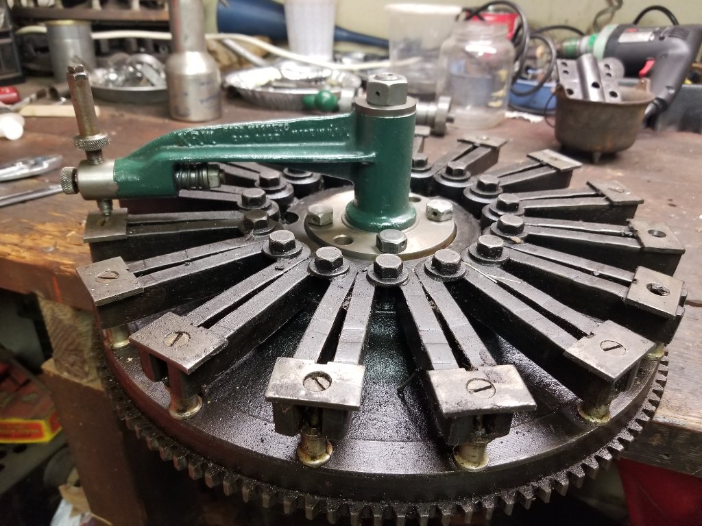

Okay, here’s an update. After not trusting my tool, I went through the process of measuring the total height from the back of the ring gear to the top of the retainer plate.
I’m pretty happy with where they are height wise, but managed to buy a KR Wilson tool on eBay. So I want to do the check with that.
Small problem though. When I try to put the KR Wilson tool in the opening of the fly wheel, it drops down on the pins in the fly wheel, but gets stuck about halfway down. I’m not sure whether I should expect an interference fit or whether you would normally take those pins out and then bolt it down.
Any thoughts?

KRW mag gage?? Seems to me I saw a Service Bulletin on that thing somewhere. Where did I put that thing? 🙄
Sean Butler
Posts: 180
First Name: Sean
Last Name: Butler
Re: Magnet Retainer Plate Level on Flywheel
Post by Sean Butler » Mon Jan 23, 2023 2:55 pm
I think I've got your back, Dan. While the Service Bulletin never instructs to use a tranny shaft as a spacer it does allude to it as seen in the highlighted text on the second page. Also, be sure to verify the trueness of the bottom of the flange on the KRW gauge. I have a repop gauge and the flange was off just a hair and needed a cleanup cut to get it true. Click on the photos and they should show larger.
Sean Butler
Huntington Beach, CA
Posts: 5421
Last Name: Hatch
Location: Alabama
Post by Dan Hatch » Mon Jan 23, 2023 3:18 pm
Read paragraph 2 of Service Bulletin.
“ Make sure transmission shaft is clean and free of nicks.”
They are expecting you to be doing this on complete transmission.
Also floating around somewhere are the instructions for setting the mag gage. Where did I put those?
Good thing my shop is just one room!!!😎

Good catch, Dan. The following link has Ron Patterson's info on calibrating the gauge:
http://www.mtfca.com/discus/messages/11 ... 1269355108

You dont have to have a complete transmission, but you do have to have a center shaft installed.

The trans shaft flange goes between the crankshaft flange and the flywheel. It is needed. I only put one engine transmission together and that is what I remember.

Thats basically what I said. The trans shaft has to be in place, but the rest of the transmission need not be.

I parted the flange off a worn shaft so that I do not have to work around that obstruction. It makes it easier to work on the flywheel on a bench.
