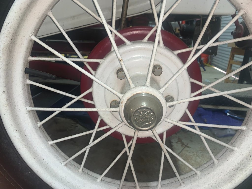

I have a 1927 Hot (as in fast) Speedster. It has original brakes. What are my options? I know that skinny tires on the two rear will not stop me like modern brakes, but lets have a fighting chance?
Here are my rear brakes, now

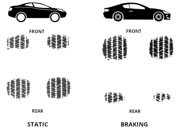

As noted brakes are only part of the problem. The real problem is with the tires size. The amount of contact a tire has with the road, footprint, is called contact patch. I couldn't find a calculator for Model T sized tires. Motorcycle tires are constructed differently. I think this image is somewhat self explanatory if you think of the width & PSI of the tires on your Model T and weight transfer when braking.

AMEN TO THAT!Scott_Conger wrote: ↑Mon Jan 23, 2023 12:44 pmand that, really, is the crux of the issueThe best (debatable) brakes are no better than your foot print dictates when locked up.
I know this is not the answer you were looking for, but it costs no money and requires no tools. You are halfway there because you are fully aware of the performance limitations of the Model T. That is good! The next step is one that some people cannot, or will not make. It is simply to drive the car as it was designed to be driven and NOT TO EXPECT it to perform beyond its inherent limitations. I am not against you or anyone putting disc brakes, seatbelts, or any modification to your own car. Even then, it is still safest to be fully aware of its limitations and modify your driving habits when driving a T. I hope you can appreciate and accept your T for the great car that it is, and be less concerned about what it isn't.
