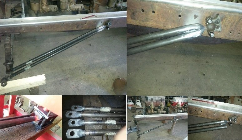

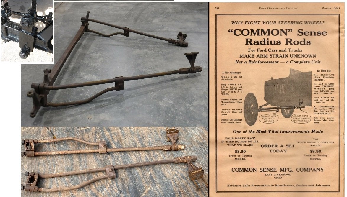

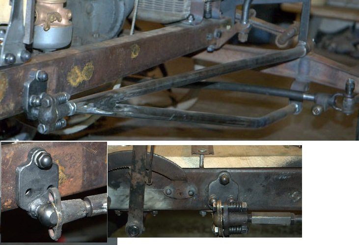

Split wishbones- I had collected ideas for several methods
I plan on using this set. But the interesting part are the brackets that clamp to the frame. Think its possible to make these. The rods can be fabricated a number of ways as well one of the many methods I included for the brackets that attach to the frame.
This is a set that Hank Lee made that I may need if the one above don't work out. The require the earlier 2 hole perch.
HANK s.jpg (83.5 KiB) Viewed 2194 times

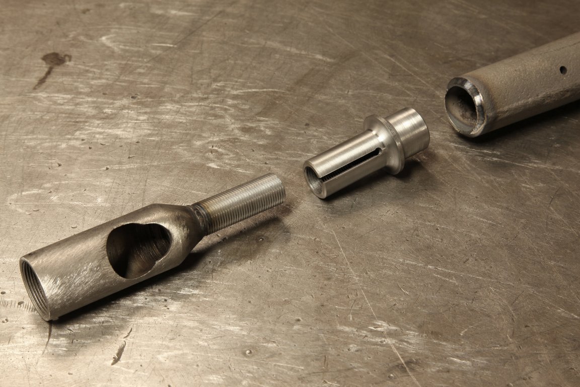

-This is an interesting design where the bracket on the frame is the wishbone cap from the pan and the rods fabricated and swedged into the ball end of a wishbone.

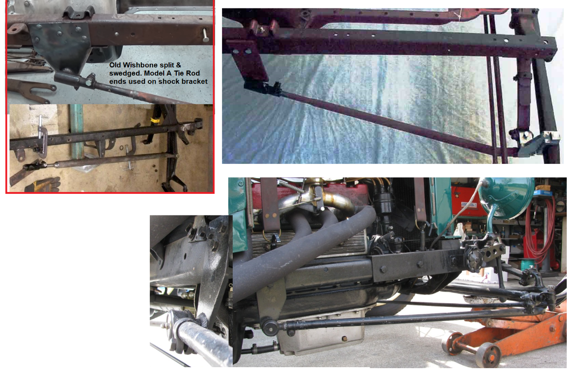

Other options , one using Model A parts

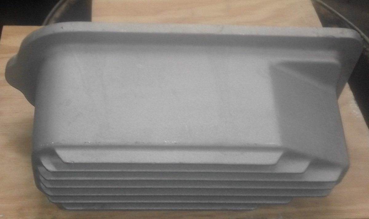

Dan McEachern
Posts: 1506
First Name: DAN
Last Name: MCEACHERN
Location: ALAMEDA,CA,USA
Re: Speedster Wishbone Questions.
Post by Dan McEachern » Tue Jan 24, 2023 3:30 am
Make your trade with Tim if you wish. If not, I have one casting on the shelf. It can be drilled for use on either a 3 or 4 dip pan, and it will clear a stock wishbone.
