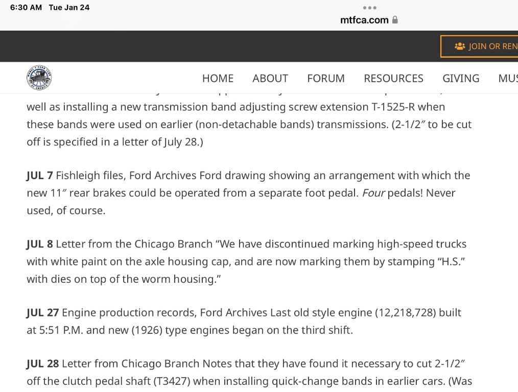

An excerpt from the 1925 Encyclopedia…..July 8. I am just wondering what the stamp looks like.

Mike, as I read that entry dated Jul 8, that is what the Chicago Branch was doing, not Ford production.
