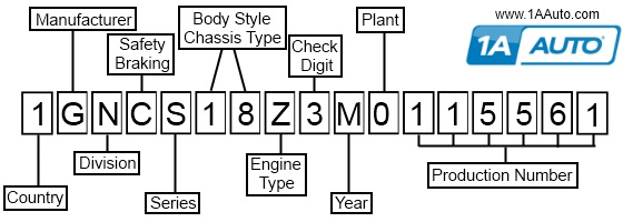

Given the scenario you presented the answer it all depends on State laws not what Ford and other manufacturers did in 1927Been Here Before wrote: ↑Sat Jan 28, 2023 1:33 pmHypothetical.......
Model T Fords are to be identified by the motor engine number. The early Ford manuals suggest that when a new block or motor is place in a car whose motor needs to be replaced, the mechanic use stencils to place the old motor number on the new motor block....
So, should a 1927 roadster be reconstructed, whose title and older registration you have in hand, and the original motor be replaced, say with a 455 GM motor, would it be proper to stamp the original 1927 motor number on the replacement 455. Would the car be identified as a 1927 Ford Model T?
Asking for a friend.
For example some states would consider that a Custom vehicle or Hot Rod if your State does inspections and requires you to get it re-titled. They may also have a registration tax on horsepower.
To begin with what what the Ford manual said to do was no always followed by dealers or subsequent owners or mechanics. The MTFCA Encyclopedia
clearly states that "The engine number was also the serial number of the car. Engines were numbered when they were completed, and for the most part went into a chassis within a day or so. However, some engines were assembled and numbered at branch assembly plants. Highland Park would ship a block of engine-number records to an assembly plant and these engines might be made weeks or months afterwards. Consequently, engine numbers can only be used to date the "engine" NOT the car. https://www.mtfca.com/encyclo/sernos.htm
Current Titles & registrations form have a VIN number field to uniquely Identify a specific vehicle globally
The VIN is a unique 17 position alphanumeric (letters & numbers) code for every on & off road vehicle. There are Global Standards to allow each manufacture to assign unique VIN numbers. When this occurred the filing system changed to just go by the number to get the details.
Unless you have a reference manual by manufacturer it is unlikely that you could decipher the VIN. The last six positions are used to uniquely id the similar combinations of values in the other portion of the VIN and is called a "production number". Not engine, body or frame number --
Back in the day each car manufacture assigned numbers to the vehicles to disguised each of their vehicles. When these cars were registered within a State it is likely they were filed by Manufacture and then by assigned number within that manufacturer. (There wasn't any national or global database to track stolen vehicles. The corresponding document then contained the detail about the vehicle and owner. So there wasn't and issue if a Ford & Dodge had the same assigned number because they were filed under the Manufactures name.
Today there is a conflict with some Model T owners who want to preserve the practice that Ford used back in the day and what their State & current system allows. Having said that. Understand that the purpose of a Title is to prove Ownership of a specific Vehicle not its pedigreed. There are many specific values on it that need to match.
Lastly, If you had a 2010 Buick and replaced the engine would you re-title it? No.
