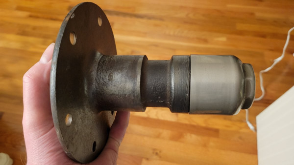

This is probably a trick that many of you know but I'm posting it because it was new to me and worked well. It may help someone else.
I acquired a replacement hub and couldn't get a hub cap to thread onto it.
The threads were a bit mangled.
One of the club members suggested I use a wheel puller, which I already had, as a thread chaser to clean up the threads. It took a little finagling and steady pressure to get the puller on the threads but once I got it started I was able to tighten it down.
Now hub caps thread on like normal...
It won't cut new threads but it cleaned these up with just a few minutes of effort.
One word of caution from another club member... If the hub thread chaser has any angle to it, it can damage the good threads. Another option would be to use a thread file. With one of those, you start from the back where the good threads are and they act as a guide to repair the bad threads on the outside end of the hub.

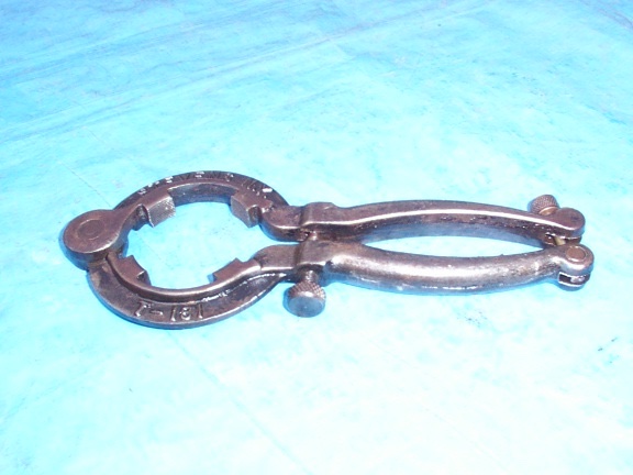

Stevens T-181
havnfun

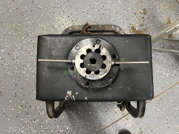

This tool works fantastic too!

The Stevens T-181 is the tool to have, but it's quite rare and likely to be expensive if you're lucky enough to find it. I hope to make my own version of it, but I haven't got around to it yet.

I used a hub puller and it worked fairly well. I had a hub and looking at it closer I used a wire brush and cleaned it really well. Really cleaning the threads well can help if you don’t a Stevens which lots of us don’t have.
I cringe how overtime Stevens tools were overlooked in old dealerships junk boxes and pitched out and wound up at junkyards. Oh well!!

Few years ago, Jack made some reproduction T181. They work very good. Don’t think he made but one run due to cost.

I am fortunate to have found the Stevens tool for the job. Until then, it was a natter of cleaning up the damaged thread with a thread file, chasing from good thread outwards to the damaged area, as previously posted. I would not advise using your wheel puller, until the thread is cleaned up and you are ready to check your work.

I like the one Joe pictured, does anyone know the die size needed for a hub? I bought one for the exhaust manifold and it worked well in that application. Best John

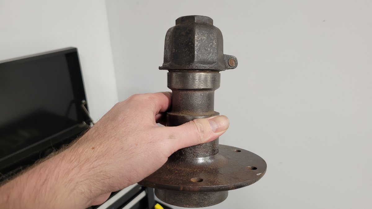

I have one of these for that job. http://www.modeltford.com/item/2815T.aspx

I bought one of those things years ago and cannot get it to thread onto a good, bad, or indifferent hub. Not sure why, but mine was and still is: useless
perhaps I bought the one dud in the batch
